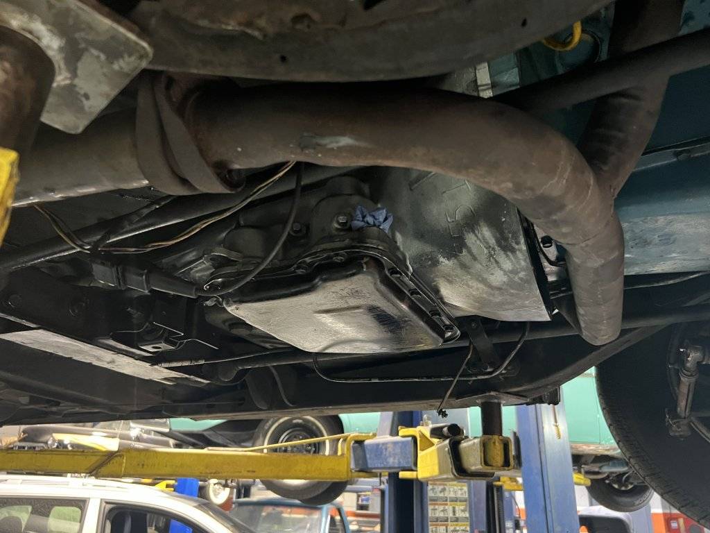

Tranny came in.
Just able to bolt it in at the end of the day. Should be connected up by tomorrow.

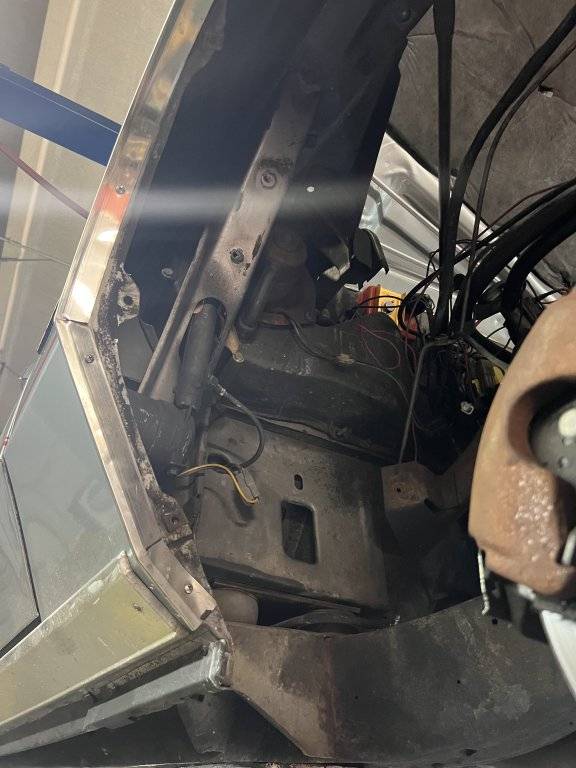

Fan ready to come out and be replaced. Also vacuum out the housing to get rid of dirt and leaves. Can you say…. **** load? I even had a Covid mask and a paper towel wrapped around the fan hub. Pretty sure it was killing the fan’s ability to blow.
Couldn’t help myself…..
It had to be done.
Now do the other one.

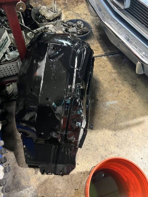

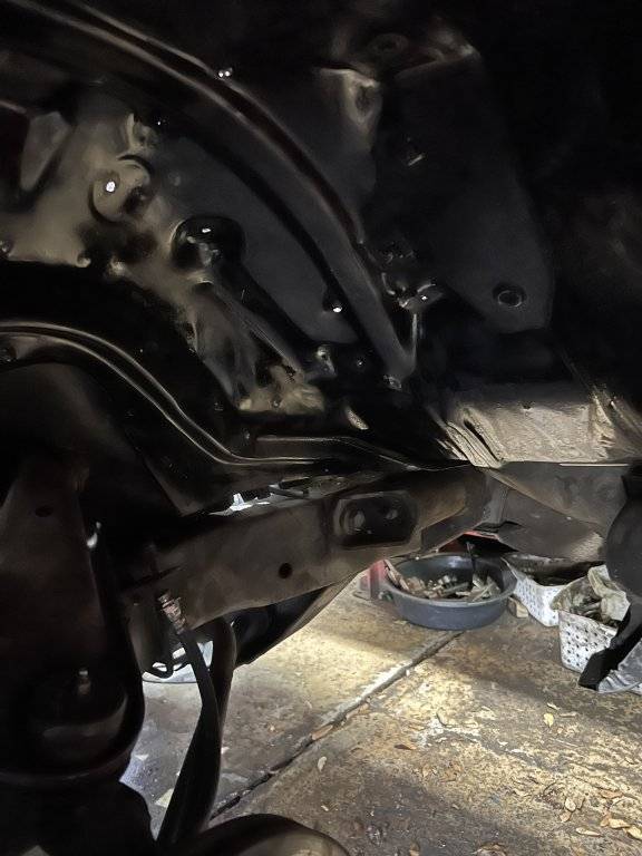

Lots of overspray from the rustproofing on the wheel inner fenders that I’ve been taking off a bit at a time.
After 46 years in the engine’s heat, it’s like concrete.
I spray wd40 on it and been removing it a bit at a time.
It was all over the outer fenders under the hood and radiator support and fire wall as well. Those ares mostly came off during the repaint. Was trying to save the paint as much as possible. Outer fenders were painted to their inner edges. Radiator support was cleaned. Firewall uupper part was cleaned. Lower areas of firewall still left to do.
It’ll look clean and stock when done.

A needle scaler knocks the hard under coating off quickly.

Drive shaft and new trans mount are in.
More to come.

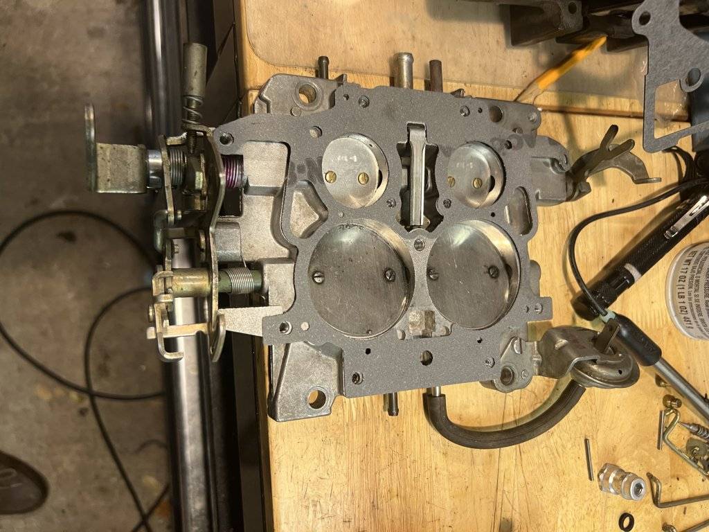

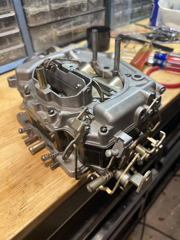

Update on the pull off Thermoquad for the road runner. Came together really well. The throttle shafts are tight and super smooth.
Even a lot of the original cad plating was there.
Screw heads were not all mangled and threads clean.
Wrapped it up in bubble wrap and Saran Wrap and will keep it as a spare until I need it. Original needs a new throttle plate but this was too good to just use it for parts.
My original is working well enough for now but is definitely leaking air… so….soon enough.
