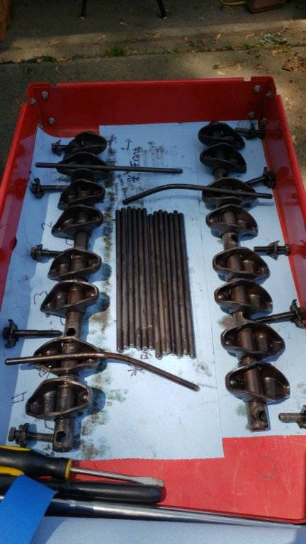

Bent Pushrod
You might consider straigtening up the bent push rod and reinstalling so you can run a compression check on the engine. That will most likely tell you if there are any bent valves.
This would also be a good time to check your timing chain as a bad chain will cause the type of damage to push rods that you have.

Dave, any ideas what the cylinder compression per cylinder should be?
Straighten the bent push rod (Mopar solid rods are tough), probably bent on backfire. May never happen again, see you at Carlisle.
If this is the HP 383 about 150 PSI (most 4 Barrels), the standard 383 more like 125 PSI (Most 2BBL). They should all be within 10 PSI of each other. If you have any bent valves, it will be Zero on that cylinder..

If that engine sat for a long time at some point, and was then started with a sticky valve, you could get a bent pushrod like that.
Maybe also if the lifter was collapsed, then the motor started and revved right away, it may have hammered that pushrod.
I was taught to go through and smack the valves loose with a mallet on an engine that sat a long time.
Can you push down on the lifter to see if it is collapsed?
As was suggested, try to clean the valve stem with something. Maybe if don't have a valve spring compressor, you can pop the rocker shaft off, and go through and hit the valves, see how that one compares to the others, determine if it was a previous problem, or if it's a currently stuck valve.

These guys all have good points. For my 2-cents.... buy one lifter (smear with cam break in paste), one pushrod & one rocker arm. Install them. I like the idea of turning the motor over with a breaker bar & watching that valve. If all seems OK, fire it up. IF you timing chain is wearing out, you can usually see this by severely fluctuating timing with your timing light (it bounces all around). If it does that, put in a new timing chain. The posts above give good advice, but I'd rather not pull off a head either personally.

Putting a new lifter on a well worn cam will usually make the cam lobe go flat. I would do this only as a last result if the original lifter was dead. Figure on putting a camshaft in the car in about 20k or less.
While the breaker bar is on the is on the crank pulley, remove the distributor cap and line up the timing mark to TDC. Now rotate the crank shaft back and forth, it you get 12-15 degrees of free play before the distributor starts to move, the chain is out of spec and needs to be replaced. If you get 20 degrees or more free play, the chain is at the point of failure.

Also look for grooves in the rocker shaft, a good indication of well worn rockers and a possible source of your bent push rod.

Going through this same thing on the 73T&C right now. 2 bent rods and one just hanging out (lost contact with rocker arm). The spacers were worn out, causing a lot of slop at cylinders that had the bent rods. After a trip to Mancini Racing (stock parts....in stock!), the spacers, rocker arms and push rods going in this afternoon.
