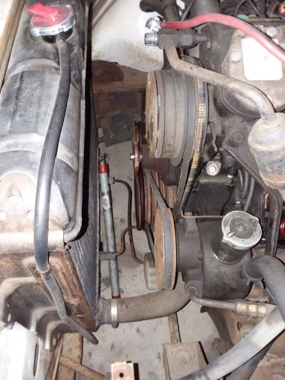

Any idea what this is? Found it laying in the power steering pump bracket. Figure I dropped it taking the A/C pump off, just not sure what it was for? Can't figure it out for the life of me.
What you appear to have is a port blocker off the RV2 compressor. When replacement units are shipped from the factory, they put plates over the intake and discharge ports to keep contaminants out. You car probably had the compressor replaced at some point and the tech dropped the port cover and forgot about it. If you are really curious, you can take a digital caliper and see if the bolt holes match one of the ports. Looks like an intake/suction port blocker to me.
Dave
Dave
Thanks Dave. That is exactly what it is. I measured it with my digital calipers and it is exactly the same size. Makes sense why the tech would have dropped it right there down in the power steering pump pulley. I appreciate the help. I was very careful and accounted for everything when I pulled the top end apart and couldn't figure out where that had originated from.
