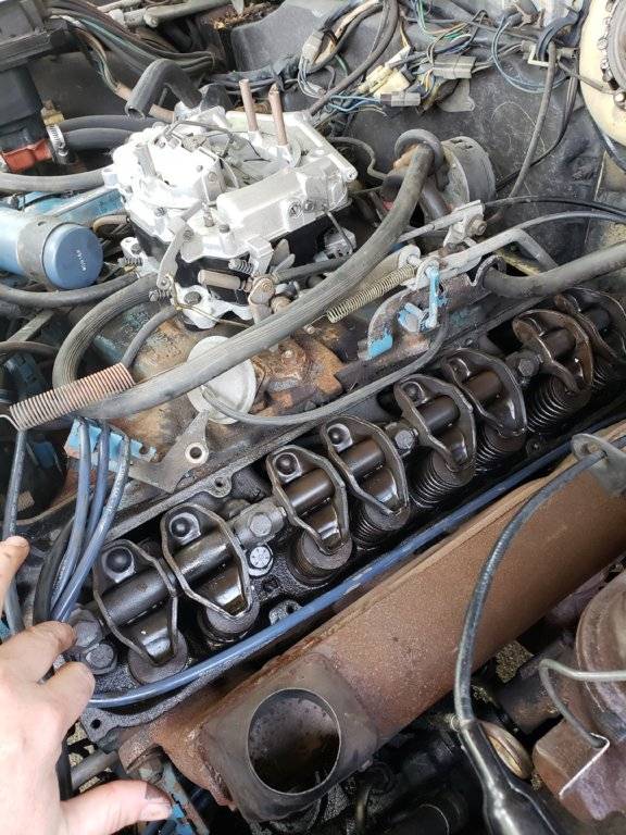

On each rocker shaft there are 4 spacers, 1 between each pair of rocker arms. Mine were worn pretty well, so the rocker arms had way more side to side play than they should have had. I will try to take some pics of the new vs old tomorrow. Got the driver's side done. Tomorrow morning will do passenger. Then I'll try turning it by hand to see how the valves behave - good suggestion! (Forgot who mentioned that idea)

Tonight I took my time and pulled the fan and 2 piece fan shroud off to get it out of my way to turn the crank.
So, then I pulled the rocker arm shaft and straightened out the bent pushrod in the vice as many on here mentioned to do. It took some doing to get it fairly straight but I got it. Then put everything back together and tried turning the engine by hand. So far so good! I ran through the rocker arms many times through many cycles and that rocker arm moved and the valve moved.

So, I don't know where to go after this. If the compression test is good I guess I can chalk it up to some bad gas and the engine sitting for awhile causing a stuck valve (3rd pushrod from the front on the drivers side-think it's cylinder 3). That push rod could have been bent for awhile, since I never did more then start the car and let it idle.

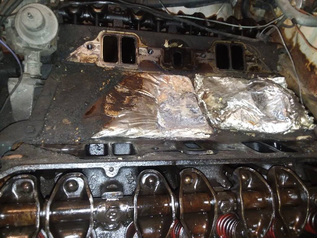

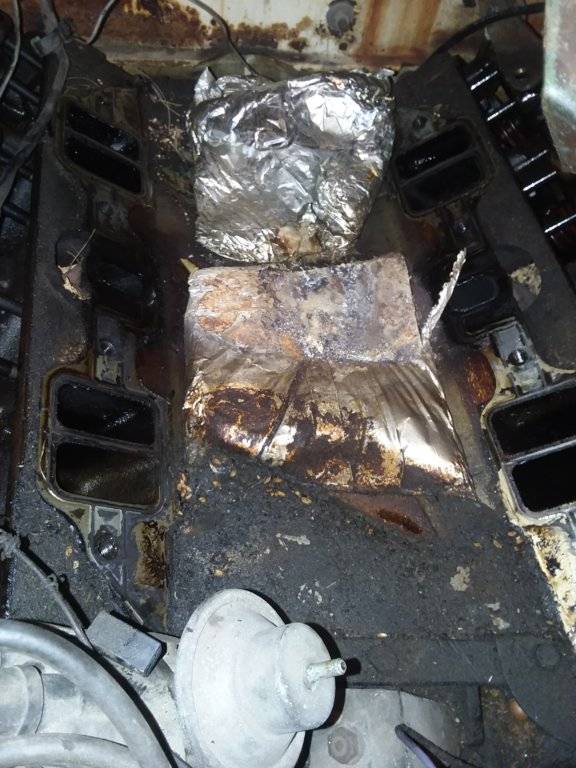

You'll never believe what I found on the back of the engine. Between the intake and the valley pan in the back somebody took household insulation 2x2 square wrapped it in aluminum foil and stuffed it in under the intake to fill the gap.
Here's the question, WHY?
Only possible reasoning I can figure is to keep animals from nesting? Not sure if any mechanical purpose fits.
Anyways I might pull the intake now just to investigate then change the valley pan. I just so happen to have a new one.
It'll give me a chance to inspect the motor more anyway.

Chrysler did that to help quiet the valvetrain noise emanating from the engine since the valley of the engine is covered only with a thin metal gasket/cover, rather than other arrangements in other engines where there is mostly cast iron to help quell the noise and no valley pan. This was done on B engines but not on LA engines, for example, since those cast iron intakes completely cover the valley.

Makes perfect sense. So this is a virgin engine? Never been apart or someone would not have put that insulation back? Just never seen this before on my other cars. Maybe not strange but new to me.

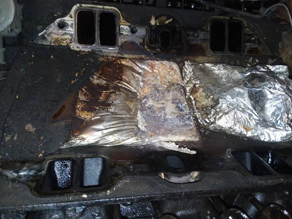

Here is what it looks like after I pulled the intake tonight. Question is, should this go back? I'm guessing not a big deal and leave it off. It's not in perfect shape.
The insulation is there mostly for noise suppression, no big deal if you leave it out. Take care with debris falling into your intake ports as that can cause you a lot of grief.
Dave

Ok, I am not going to put this crap back in then. It is not in the best of shape and looks 50+ years old.
