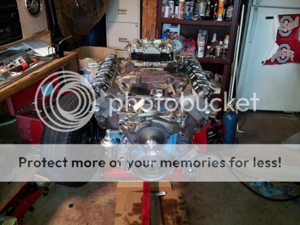

Took a break from the bodywork on the car. The new rocker arms came in, and decided to get the motor back together.

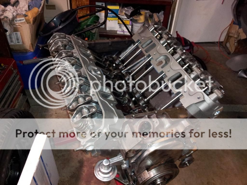

The rocker assemblies went great, then came the intake.. Tried to use the valley pan, and all 4 gaskets supplied with it. Everything looked good before bolting up. Once the intake was on, and bolts in, it went south. Had one of the bolts strip out in the head, and DID NOT want to come out. Everytime I turned it it was pushing little metal fragments into the engine! Sum *****!
After an hour finally got it out. I was talking with Stan about it over PM's. Luckily I think the threads in the head will be fine. It boogered up the first couple, but the rest further down look fine. I took a clean bolt with a stack of washers to act as the intake, and torqued it down to factory spec of 50ft ibs, and seemed fine.
After that removed the rocker assemblies, pushrods, and lifter done the night before, and cleaned all the metal out of the engine. Think I'm alright, got my fingers crossed!! Everythings back together now. Should have a package from Summit showing up today with new ARP intake bolts, valley pan, and a few other things. I think I'm gonna have to go with just the valley pan, and some sealer around the ports.
Well there went that chance... Had the girlfriend helping me and she dropped one of the small rail bolts right down the distributor hole.
Now everything has to come back apart. :BangHead: :argue: :crybaby2:

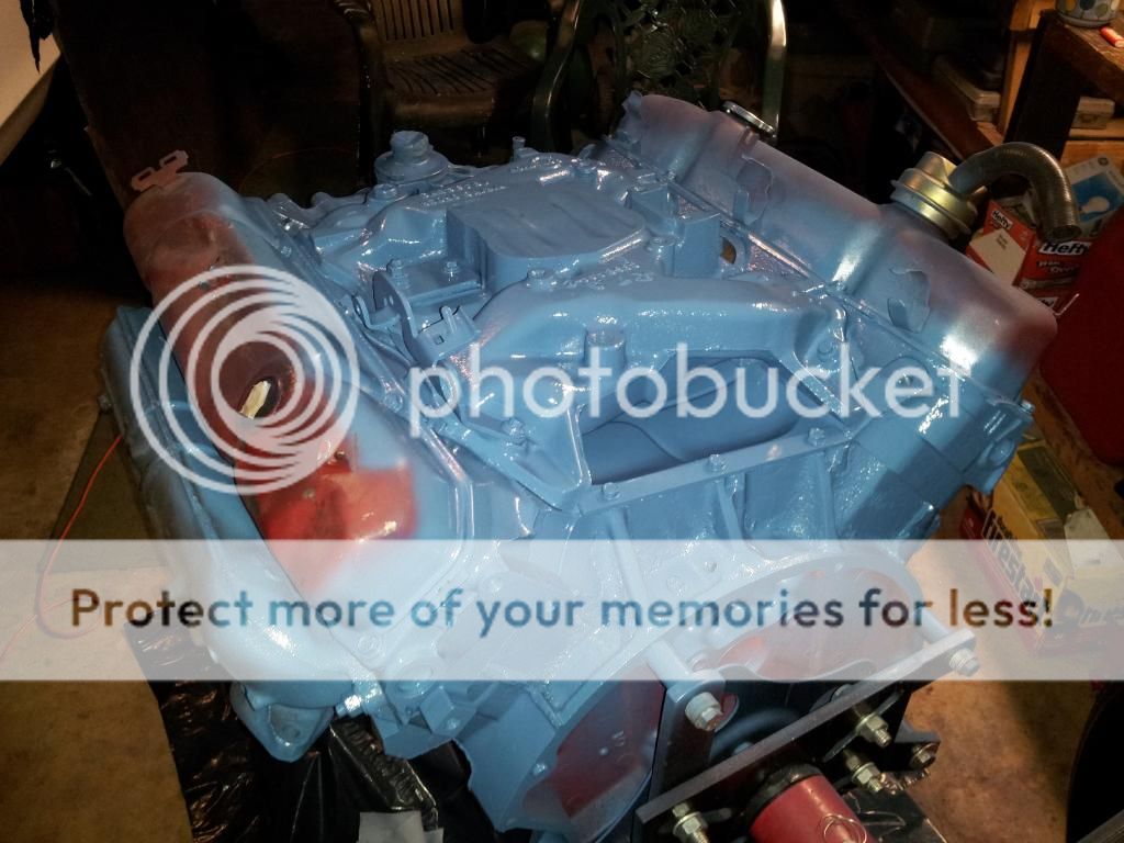

Finally got the bolt out! New gaskets installed, as well as the intake.
Ended up going with the MP spray paint for the $$, and ease of the job. Sprayed the timing cover, and backside of the water pump housing, before installing the new water pump, and thermostat. Hope to clean everything good tomarrow one more time, before laying down the paint.

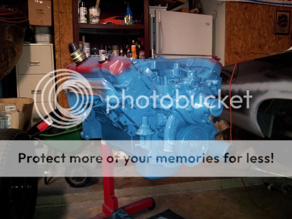

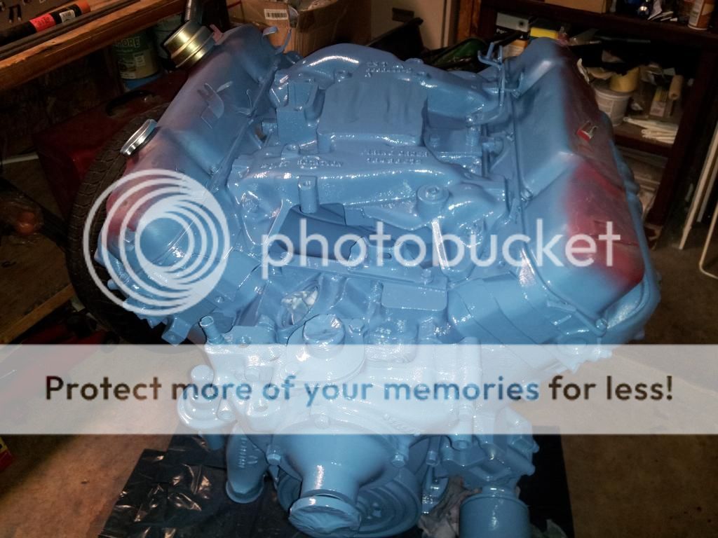

:eek:s_dancing2: Paint is on! Spent the afternoon doing one last clean up, and prep for paint. Went over it with a can of engine degreaser, then wiped her down with some lacquer thinner. I was a bit unsure of the paint at first, as it seemed pretty flat. But the gloss really seems to be coming out as she dries! Gonna wait a few days for it to dry, before removing the masking tape, valve covers, and such..
Just wish the car was ready for her! Forgot how massive it really is, once all the parts were back on!
