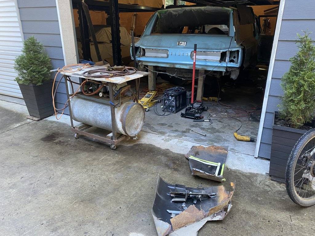

I think i've joined a club of a chosen few. I might be the only person ever to extract the inner quarter from a c body wagon. If anyone else has, I've never seen evidence for it.
Gonna start test fitting the wheelhouse now. There's a spot of rust under the tailgate I'm not sure how to cleanly repair where three panels converge. No way i'm getting them unbuttoned properly even if they weren't the only thing holding this car together.
Might have to be dirty with it, don't know.

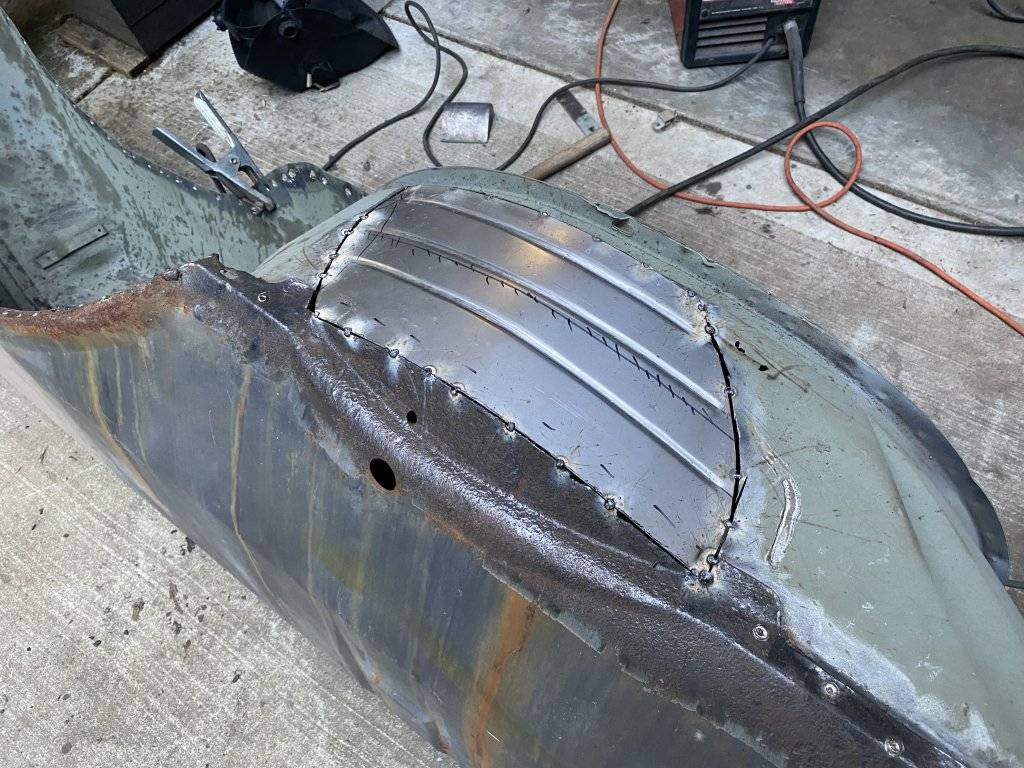

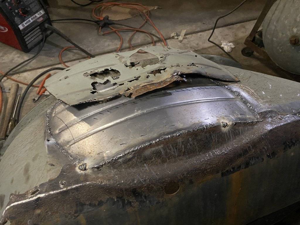

Patched the bottom of the tub. Deleted the body plug. I suspect those only exist to drain the zinc during the galvanizing dip at the factory and I don't expect to need that anytime soon.
Still more work to do but that's a tomorrow problem.
Still going. Mostly patching patching patching. I kept finding more and more issues to fix in the tub.

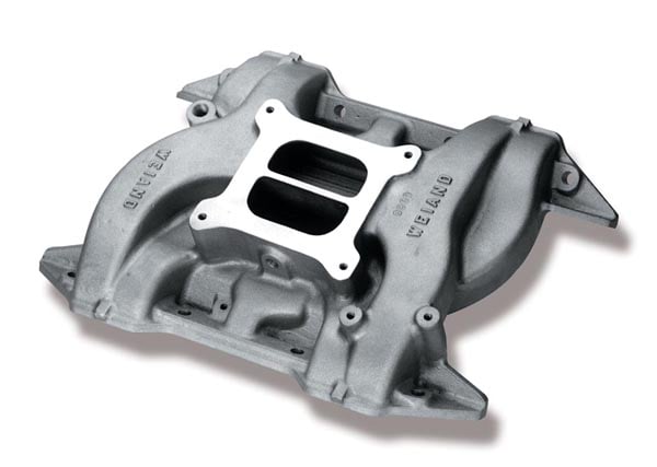

Anybody ever try the reproduction Weiand dual plane? I like the 60's look but I don't know how it stacks up to a newer one. Can't be worse than the smallport iron unit it's got on there now i suppose.

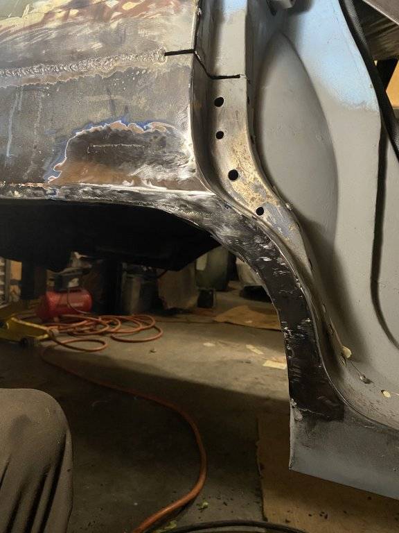

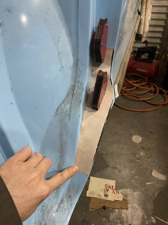

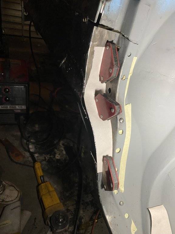

Fabbed up the other part. Took a template from the left side and boy howdy look how much thicker the factory fury panel is.
I guess no matter how bad my work is, it won't be worse than how it was. And I've been around this car 28 years and never noticed before now. She'll never win a concourse but it'll be good enough.
Ran out of wire halfway through, I'll finish it up tomorrow.

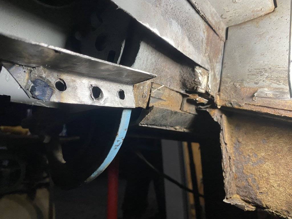

I keep intending to get the tub in but more and more problems keep revealing themselves. This corner isn't too bad but almost every join needs repairing. Made it all up and welded it in but it took all day.

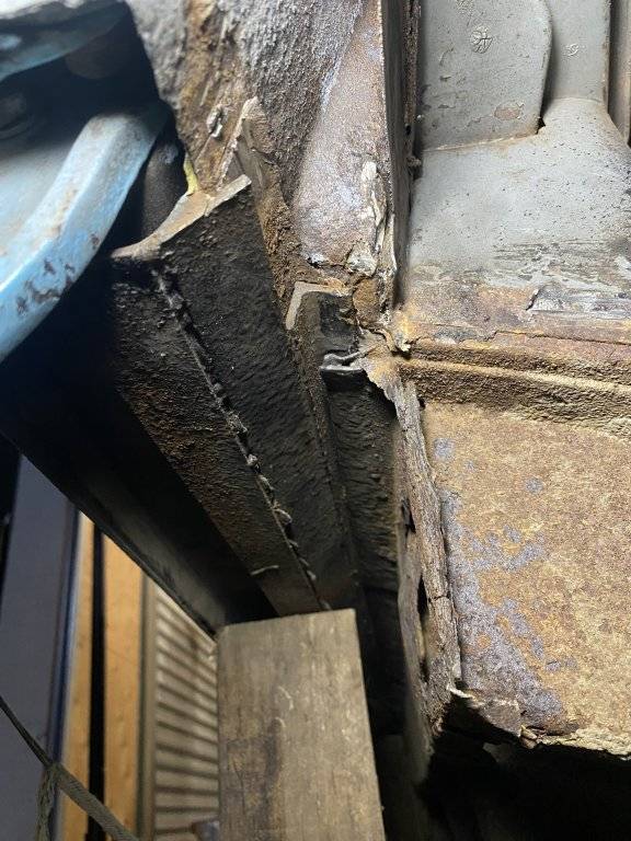

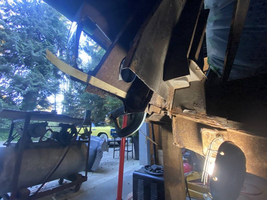

So order of operations thing here, it looks like the best call is to put the tail light filler panel in before the tub as it ties into the inside of the tailgate sill.
However, the original panel is underneath two pieces of angle iron. The upper one is part of the floor and coming out, so ok. The outer one is the bottom of the tailgate sill, is probably the most vital structural element of the tail currently and both are currently holding up the car.
Not sure what to do here. Any suggestions?

Maybe someone will chime in, but you are certainly in uncharted territories here my friend. With the 69-73 wagons once rust gets up behind the tail lights into these difficult to access areas. It's usually game over.
You've come this far, I'm confident you'll find a way to get this handled too.
Maybe fab up some sort of cage structure so you can hang it from above...can't really picture what's going on.
It is under a lift. I could ratchet strap the roof rack across the lift to take the weight while i remove the angle iron. The actual weight is borne by the rockers, the jacks are just there to keep everything square.
Terrible idea but all too plausible...
Also looking at the donor that angle iron is not factory but replacing a stamping doing the same thing. Based on the other repairs, one wonders what horrors lurk in there also.
This ride just keeps on giving.
Rust that is. Never ending rust.
My suggestion was to tie it up to the rack but you already called that idea out.
If you strap it, make sure you double strap it with some extra's for safety.
