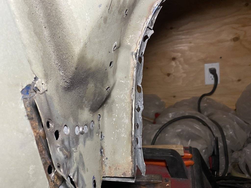

Do it right, and then just like it's done for adding rust treatments, drill some small holes from behind/underneath and spray in FF or Crown stuff.
Yeah that's what everyone's telling me.

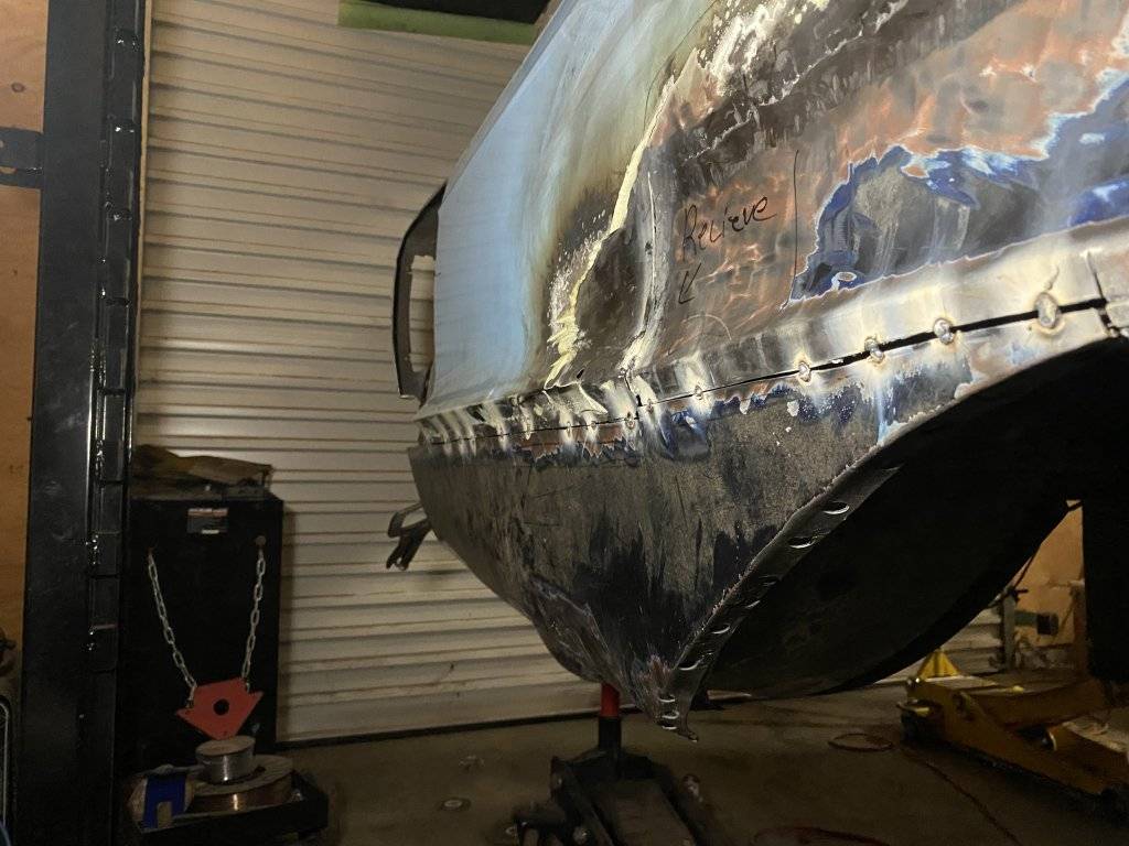

Already using zinc weld through. I'll see if I can paint up to 1" surrounding the weld seam without burning up. Might fill this cavity with wax if it doesnt' weigh too much.

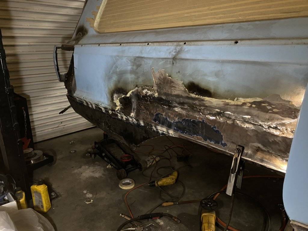

Got the tub fitting much better. Though strangely the top door jam to tub brace only partially lines up, and I'm not sure why. Though every other mating surface lines up exactly, and i drilled some pilot/screw holes to ensure it can go back in exactly where I want it.
Frankly I'm pretty confident I can get the lower quarter on to a high degree of accuracy now, i'm still thinking it's the way to go, for reasons of rust protection above all. I do not ever want to bust all this open again.
Though unfortunately it seems I welded the door jam in about 1/8" too far forward. You can see how tight the wheel arch flange is, and there's a gap between the surface that mates to the inside of the door jam, even though every other mating surface lines up exactly. Might've been welding warpage as this was before i got my cooler lincoln welder. Can't close the door to test panel gap either. Oops. Though I think I'll move the flange on the tub forward a little to compensate, I made it new as well, might've just messed up in fitting it. Easy fix.

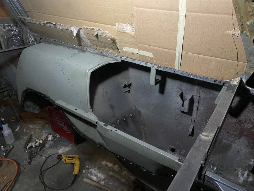

Tacked the quarter together with everything properly located. Tomorrow I'll drop the tub and do it all up final and then do the prep and paint for final install.
Feels like i've been about to install the tub for a while now, but it seems we're finally ready. Hopefully the floor just goes straight in, I don't see any heavy fabbing for that, outside of the LR sill panel and repairing the LH tub.

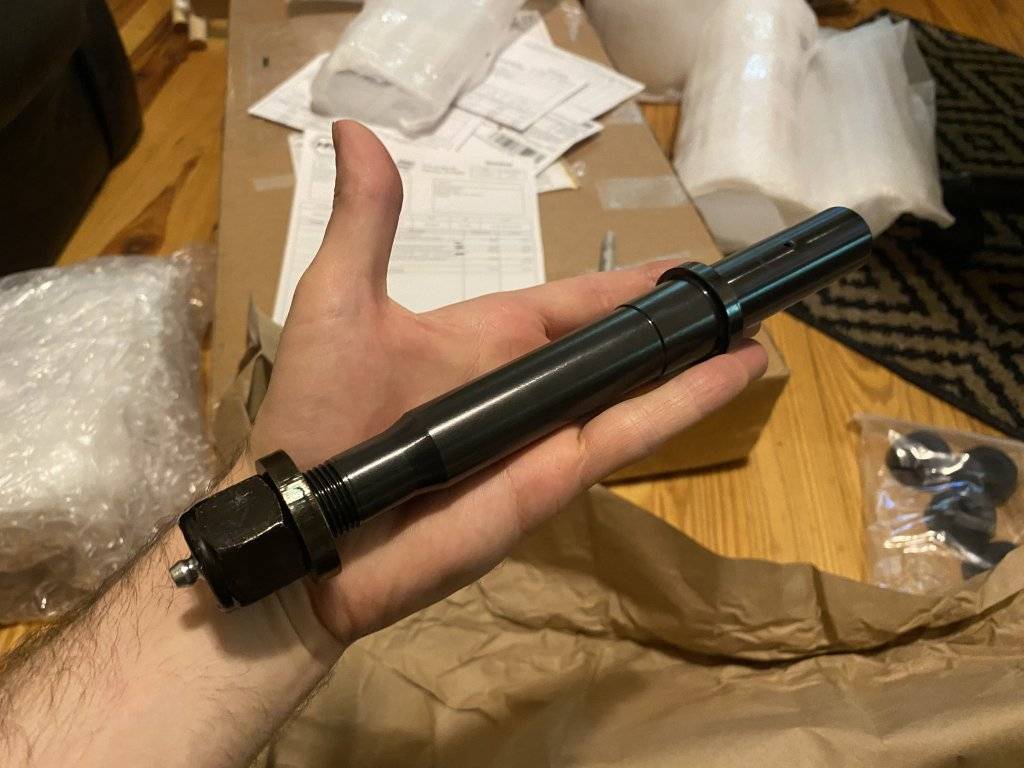

All the firm feel junk showed up finally. Super nice stuff, can't wait to slam it on.

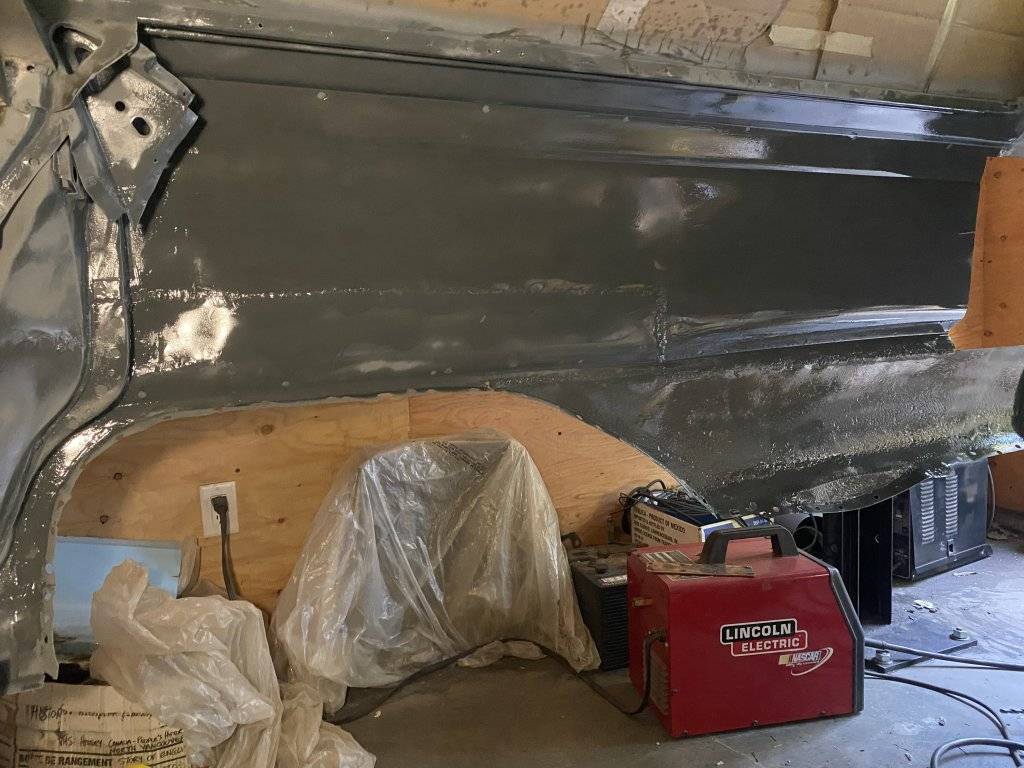

Man paint goes quick. Every pass on the quarter panel was a whole can basically.
Hit it with 2 coats of zinc primer, all the weld seams with another 2 coats of zinc spray, and then two coats of regular primer with the seams taped over.
Couple coats of silver tomorrow, then truck bedliner to seal it up.
Then, onto the tub.

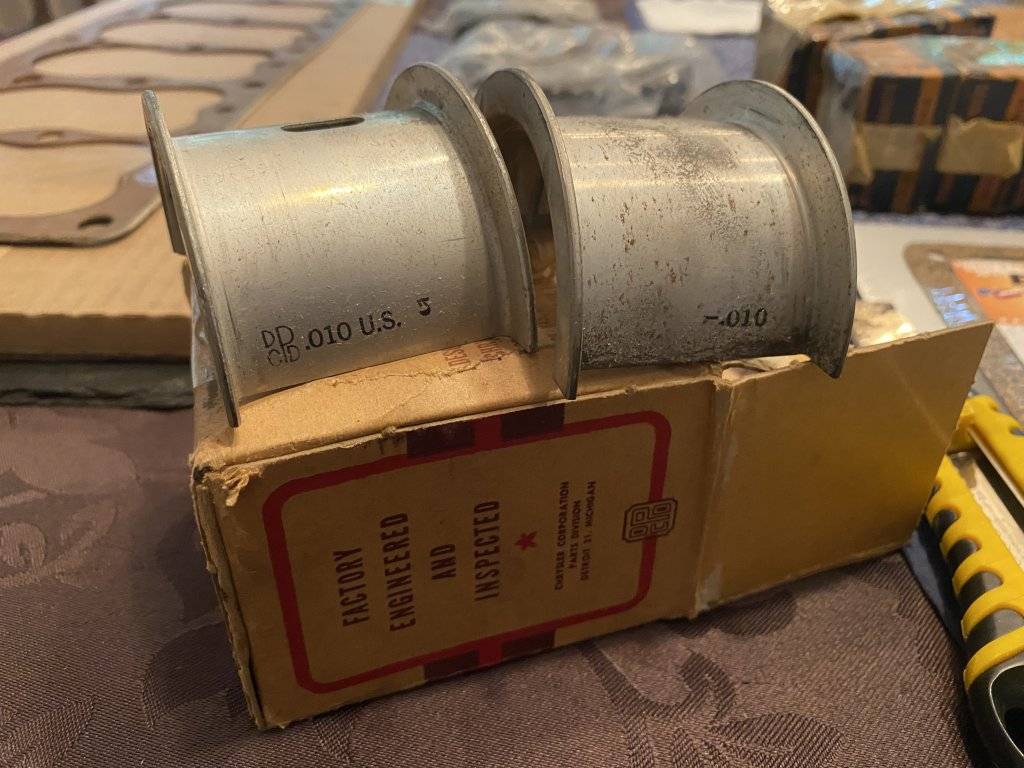

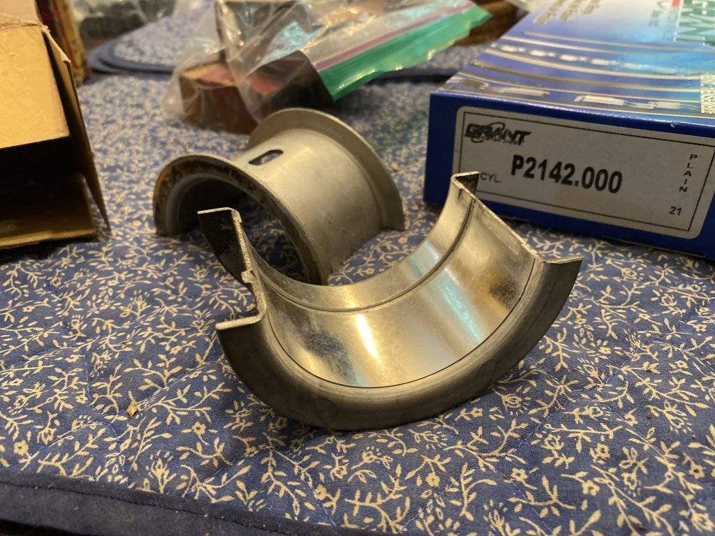

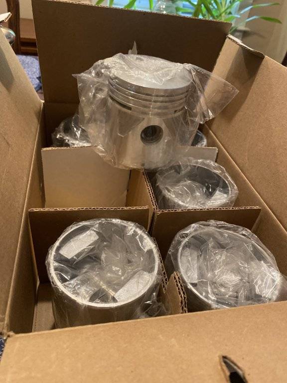

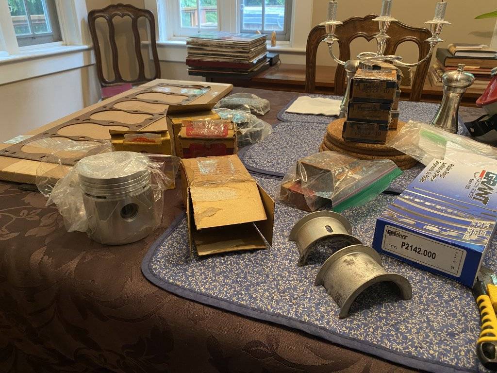

The last of my rebuild stuff for my 35 DeSoto Airflow finally came in. I've been tracking down this stuff for 2 years now. This is most likely the last set of .010 mains and rods for a 34-35 Chrysler 6.

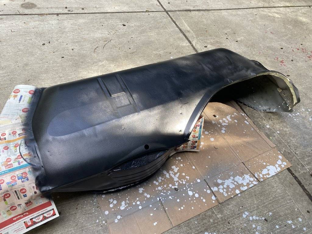

More tub progress. Been rained out the last few days, next week is looking like rain too. Hopefully I can finish rattlecaning this thing before the rains start.
During monsoon season 2, I'm thinking I'll start fabbing the new footwell. I figure the best way to do it is pie cuts on a strip of metal already bent to the correct radius. I can also start blasting apart the LR corner too, as I need to fab most of it before the new floor goes in.
Not sure if i want to hit the spare wheel zone with the bedliner or not. Factory correct would be the silver, but grandpa had it painted black when the bodywork was done. Not sure.

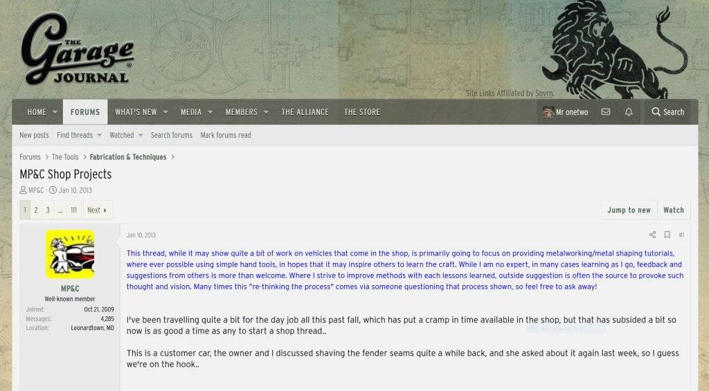

Stev is doing such good work. If this sort of thing is your definition of **** (like it is for me) :icon_fU:... then may I make a suggestion. The Garage Journal has a member who is a professional bodyman.He has a shop in Maryland with a thread that is 11 years old with over 4400 posts filled with this stuff, but on another level all together. Not the stupid stuff on TV...real nuts and bolts stuff. Free to join and well worth it. Admins...if this is an inappropriate post then do what you will.I just thought it is connected very well to this thread. He also has an unbelievable YouTube channel https://www.youtube.com/@mccartneypaintandcustom9602
