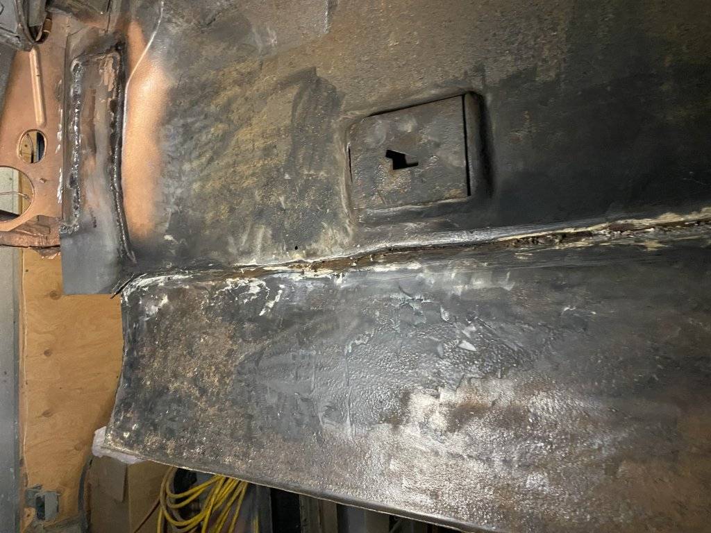

Next step is to wire brush the whole tub. 60 years of rust and dirt inside a tiny 2' x 3' box.

Began brushing the tub. came out looking like a coal miner and/or victorian batman.

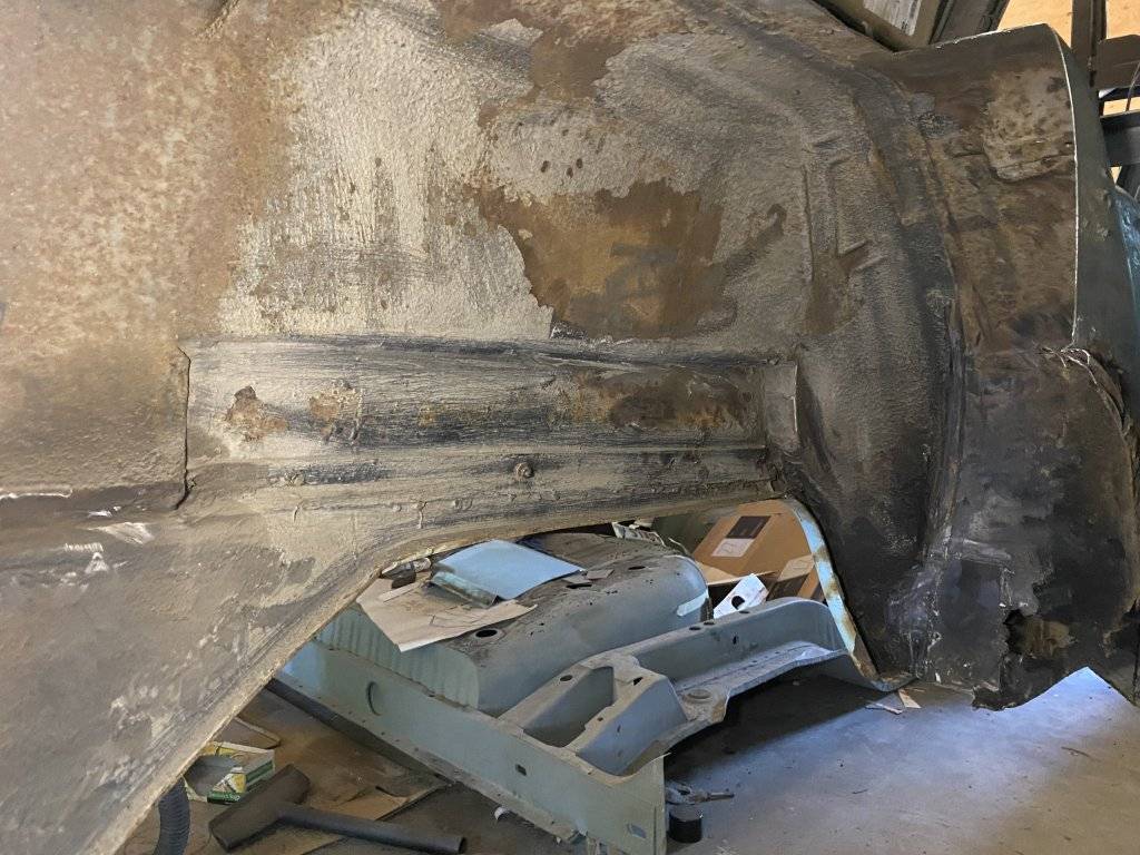

The hack fraud bodyshop strikes again. Complete with booger welds and failed weld wire sticking out. Though whatever undercoat they used is ******* amazing and not even the wire brush can dent it. I have to melt it with the blowtorch before it lets go. Quality hackery!
You can see they cut up the inner tub and just welded it to the quarter panel. They appear to have filled the entire lower quarter with bondo to make it look flush. I'm sure that's about 20 pounds of the stuff. Not sure what to do about it.
The entire corner looks to be junk and the entire tailgate sill appears to be bondo. Probably going to have to fab that entire panel from scratch once everything else is done. I cannot get it out without removing the tailgate.

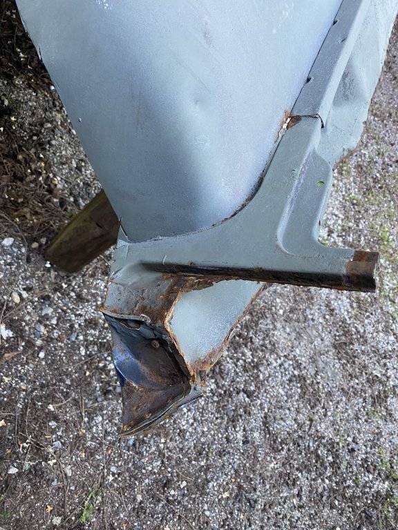

I'm going to try to get the inner inner tub out in as close to one piece as i can so i can use it as a template to fab the missing parts of the new one. Everything else is pretty simple to draw up, just a lot of it.

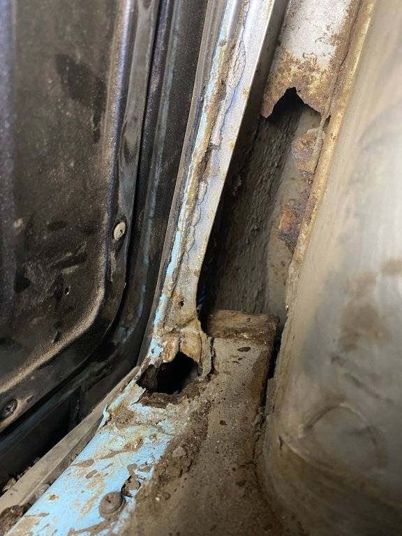

Hey wow this sucks!

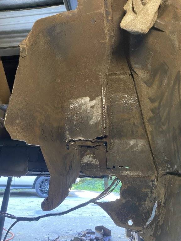

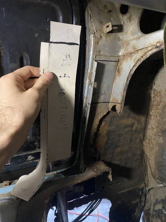

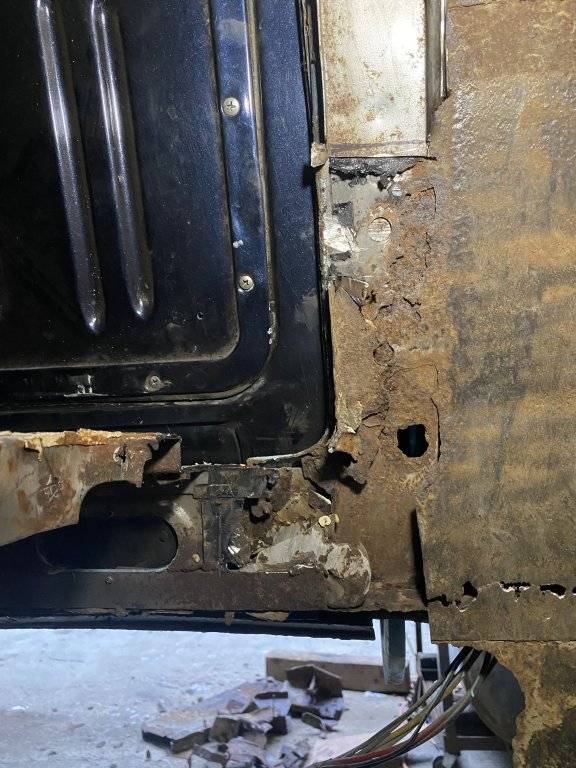

Looks like water got between the tub wall, tailgate sill and D pillar. Major surgery inbound, it's all coming out.
The tailgate sill has been revealed to be nothing but bondo. And annoyingly, appears to be an extention of the d pillar wall. At this point the tailgate is the only thing holding the bottom of the sill square. Can't remove that angle iron either, there is nothing else there. Going to have to patch the D pillar skin and just leave myself enough to weld to on the other side, and i'lll make the sill anew from the top afterwards.
Interestingly though, between the tub brace, tub wall and D pillar, there was a rubber gasket between the welded panels. I've never seen that before, and it must be original, there's no other way to get in here and all the spot welds are untouched. Very strange.
Taking templates as i go, cutting everything out. Just a lot of very simple stuff arranged in a very specific order. We'll get there.

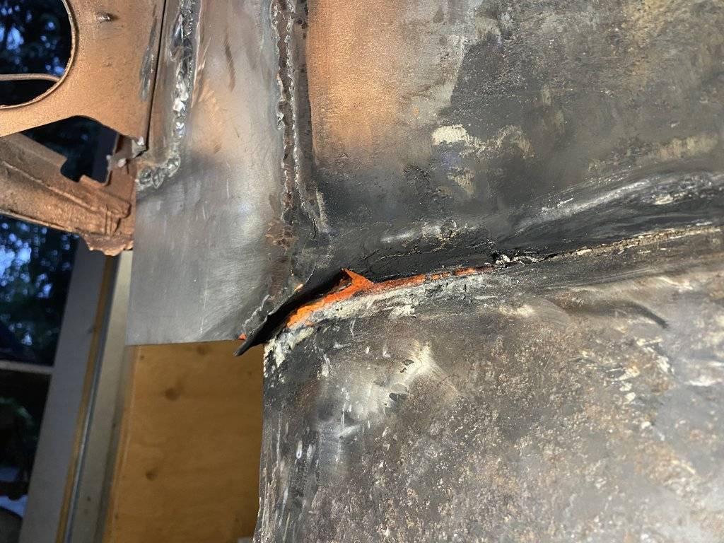

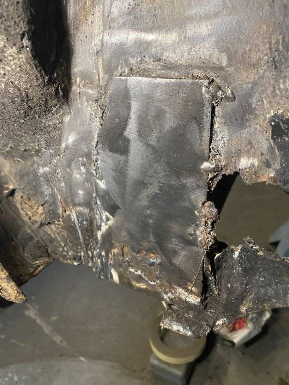

Starting to fab this corner back together. The outside/rearward facing section of the tailgate sill is junk, but I can't weld a new one in with the tail gate pressed right up against there. Probably going to very carefully cut out what needs to go, and then weld it in from the other side later.
Also hey, turns out this entire corner is just 1" thick bondo. Because of course it ******* is.

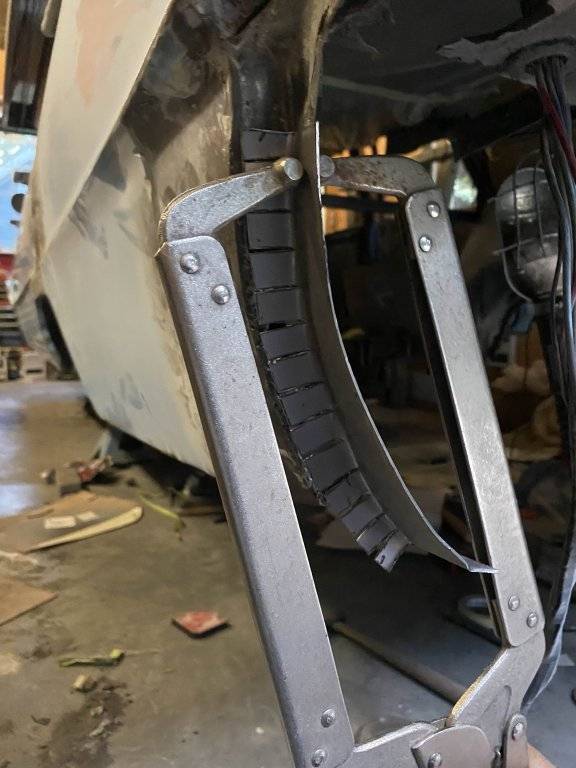

Who needs an english wheel when you have a fire extinguisher, a dolly and a hammer?
Chumps, that's who.

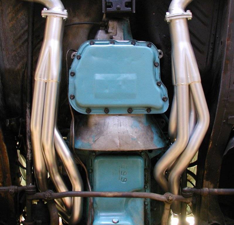

I'm pretty close to pulling the front end apart and I don't feel like making the exhaust twice on this car, so I just bit the bullet and pulled the trigger on longtubes.
Wild overkill for a bone stock 383, even the magnum motor that it has, but let's call it future proofing. I got plans.

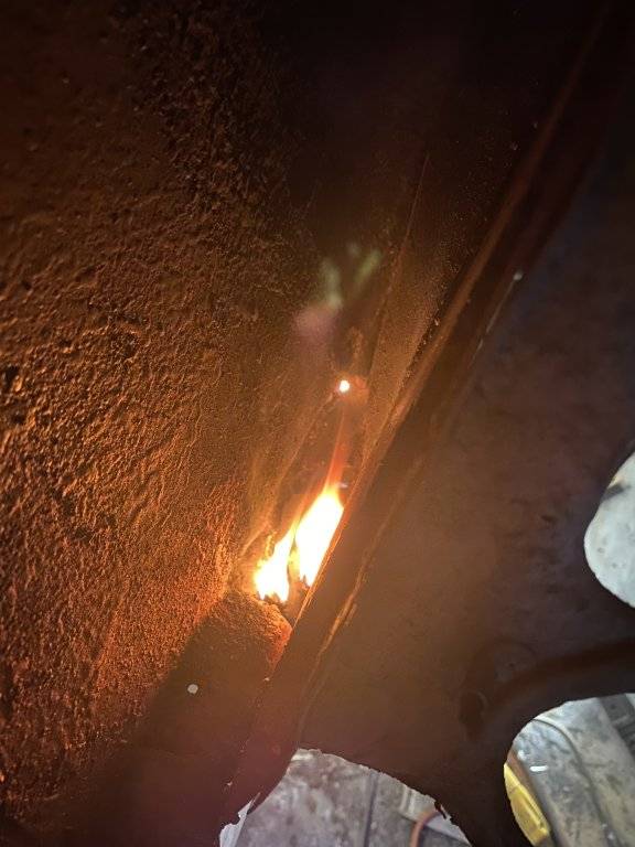

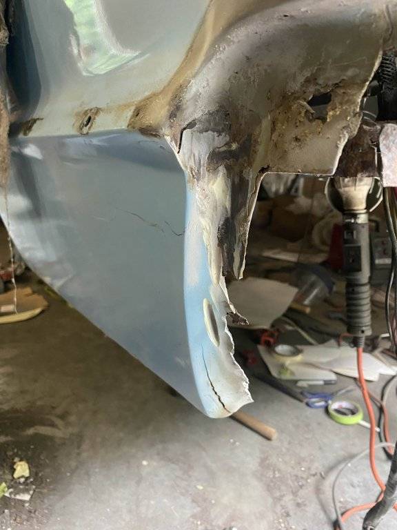

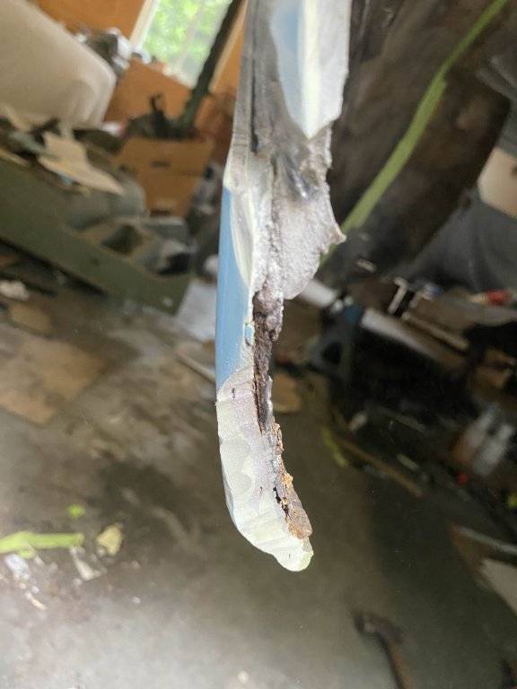

Started patching the D pillar, and set the quarter panel on fire.
Turns out this entire jank seam the bodyshop made by folding the inner quarter over, is nothing but bondo. Vaguely tack welded every 6", except not really, as the welds never got both panels, meaning the bondo was the only thing holding the garbage together.
This mystery bodyshop is worse than the rust.

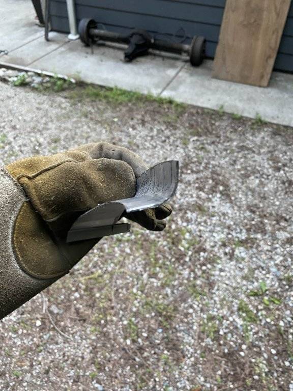

The new lower quarter is also very very dense, I'm not sure what's going on. It feels like they used 3/16" plate to make it, or a sandwiched box section filled with lead. Who knows. I count it as a win that it's actually metal on both sides. Good enough!
I think the best call is just making a new factory style inner quarter from scratch. Could be worse.
