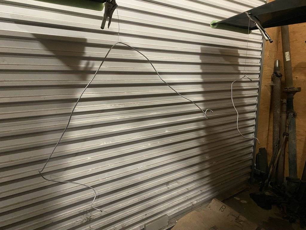

Going full show car and painted the new brake lines.

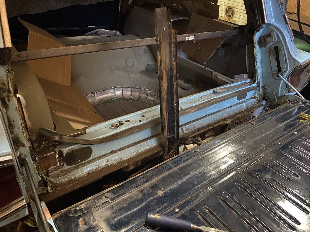

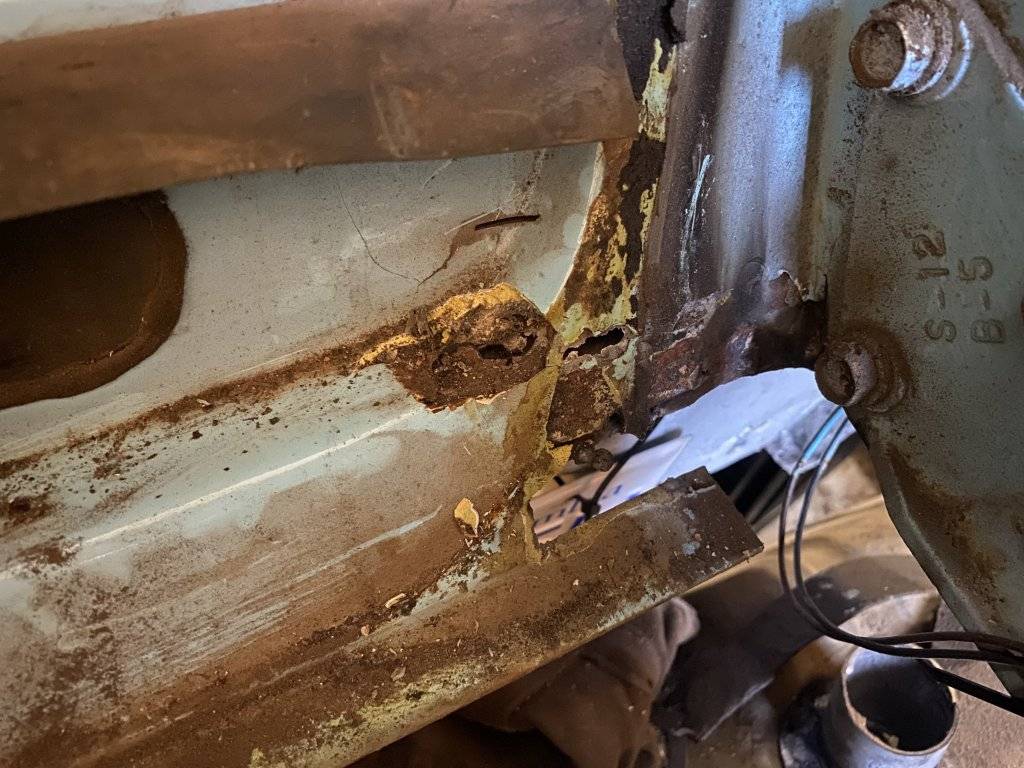

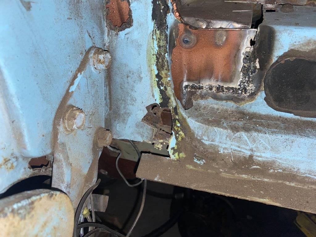

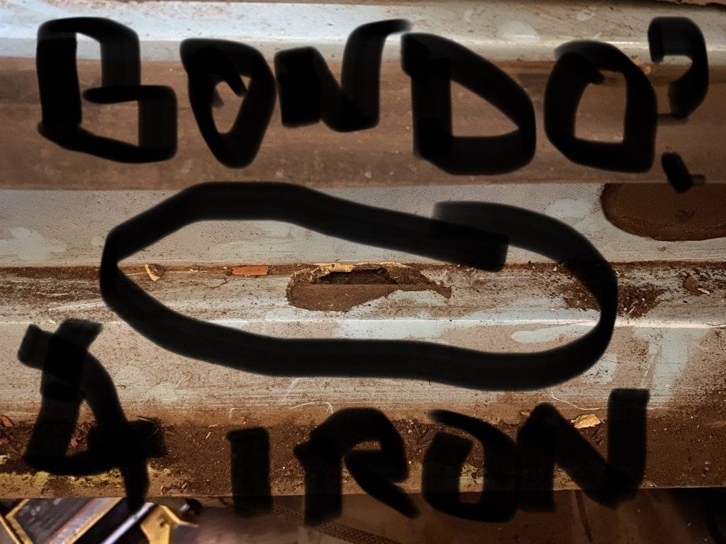

Oops, all bondo!

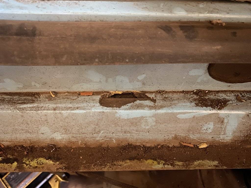

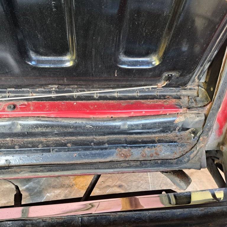

There's a huge gap between the angle iron and body that's filled with nothing but bondo. I think the back of the floor/frame was literally held up by bondo this whole time. No wonder it's so bent up.
I do have the proper panel from the fury in blue, easy to fix. The rest is easy to fab. Thought I was out of the bodywork hell zone but i guess not.
Oops, all bondo!

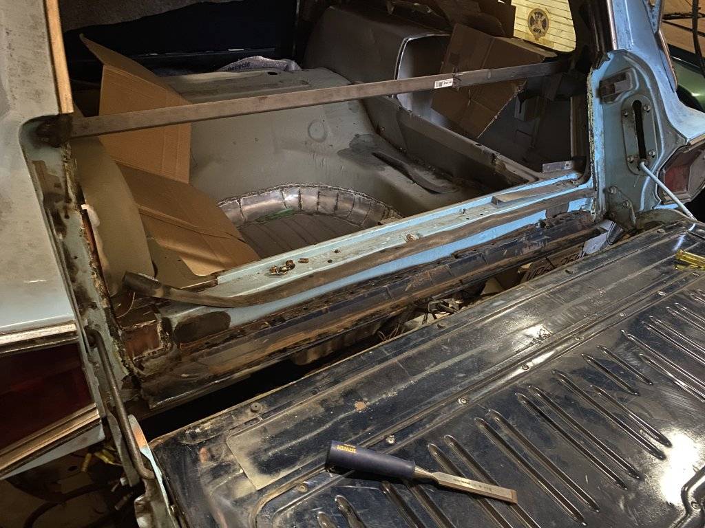

Yay! You got the tailgate open!

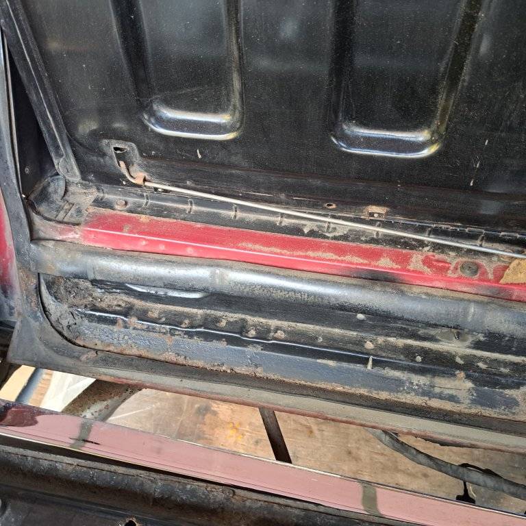

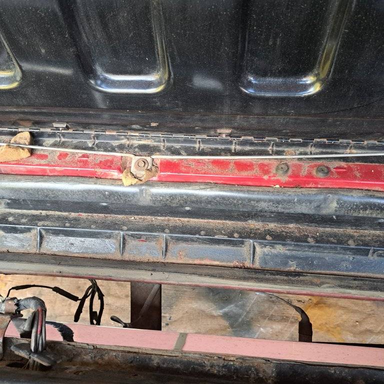

Can anyone with a wagon take photos of the drip rail panel for me? I don't have the full stamping and I'm not sure how it should be in the far corners.
Yeah that's very helpful, thanks. Splash panel goes on top, and ends where the weather stripping ends. I thought I may have been missing a part that goes into the hinge pocket but no.
Any idea how thick the metal is below the fill panel? It's 3/16" angle iron here, but I refuse to believe it was 20 gauge sheet metal from the factory, as it supports the back of the floor/frame without any boxing/gussets

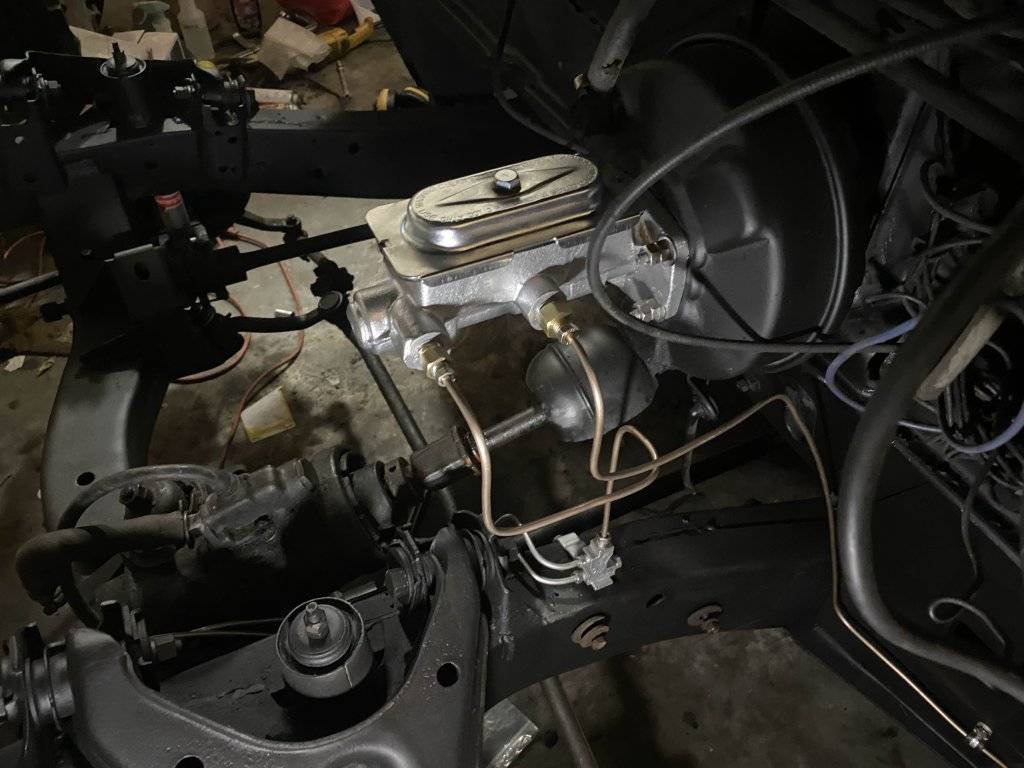

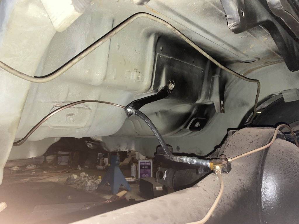

Speaking of, got the brakes all buttoned up. Came out alright.
Hopefully this clears the wheel wells. It'll never see wet again, so I was actually planning on running without the inner fenders, both for weight and to vent the header heat out better, so it's not a world ender if it doesn't. But it'd be nice to go back to stock if i wanted to.

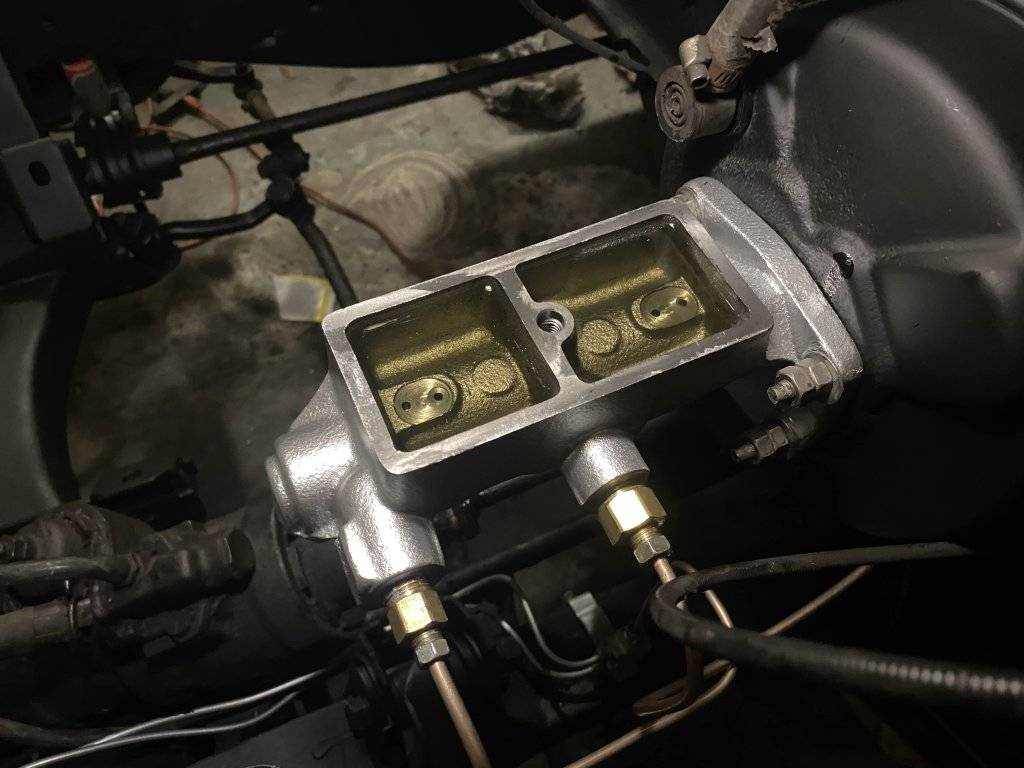

Though I do have a question about this master, it's a '67 Polara drum master, and I noticed when bleeding it, it pushed more fluid through the second hole in the resivioure vs the line itself. Is that normal? Didn't seem to be moving very much actual fluid.
