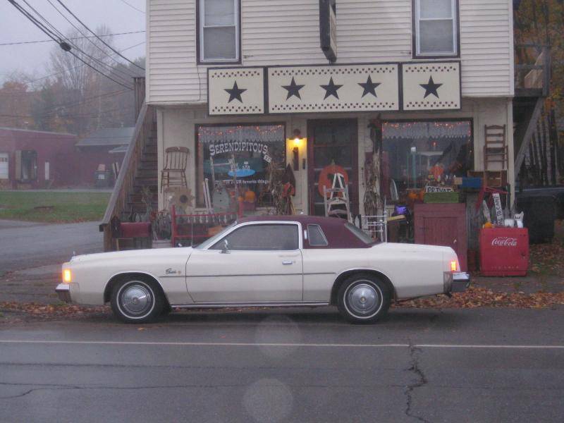

You asked for a picture so here it is, Finally!!! Yep, She's twenty-footer (drivers side only) Passenger's side - not so much. This picture was taken when she broke down in front of a vintage/antique shop. Kinda' appropriate for a vintage car!She runs great for about 5-10 minutes then just quits. It has been sitting for 5 years or so. I have a carb repair kit and a new coil for the between-snow part of our year. Your car is looking great. I've found a locally owned alignment shop that was "Established 1983" so hopefully they will know what to do.
