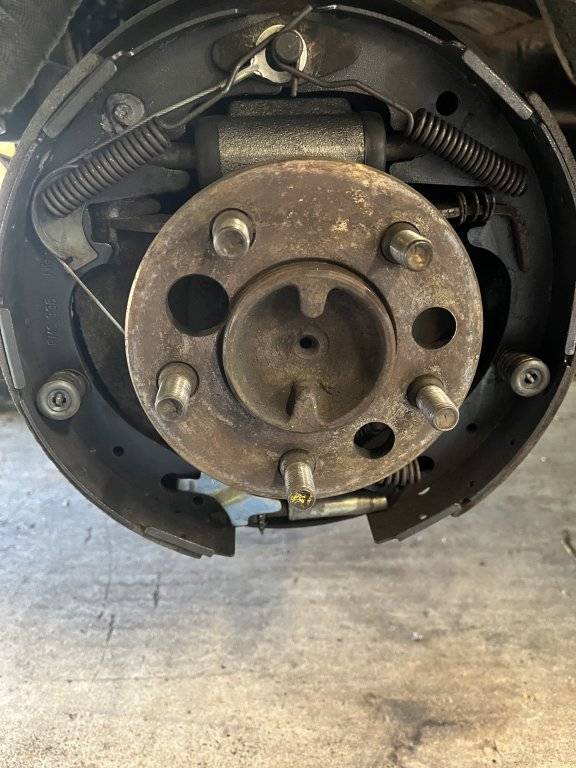

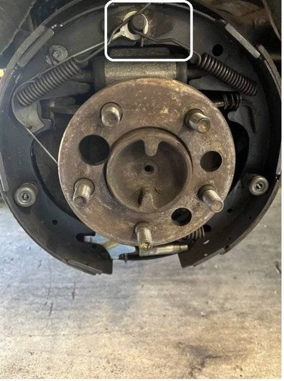

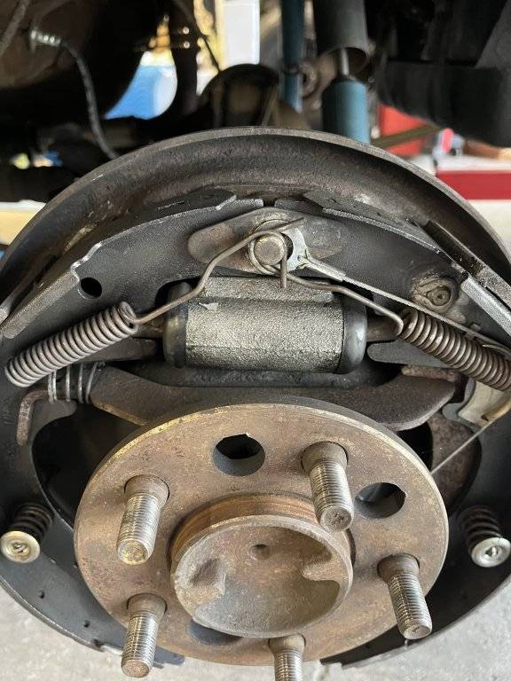

if the spreader bar isn't pressing on the primary shoe and both shoes are resting on the stop, then the parking brake is effectively released. at least you have the temp. issue isolated to the one corner. that would eliminate a lot of stuff. in previous posts you indicated that that corner was higher than the others. have you given any consideration to it possibly being the wheel cylinder as pointed out earlier? in this picture, the park brake lever is released. the spreader bar is just touching the primary shoe at the left end. shoes are on the stop.
in this picture, the lever is thrown to apply, but the spreader bar does not appear to be pushing on the primary shoe and the shoes appear to be on the stop. why? wrong bar?

Please take 5 seconds with a pair of channel locks and squeeze the spring ends so they aren't spread like that.

if the spreader bar isn't pressing on the primary shoe and both shoes are resting on the stop, then the parking brake is effectively released. at least you have the temp. issue isolated to the one corner. that would eliminate a lot of stuff. in previous posts you indicated that that corner was higher than the others. have you given any consideration to it possibly being the wheel cylinder as pointed out earlier? in this picture, the park brake lever is released. the spreader bar is just touching the primary shoe at the left end. shoes are on the stop.View attachment 598569in this picture, the lever is thrown to apply, but the spreader bar does not appear to be pushing on the primary shoe and the shoes appear to be on the stop. why? wrong bar?View attachment 598570
I thought about the wheel cylinders. I noticed that these new ones are actually leaking a tiny bit. I will have to replace them again. Maybe I under adjusted the shoes and they pushed themselves out too far? The push bars (as far as I know) should be the original ones. I ended up finding an oem parking brake cable that looked to be in really good shape so I'll replace the current one with that one and see if that helps.
Yeah they're looking a little rough haha. I have new hardware for both sides that I'm going to install once I replace the parking brake cable.
just wondering why there is such a difference from side to side. without actually seeing it i couldn't say that it's causing a problem. if the bar is too short, there is the remote possibilty that it could cause the lever to hang up on the secondary shoe. you can check the action when the new cable is installed. finish connecting it to the lever in the drum and pull on the cable end by hand before connecting the housing at the chassis. good oem is the way to go. new aftermarket are generally junk.
