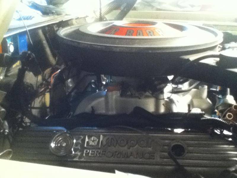

Refurbish time
That fabrication for the RPM setup is flawless. Looks factory!
Posted via Topify on Android
He did do a great job on it. The horrible thing about it though, is he's probably going to have to take it back off, and go back to factory. It looks like the intake is too tall!
Did he not measure the additional height? I have to use a shorter air cleaner screw in the middle of the carb so the hood does not come into contact with it when closed.

I would get a complete 3 piece kick down setup. You have a lot more options with throttle linkages, and kick down linkages ect with that. If you decide you want to go back to a stock high manifold you have a backup linkage. I use an edelbrock performer on my 440. It's close to stock high, so no clearance issues. It makes power from idle to 5,500 that's perfect for a street car. The performer rpm doesn't make power till 1,500 rpm and it's taller.....

Not sure if hes gonna try and make it work or not. He had fair warning when putting it together it wouldn't work, but he was hell bent lol. Hes just now getting the front end on the car. Hes been putting the car together piece by piece for the last 2 years.

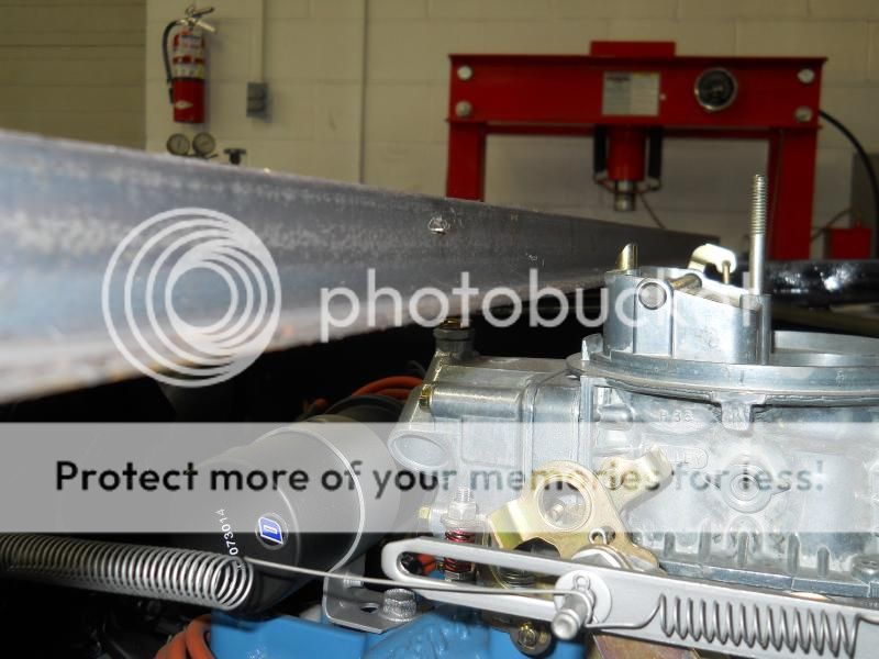

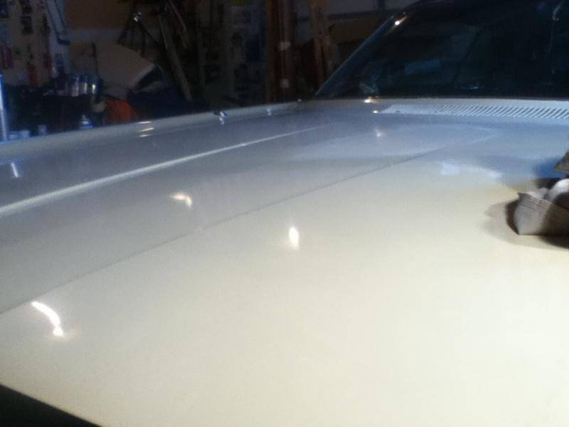

Heres the car in its current state..
Heres with a straight edge going across the fenders. The hood will give a little more space, but just don't see an air cleaner fitting under there...

No the only problem was hood clearance. Formals have absolutely no room under the hood. When he was putting the motor together, I was keeping my fingers crossed that it would work (I want to install one on my car badly!). But theres just no space...
That sucks. Looks like the rest of the car is coming along nicely, tho.
