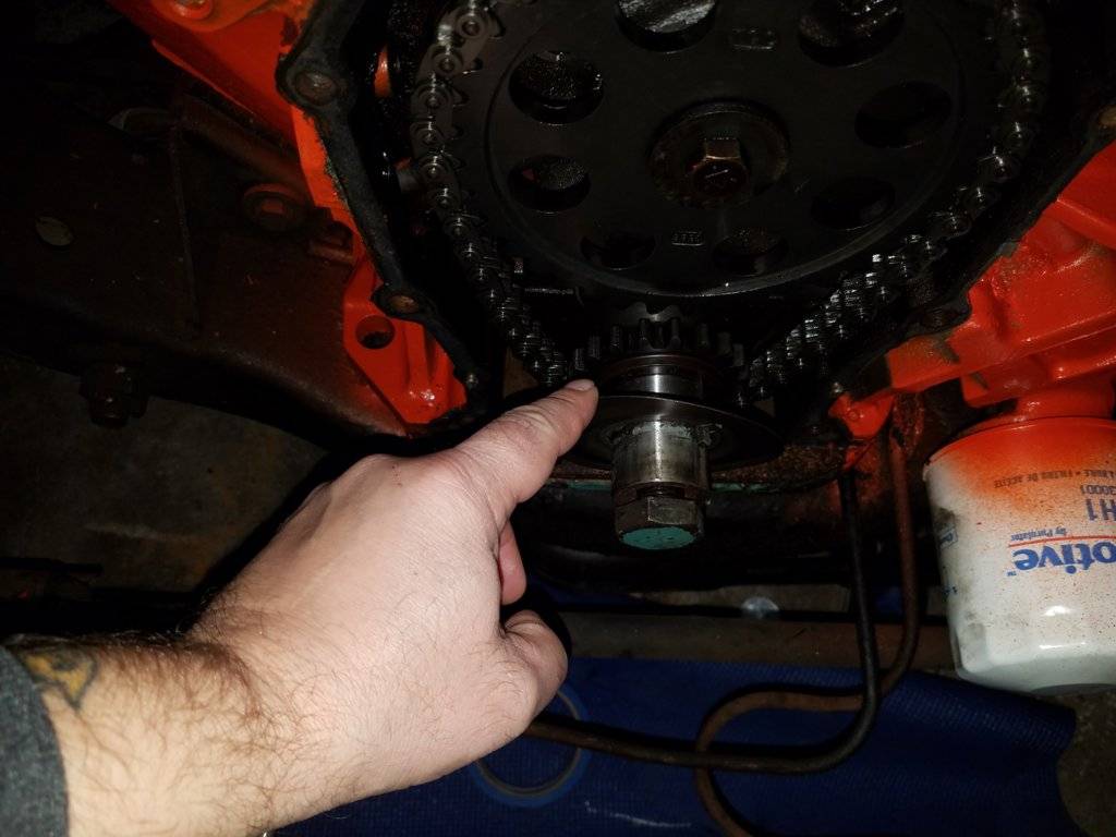

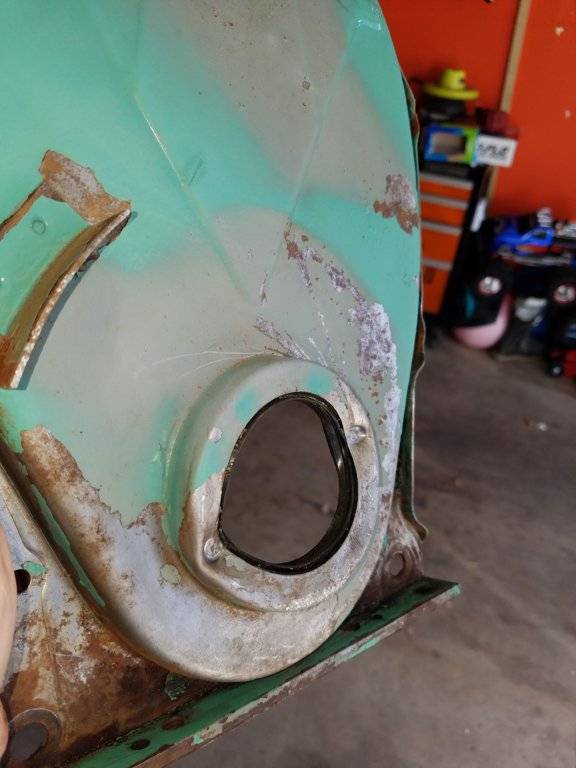

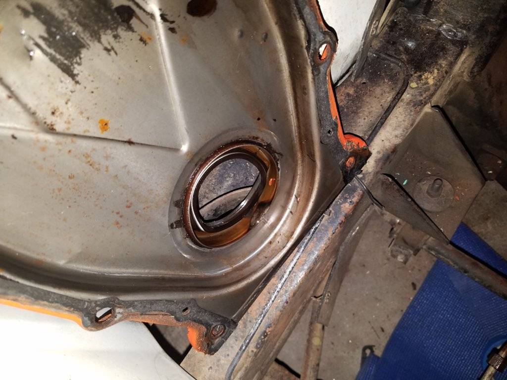

So I need a new cover bc when I used the balancer remover I guess I went into far with the bolts but you live and learn right. So, what's the metal ring that's sitting up against the lower gear? When I order a new timing chain hear set will this come with the set?

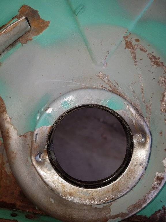

You might not need a new cover if the seal took the damage, you can replace the seal itself.

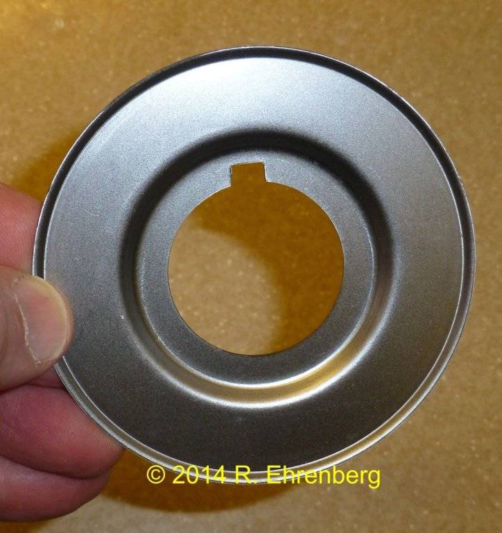

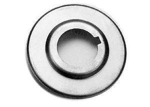

The metal thing is the oil slinger, not sure if it comes with a timing gear set, I don't think it's a wear item. Notice how it goes on, only one way.
The oil slinger I can't remember which way to behonest. My owners manual doesn't even show it. The cover is pretty dented in and the seal is bad also lol.
The oil slinger can only go on one way. If you put it on wrong the front cover will not mate up to the block. It's purpose is to help keep oil away from the seal, and lubricate the timing chain so do not forget it, or you will have a big mess.
Raised boss toward lower gear. Straighten the cover best you can, hammer, pliers, put a thin bead of RTV in the corner before seating the new seal if it worries you.

No, but you may be able to straighten it enough to get away with reusing it after installing a new seal. As is the flange is too whacked to allow the seal to seal.........
Ok that's what I was thinking, I tried bending it but she just wouldn't move anymore than that. I think the photos I posted last night didn't show as much of the damage lol
