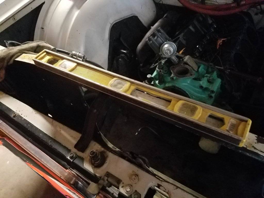

So far as I dig deeper into my 383
68, I wasn't using a hammer promise. I was taking some tools back out to the garage and got side tracked and must have laid it down I'm getting old lol.. really that's how I was going to remove the lifters lol joking and yes I'll go buy a straight edge lol

Why all the trouble trying to measure the block deck? It seems you really do not know if the engine was rebuilt or parts of it were rebuilt. It would be wisest to simply take the engine out and apart and let an engine machine shop do what they do best - hot tank all the parts, magnaflux all the re-usable parts for cracks, inspect for wear using the correct micrometers and dial indicators, and check the bores for roundness, taper, wear, and squareness of the deck surface. You can't do this with a straight edge, feeler gauges, and plasti-gauge disassembling/rebuilding the engine in the frame. Hate to see you throw good money away only to fire it up and have the same problems or worse. Don't do it cheap if you plan to keep the car a long time and drive it regularly. Figure on spending $3-$4,000 to do it right if you have to replace most parts.

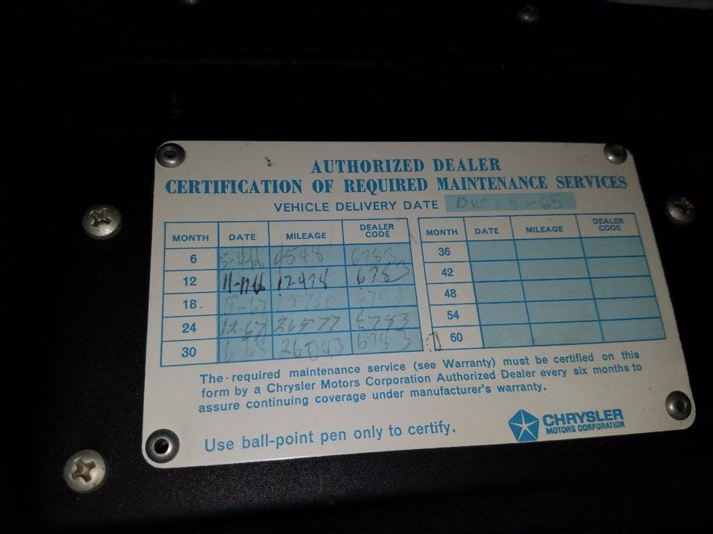

And this is pretty cool like a Easter egg find ;)
