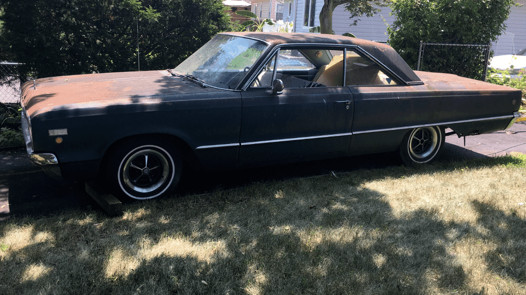

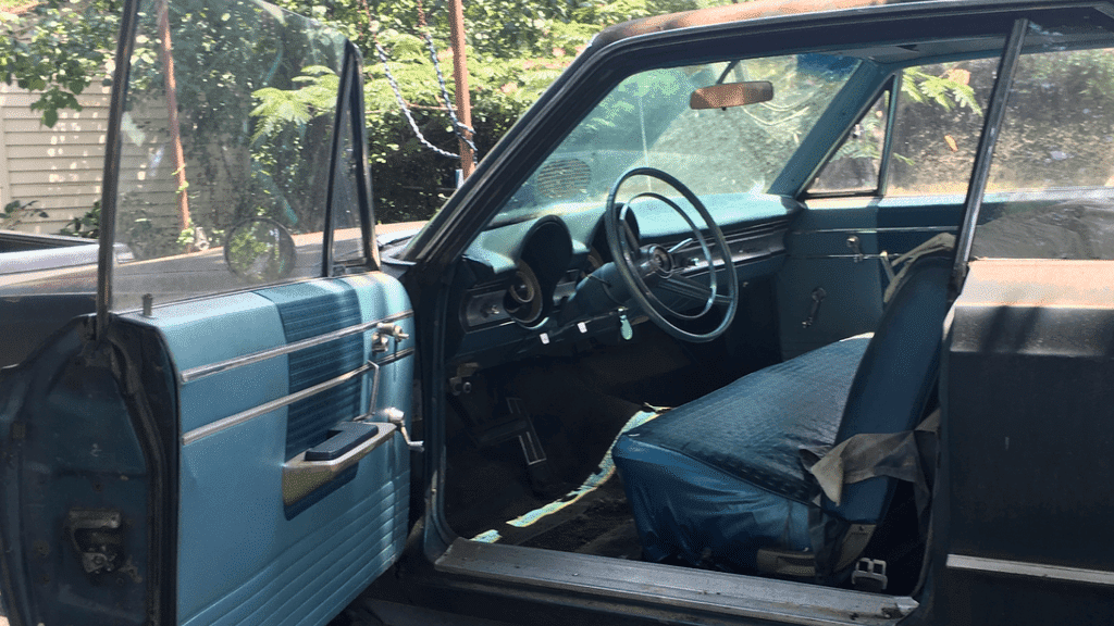

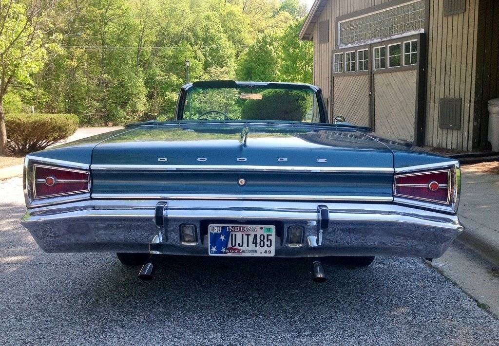

Just picked up a 65 Polara 2 door that has been in the family for a while. Has been sitting for a few decades...time to get to work!
Here she is in all of her glory. Some bad rust on the back "quarters" other than that, pretty solid. A dented front fender that I have a replacement for.
Current game plan: Kind of just looking to get it road worthy- engine/brakes etc and the bad rust repaired. Then I will start doing some body prep work before eventually getting it repainted the factory color. Most likely at that time I will start the engine mods. Anybody else tackle a project similar to this caliber and have a strategy that worked well?
Suggestions on how to approach the back quarters? Its basically from below the trim down that will need to be addressed.

Nice one, man! If she runs at all as doesn't have any potential catastrophic issues, I'd say go for the brakes first. Once you get her safe that way, get the engine running best as it can in a stock configuration. After that you can see whats up with the sus/steering and see if they tranny is operating properly.
Once you're up and running stock, you can start playing with mods. It's just easier to start with the baseline of a stock motor, that way you're pretty clear on what happened when things go haywire.
Nice car! Looking forward to see her come back around!
Looks like a decent starting point to me. I had similar issues with my rear quarters when I fixed mine up and the only option was building them. Thankfully my Dad was a bodyman - he gave me some pointers and provided some tools, then wandered by from time to time and kinda watched me go. Didn't turn out too bad, and they're still holding up fairly well today (repairs done in '90).

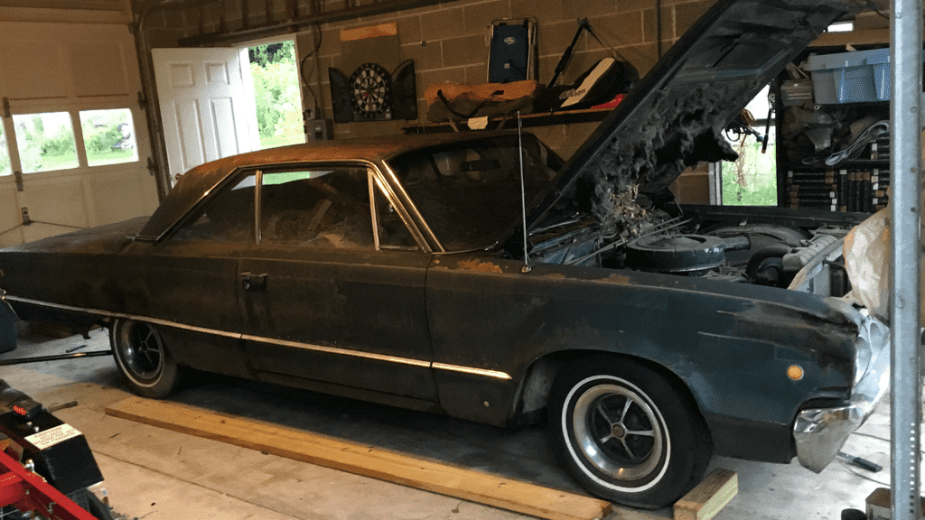

Yeah, the rust on the quarters is one of the few things I wont address myself. Other than some (not so great) experience with bondo, I have little experience with body work. Excited to dig in. Only hauled it home a week and a half ago so Im still getting it set up. Started draining fluids/pulling spark plugs etc. Think I'm just going to yank the engine to make things a little easier to assess.

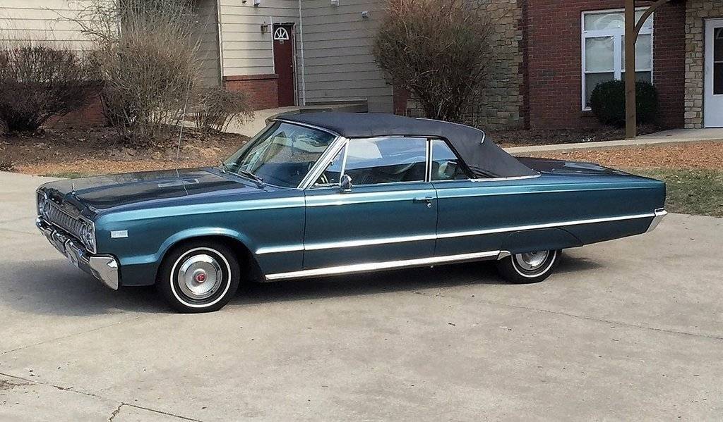

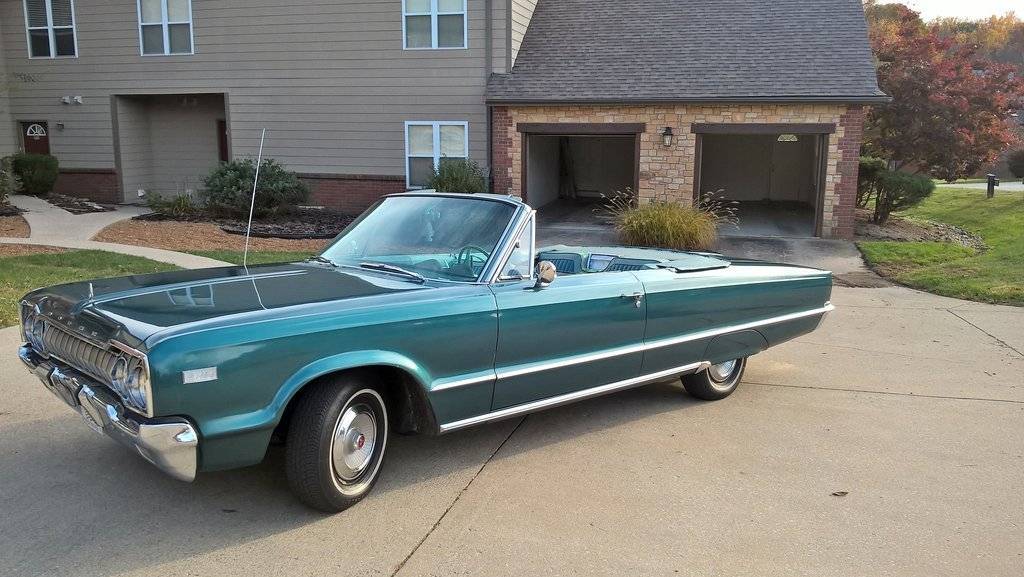

Mine is just a Polara with a bench seat and I have really enjoyed it.

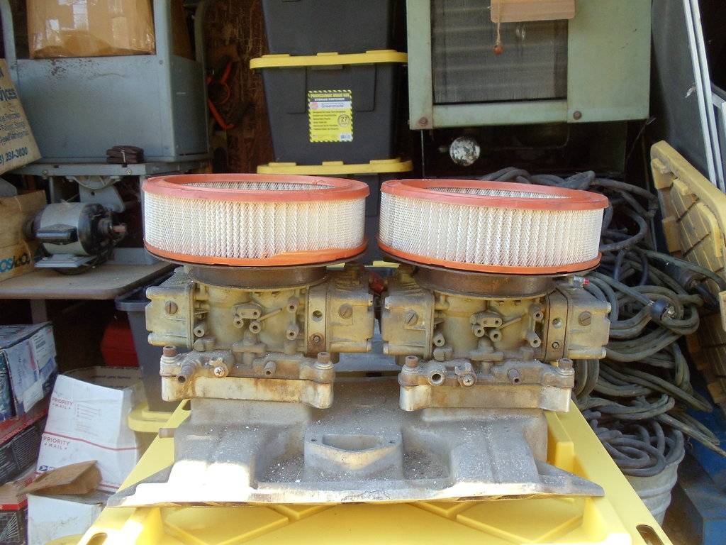

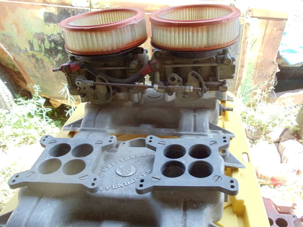

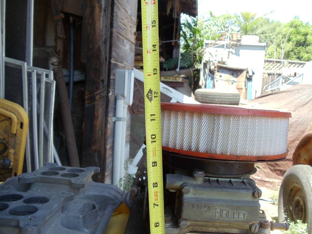

had this intake on my 383 in my 65 880 rag for awhile . touched the hood pad with the air cleaner tops . with a solid cam and headers , factory presto duel point . it ran , lol .

General update on my rebuild: Pulled the engine...have it torn down. Looking for shops in my area to help with the rebuild. Just ordered some parts to begin rebuilding the braking system.
