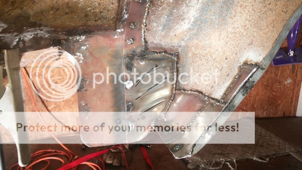

A little more progress. The outer wheel well is being fabbed up. A big pain with all the curves, and tight areas. Luckily this wheel well isn't near as bad as the passenger side was. I was doing good saturday, until the welder went down needing maintence. Barely touched it sunday. But its getting there. I can taste it! Gotta finish up the wheel well, trunk pocket floor, a few tiny spots on the wheel lip, and a couple spots on the rocker. Then all the lower sheet metal work is done!

Not much going on. Finished up the dog leg/wheel well front corner. Now on to the back of the wheel well. Its not real pretty yet, but I'm working on it. I set the trunk mat on fire today. Thought i was gonna be SOL for a sec. Luckily I was able to "smack" it out. But it got pretty big for a few.. lol
Jumped back on it today. Rear of the wheel well installed. Needs to be ground down, and a couple holes filled.
Also fabbed up the trunk pocket floor, and got it welded in. Came out much better then the other side. Looks factory from the underside. Should have plug welded it to the quarter, but didn't think I'd be able going off the other side.
They grind down a lot quicker these days lol. Still sucks though!! Another big part of it though, is this sheet of metal seems to be a gauge or 2 bigger. It takes the heat a lot better. Doesn't burn holes quite as easy.
Could I bug you for a pic of the rear of your wheel well in this arear Stan? Or anybody with a formal? The bottom of the wheel well seems so low to me, can half *** see it from the side of the car. Wondering if this is how it should be? It seems right, but mine were so rotted away, I didn't have much to go off of..

Some more accomplished. Added some new metal around the wheel lip. Once the metal behind the new patches is in, this section is done. All that's left is the drivers rocker, and one of the legs on the leaf spring mounts.
