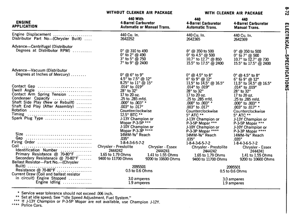

Do you think these specs would be helpful?
View attachment 282358 Do you think these specs would be helpful?
I'm sure he has that info. You need you actual specs in car now.

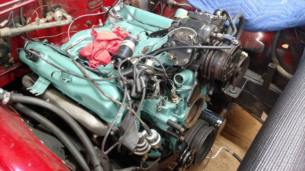

As you may remember from previous posts, I had a hassle getting the A/C compressor mounted, because I didn't have the correct mounting bracket. Here it is finally mounted and ready for the rest of the accessories, etc.

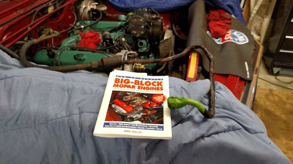

My bible:

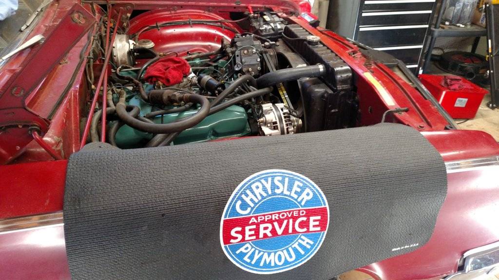

And viola! Here we are all ready to go:

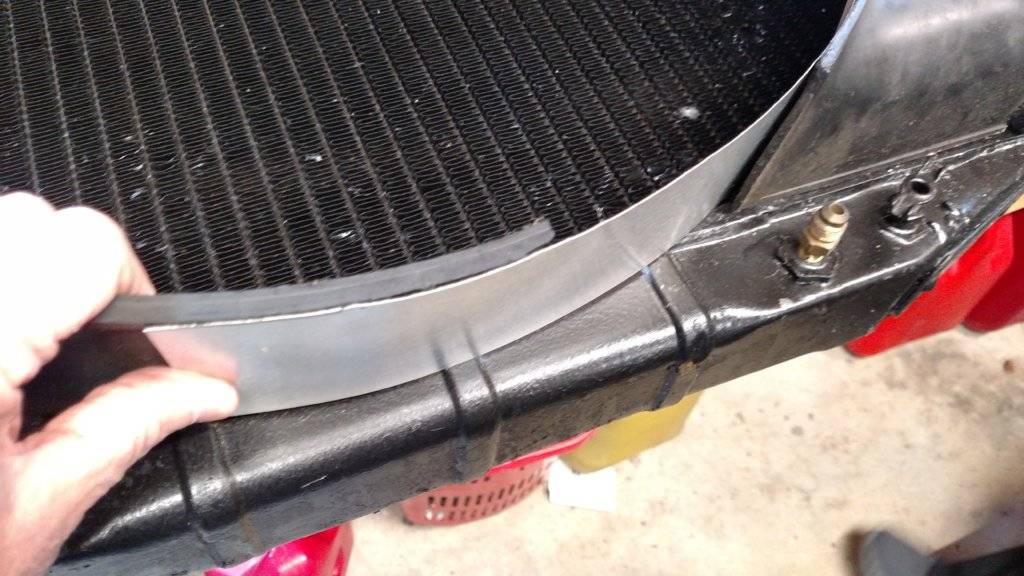

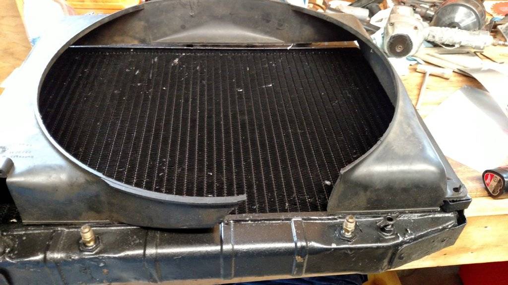

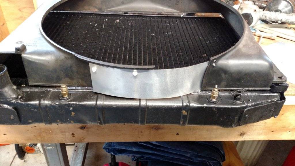

Along the way, the radiator shroud needed repair. Maybe I'll replace it some day, but for now its good to go:

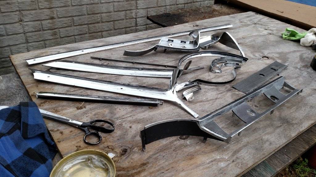

Some of my dash trim is in poor shape. A year or so ago, @LatPeahy was parting out a '66 300, he sent me some good trim that I shined up:

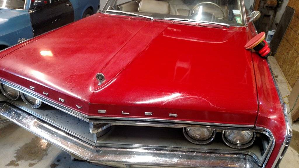

Just prior to the Carlisle meet, I took a stab at buffing out the old original paint. Came out pretty good:

My bible:

Hey Rip, rookie question fer ya...what does that book have that the FSM doesn't?
I would assume little tricks to get more performance?
No. It tells you everything about how to remove a big block Mopar engine from your car, how to go about getting it rebuilt and finally how to re-install your engine, get it running and broken in. It has lots of tips regarding what to do from the first step to the last. I never would have been able to do my engine swap without this book.
