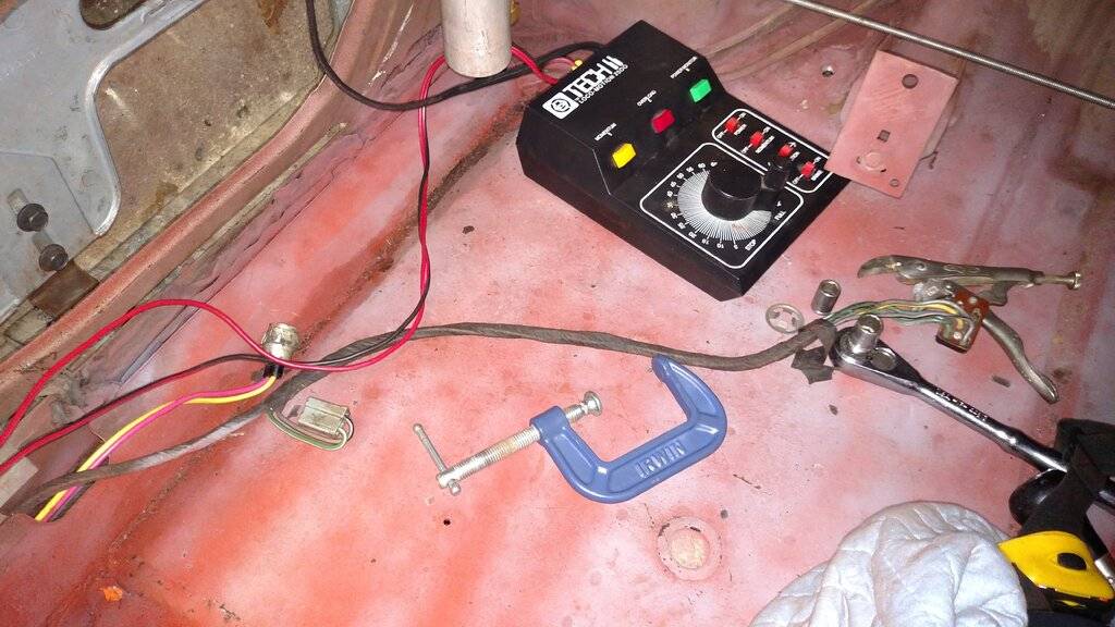

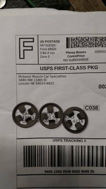

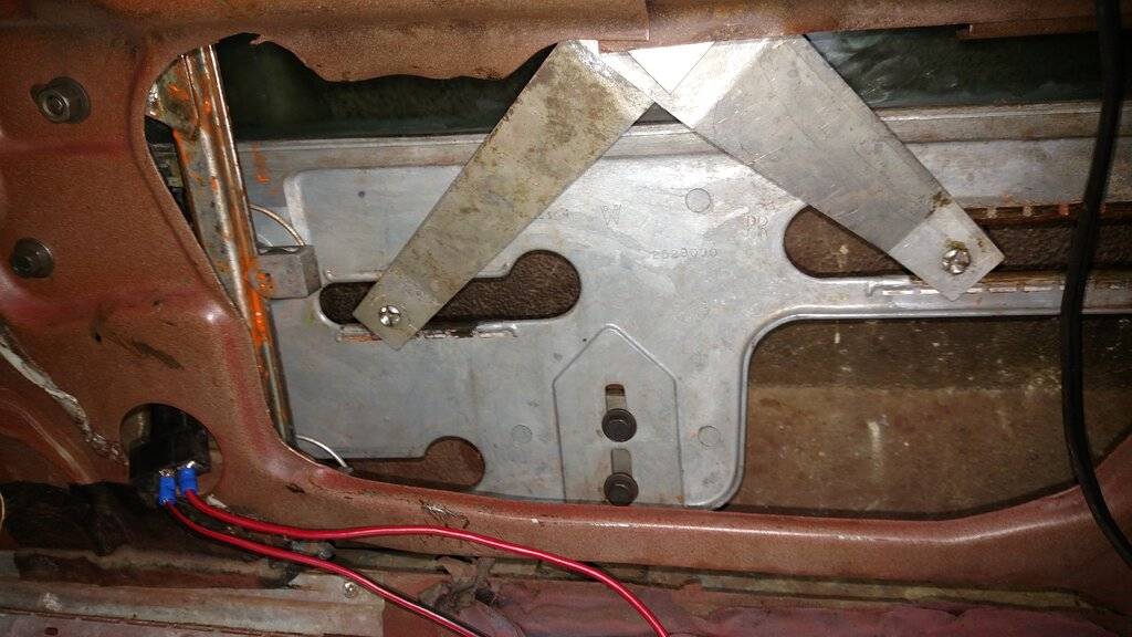

Its been a lot of little things; the most recent involves the rear quarter power windows. They have really been kicking by butt. I have installed a replacement right rear quarter window and frame (thanks, Murray) and a rebuilt window motor from JC Restorations. It is all together - EXCEPT - for one spring clip that retains the roller in the window frame to the pin on the regulator. Its the pin on the left in the photo below. I was able to snap the spring clip onto the pin on the roller on the right, but I can't get enough leverage with my fingers in the smaller space around the roller / pin on the left. Is there a magic tool or procedure I should use that will help me here? I added a few other photos associated with this. . .
View attachment 398674 View attachment 398675 View attachment 398676 View attachment 398676
I swear. . . It's like an immaculate conception has occurred . . . And Stan was right. It takes three hands to hold the clip and at the same time hold and turn the screw on a c-clamp with a 1/2 inch socket positioned on the clip and over the pin. After I gave up, no.1 son and his buddy from across the street were able to finally get the clip to click onto the pin. Here is the result:

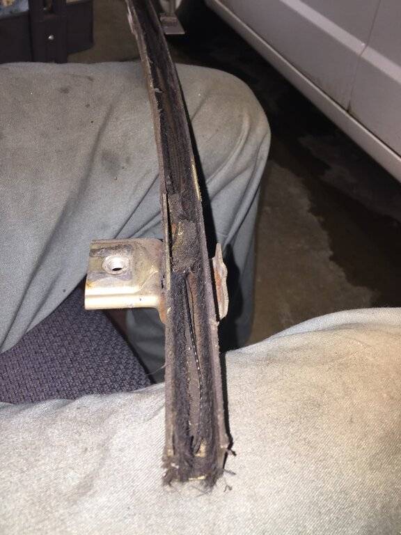

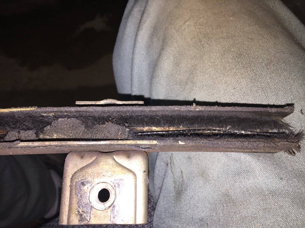

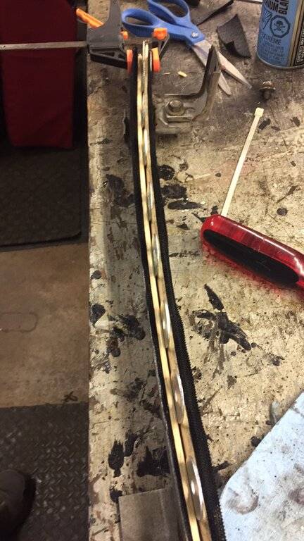

Speaking of patience, I'm still fighting the power window thing in the driver-side door. The motor works and I got the front edge weather strip installed (had to do it twice). An old post from @MYSINBIN was very helpful. I'm almost done, but the window channel where the rear edge of the driver-side window rides needs a new felt liner (Item No. G-100), which I also got from Restoration Specialties with the front weather strip . The felt strip is very thin and must be glued into the bottom of the channel. Does anyone have a recommendation as to the glue / adhesive I should use? Whatever the factory used originally was pretty tough stuff. I couple of photos are shown below.

I used the 3M brand for the glue.

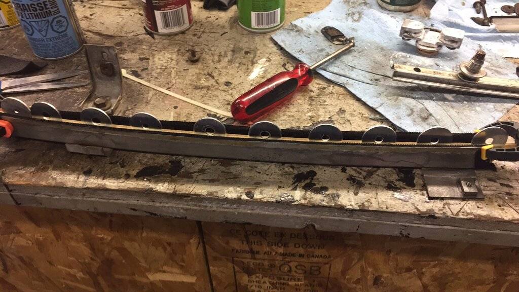

also, I made some thin wooden shims that bent easily to follow the sweep of the channel to make sure that the fabric contacted the entire length of the channel
Clamped it together over night to make sure it adhered.
Any loose fabric, I reapplied glue to secure it

Hey! Thanks a lot. I was wondering how to handle the curved part of the channel.

Here you go.
In reviewing the pictures, I see that I also used big flat washers to secure the wood strips in place.
Also including a few of of the original flocking...
The replacement material was different than the fuzzy style I had but works well.
