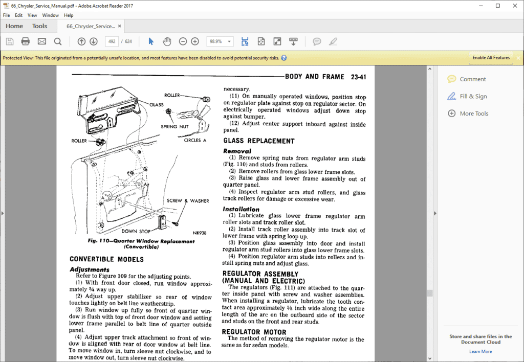

Spring Nuts. . . How the hell do you get them off?!? I'm working on getting the regulator / power window motor removed from behind the rear quarter trim panel. The first step in the FSM sez: "Remove the spring nuts from behind the roller arm studs, and I can't figure out how to remove them. Can't get a small wrench or a small socket on them. What do I do? Do they just pop off? If so how? See the page from the FSM below:
The spring nuts pop off but 9 times out of 10 they are no good after that.
Make sure you have spares just in case.
I had not removed glass specifically from a 'vert but my experience tells me you can undo the regulator assembly and wiggle the roller through the slots of the glass..That's if you have room to do so.
Hope this helps

Hey! Thanks a lot. I've been trying to do as you say by wiggling things around. Even removed the window tracks (I know I'll regret this) to get the wiggle room, but I'm just not getting there. . . I guess I can get some spare spring nuts somewhere and try doing it again "the right way."
Hey! Thanks Matt! What the hell?!? I have never seen anything like that. Without that picture, I would have had no clue as to what to do to remove the nuts.
Thanks again!
Happy to help!:thumbsup:

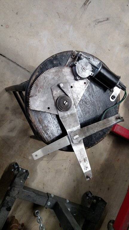

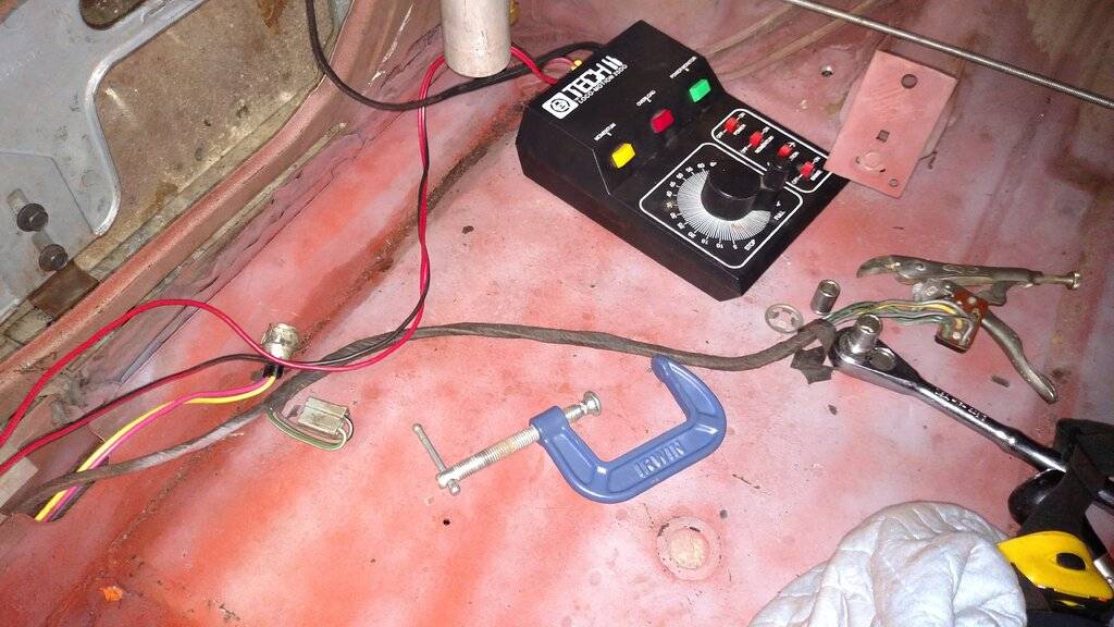

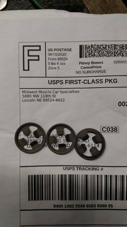

Its been a lot of little things; the most recent involves the rear quarter power windows. They have really been kicking by butt. I have installed a replacement right rear quarter window and frame (thanks, Murray) and a rebuilt window motor from JC Restorations. It is all together - EXCEPT - for one spring clip that retains the roller in the window frame to the pin on the regulator. Its the pin on the left in the photo below. I was able to snap the spring clip onto the pin on the roller on the right, but I can't get enough leverage with my fingers in the smaller space around the roller / pin on the left. Is there a magic tool or procedure I should use that will help me here? I added a few other photos associated with this. . .
How about a washer super glued to a c-clamp and the clip super glued to the washer?
