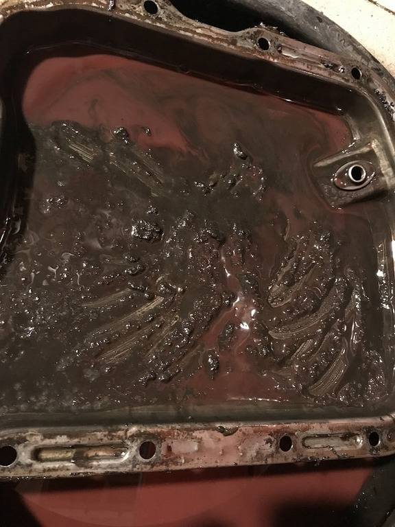

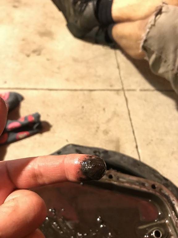

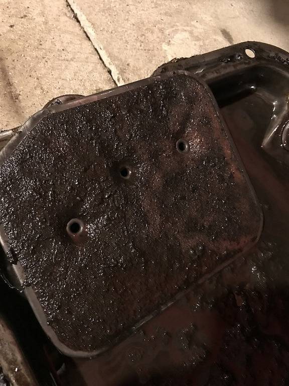

well.. that don't look too good...
yikes:
Lots of matter... not just goop but grit and hard chunks, which makes me think this badboy is a goner...but i ordered up a filter/gasket and atf, and will give it a last shot... why not for $25.
Yikes. Although it doesn’t look like there’s much metal flakes in there - who knows how much of that can be caught up between the gears or in the Torque Converter.
Either a very - very thorough flush or cracking open that trans to clean it will be essential
yikes:
Might want to pressure check the transmission cooler, sometimes thick gunk like that is from antifreeze leaking into the cooler from the radiator.
yikes:
Appears there was NEVER any regular maintenance performed on that transmission. You do realize that when you clean it all up and remove the goop, change the fluid, filter, etc., the transmission will not work at all. The goop is why it works now. Once its all flushed outa there, it won't work. . . Its time to bite the bullet. . .
I doubt that the "goop" is the reason that the trans worked for a hot minute. It's almost certainly the reason why it quit working as it clogged the system and shut down fluid flow. As long as no seals were blown out or the clutch pack burned up, I'd bet that it'll be fine once it's cleaned out.
I'm betting that when all the goop is cleaned away from the clutch packs, there is gonna be nothing left for the clutches and steels to grab hold of. Of course, I would be very happy to be proven wrong here. . .
