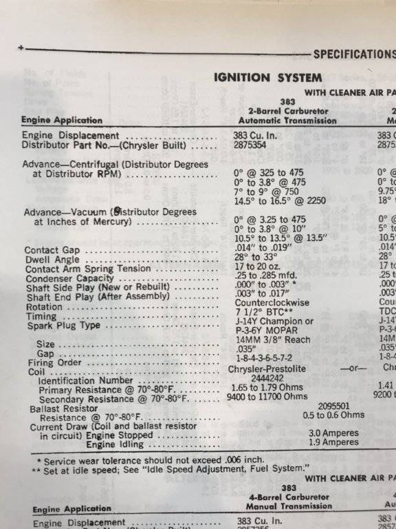

I went to the garage and started looking at my distributor specs. It seems the mechanical advance is kicking in around 600 rpm making it difficult to set the timing and idle. When I get it close to about 600 the idle drops to about 485 and the timing retards. Based on the specs the mechanical advance shouldn’t kick in until around 950 engine rpm (475 distributor rpm). There’s a local shop recommended to me that many classic guys take their car to, that has a distributor machine. I may have him run it up and check and reset the advance curves.

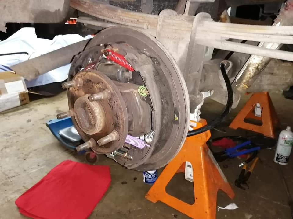

Put rear wheel cylinders in the car, now I have no fluid going to the rear? Ugh. And one of the drums is tight, very toight! Won't need fluid with the friction there. :BangHead:

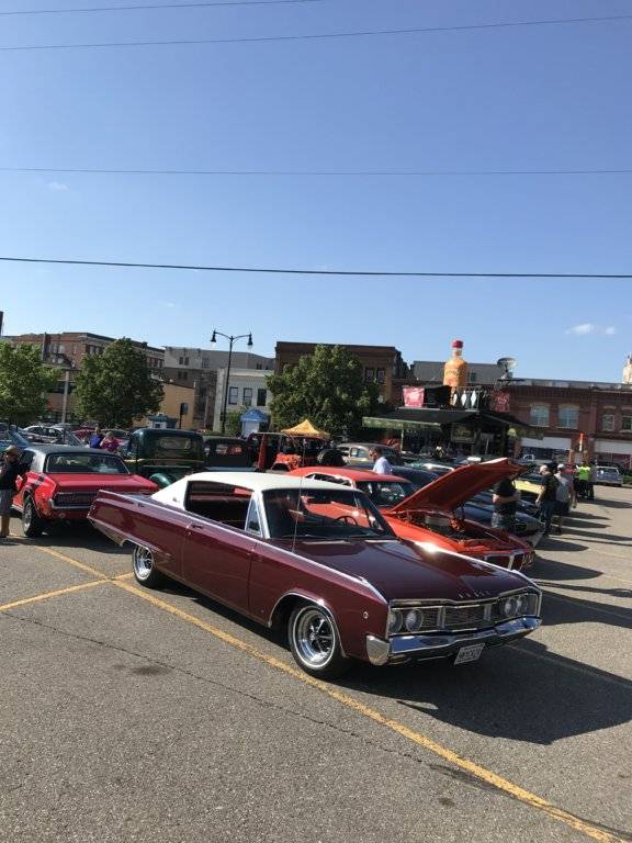

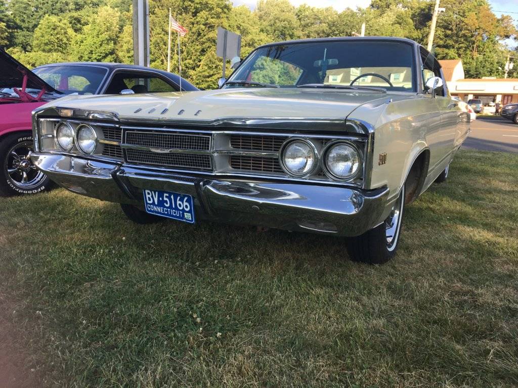

Took it to a local cruise night with a parking lot for about 75-80 cars.
When I got home I looked at my timing a little more. My mechanical advance is definitely kicking in around 620 rpm. I set the timing at 7-1/2 degrees at 480 rpm, no mechanical advance at that rpm. Then slowly brought up the rpm at about 550 rpm it jumps up to 650 rpm and advances to about 20 degrees. Full mechanical advance seems to be just a little higher. Is shouldn’t have any mechanical advance until around 950 rpm and max mechanical at 4500. I called the shop that does classic repairs. He said to call in about 3 weeks and he can run it on his distributor machine. It’s not really causing me problems, but bugs me because it isn’t quite perfect yet. Carb restoration this winter when I am done driving.

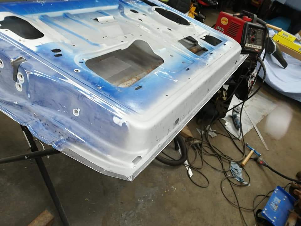

^^^^Wow, that's a serious amount of work on a beater. I'm glad my truck is as rust free as a 19 year old truck can be.

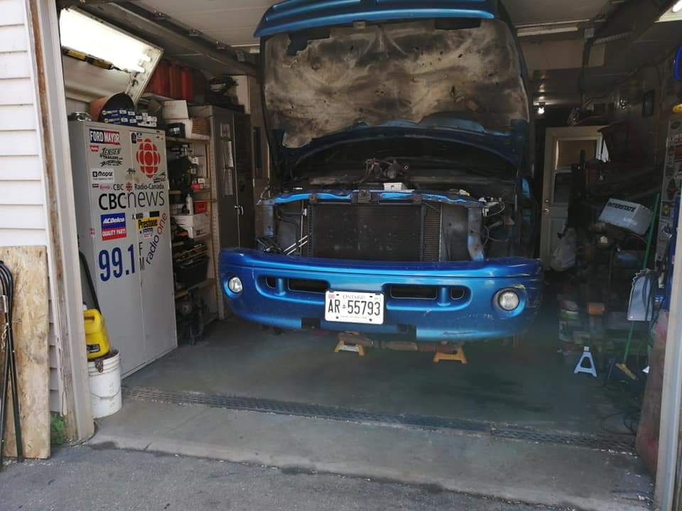

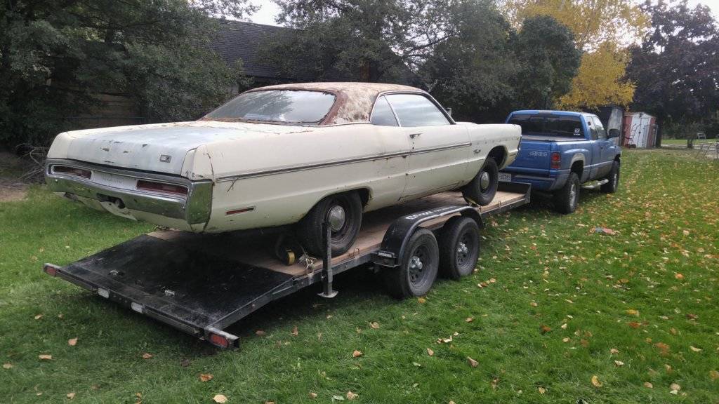

I wouldn't call my truck a beater....but anywho....
This truck has earned every right to receive some maintenance as I bought it for $400 off a customer of mine who bought it new and used it as his personal truck for its first 5 years before putting a plow on it and giving it to his guys to use at his golf course....
Despite pushing snow for 10 years it has been the most reliable truck I've had to date, having never once left me stranded. I've put over 55k on it in 2 years and it's never missed a beat.

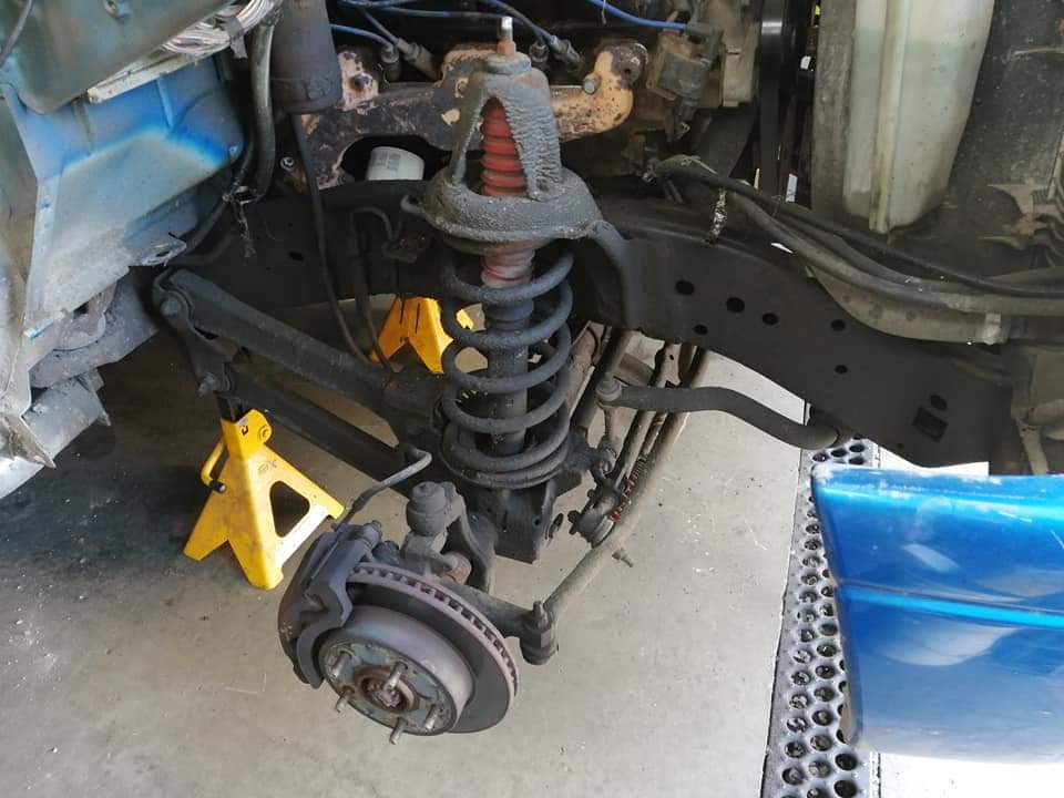

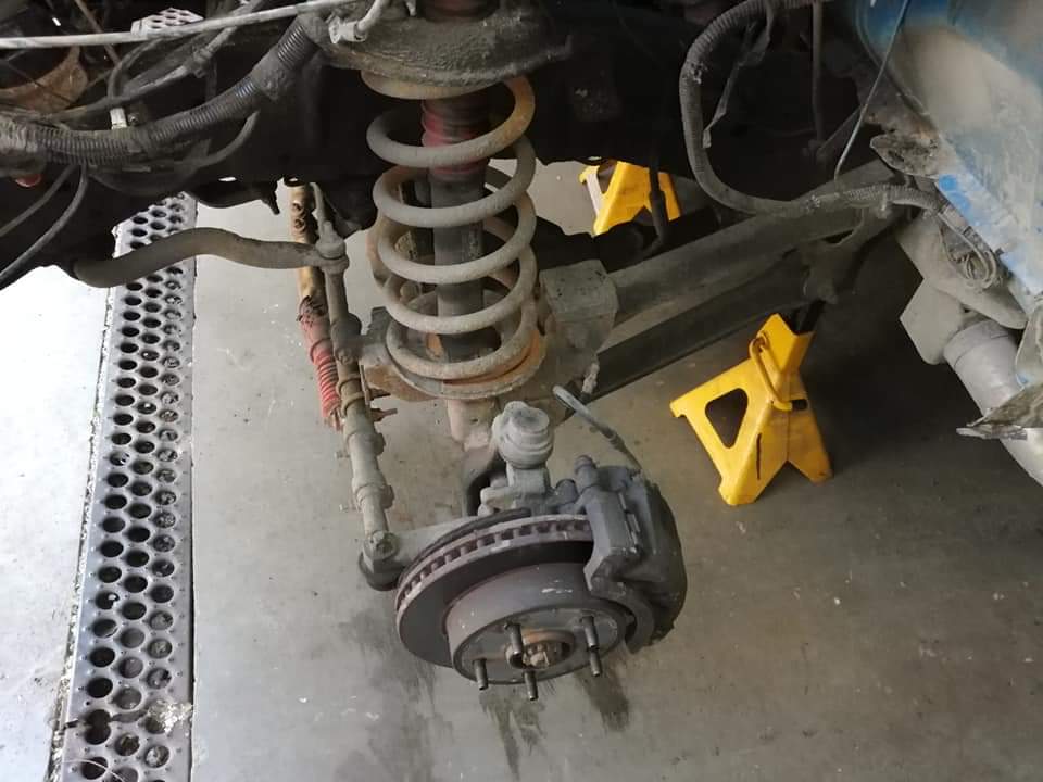

I'm just now replacing the original front end at 187k.
Damn! I got rid of a truck ('94) that had rust similar to that, all the way down the sides. Kudos to you and another example of why I need a welder.

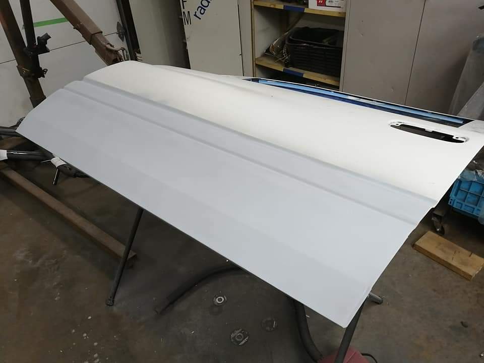

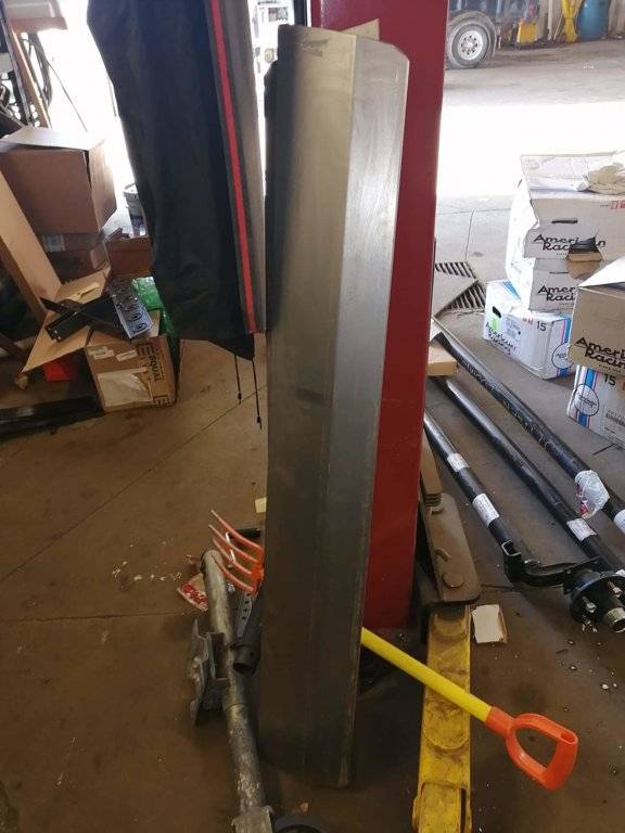

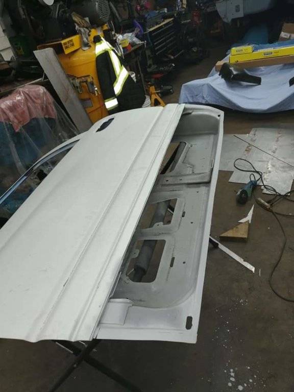

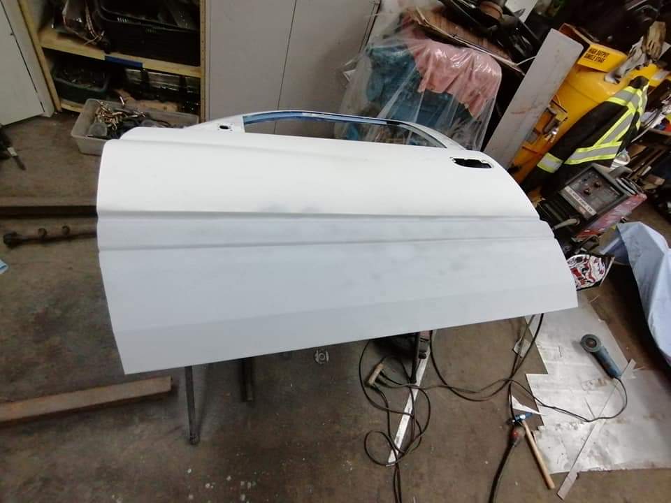

When I bought this truck I just wanted something for the winter and to haul my trailer. I first replaced the wheel lips on the box and the rear bumper. Then tacked new door bottoms on. I drove it for 2 years like that. Now I have rust free fenders painted and ready for it. I'm working on these doors and my buddy will paint them, and I also have another better front bumper and and new cab corners for it.
At the end of the day the truck owes me nothing and takes any and all abuse I give it.
At this point it has new tires (2 months ago), new pads and rotors (3 months ago), new shoes and I machined the drums (4 months ago),
New intake gaskets, rad hoses, thermostat, thermostat water neck, bypass hose, water pump, cap, rotor, plugs, wires (5 months ago)
New Pinion seal and rear service, new front service, new rear u-joints (6 months ago)
New-used T case (upgraded to a 3/4 ton 241D), new sway bar links, new-used exhaust manifolds, new-used steering box, new pitman arm, new-used steering shaft, Rancho shocks, skyjacker dual steering stablizer kit, both front hub/bearings (8 months ago)
New-used 46 RE (bought used, but turned out to be a rebuilt), new Cupro-nickel trans lines, trans service.
I've also changed the oil every 2k kms or 2 months since the day I bought it.

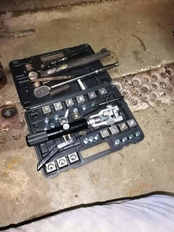

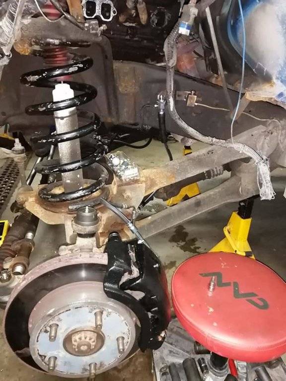

And I'm just finishing replacing the following; wheel cylinders, calipers, brake lines, brake hoses, front differential u-joints, all 4 tie-rods, sway bar bushings, Track bar, brake adjuster kits, brake hardware, parking brake cables. And I'll put the new fenders on too.

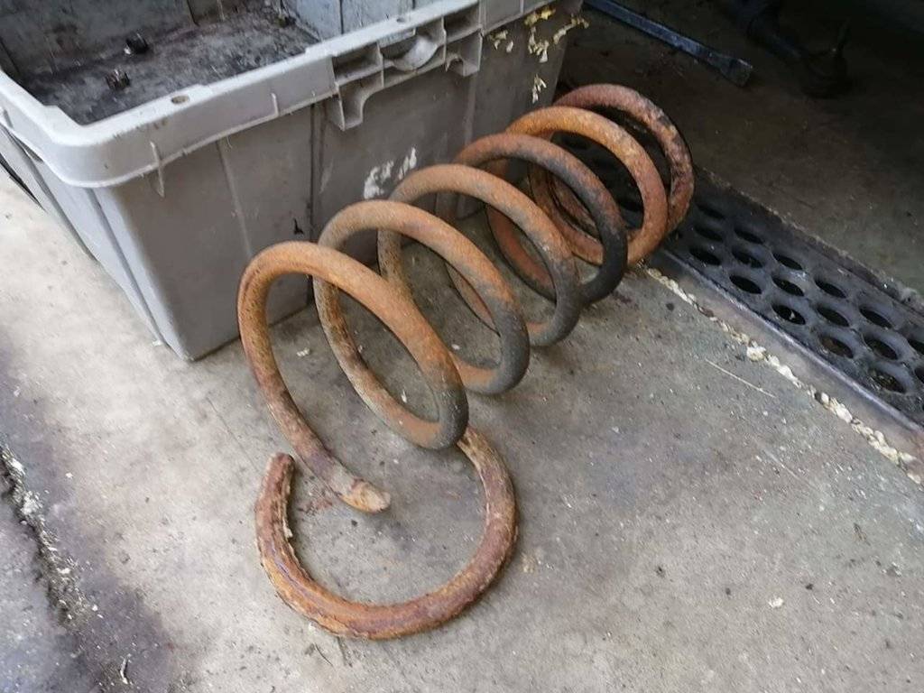

I'd love to pickup a Cummins D series, but for now until I buy my farm, the half ton is built like a 3/4 ton enough to keep it in its safe working limits. The front coils I just swapped in are from a 1 ton 4x4. I added 3 leafs out back also.

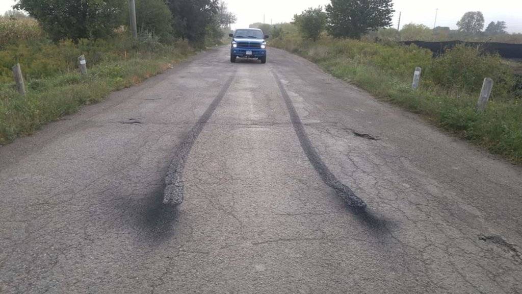

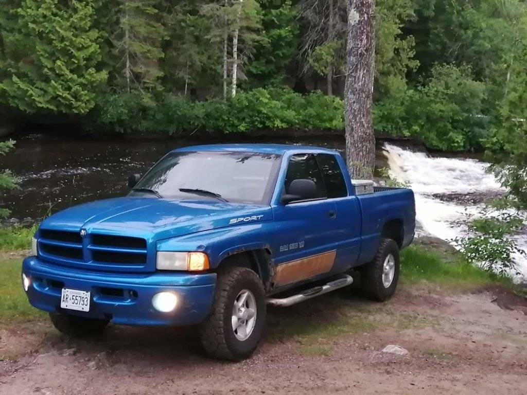

Few weeks ago when I took the picture with the rapids in the background was up an old logging road. My buddy wanted to walk up there, I said "why, we have my Ram", I popped it in 4 Hi and it climbed right through the soft ground without even batting an eye.
Scratches, scrapes, dents, dings, all badges of honor.

Never seen a broken front spring before...I have seen broken rear springs...sure hope you fixed yours.
Sounds like the springs on the weights are getting weak, or maybe one of them has come off it's mounting point?
