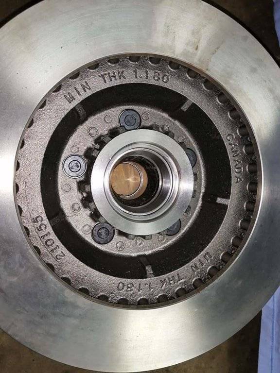

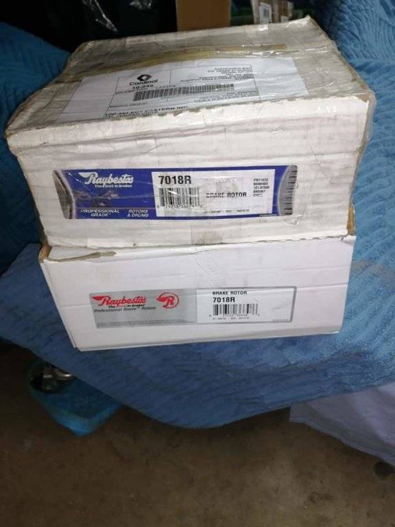

Ordered what I believe are all the additional parts for my drum to disc conversion. Tossed the idea around about using Dr Diff spindle sleeves, that way could of went with some Raybestos rotors for a '73 on up, but in the end, decided not to use the sleeves, and had to go with some Centric rotors from RA for pre -73. Same for the calipers. Oh well, she's only a cruiser on weekends, so hopefully the Centric stuff will be good enough. Removed all the years of rust off the spindles/backing plates and caliper brackets. They look good! Still have to get a different MC and looks like a booster maybe. I need to work some more overtime...omg! I ordered some new ball joints too. Will do all the work below on the conversion, then tackle stuff up top like the MC and booster.
RA was out of calipers, only had RF calipers by Centric, and only had Centric rotors for my year. I found plenty of RF calipers on ebay, etc, but only 1 LF caliper...anywhere!
Went with Timken bearings/seals, Raybestos pads. Tried to get better stuff where I could, but supplies are low now on these parts needed for a conversion.

So all my drum to disc parts shipped from RA and ebay this morning....everything in stock.
I'm running 15" Magnum 500 wheels. There is not a big cutout in these wheels. Wondering in you can actually see the calipers. Probably won't know until I mock them up, with wheels on. I was thinking about painting the calipers to match my body color, or maybe a shade of gold, maybe just silver...if you can actually see them. Decisions, decisions!!
