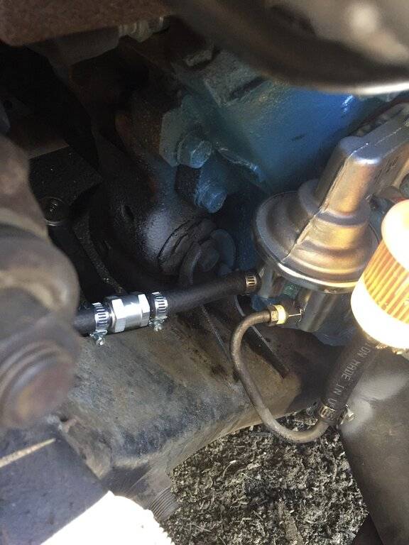

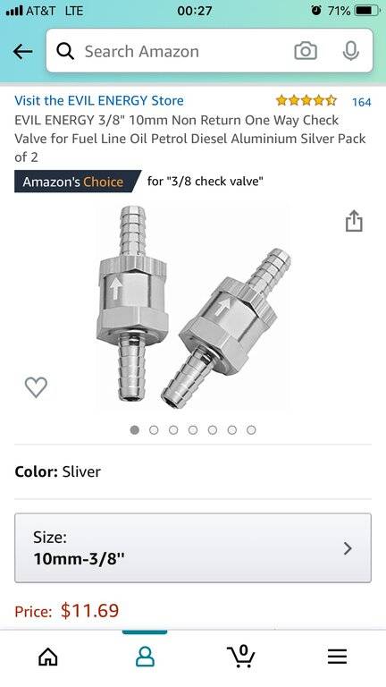

After installing the new Fuel pump / Fuel filter I was having issue with the fuel draining back to the tank. (PS) the car was parked on my inclined driveway, so I turned the car around so the tank was on the higher end thinking of gravity. Made very little difference.. Before the Pump / Filter change that would only happen when the car sat for a long period of time between Runs. After the new install it would happen overnight. So I installed a check valve just before the Pump. Problem solved. Don't know if there was an easier / another solution.
I'd be interested to hear your input.. Did I do the right thing? or is there a better way?
Talk to me..
