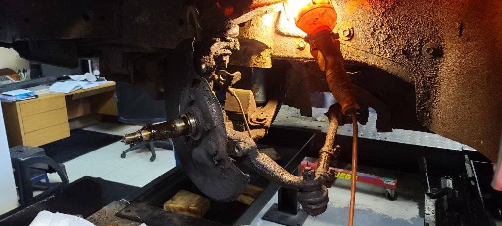

Yesterday I tore apart the driver's side suspension on my 66 300. Since the passenger side was a breeze, I was in a hurry to get it disassembled and pulled a complete bone head move. I backed off the torsion bar all the way but forgot to support the LCA and loosened the rear strut rod bolt before the front. Perfect storm situation. It twisted the hell out of the strut rod. Good new is there are about 200 rust free ones about 1/2 mile from my house. Desert Valley is pulling one for me as we speak. Take your time and follow the FSM to a T, guys!

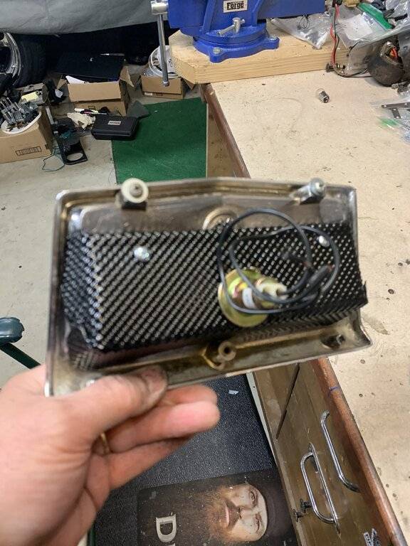

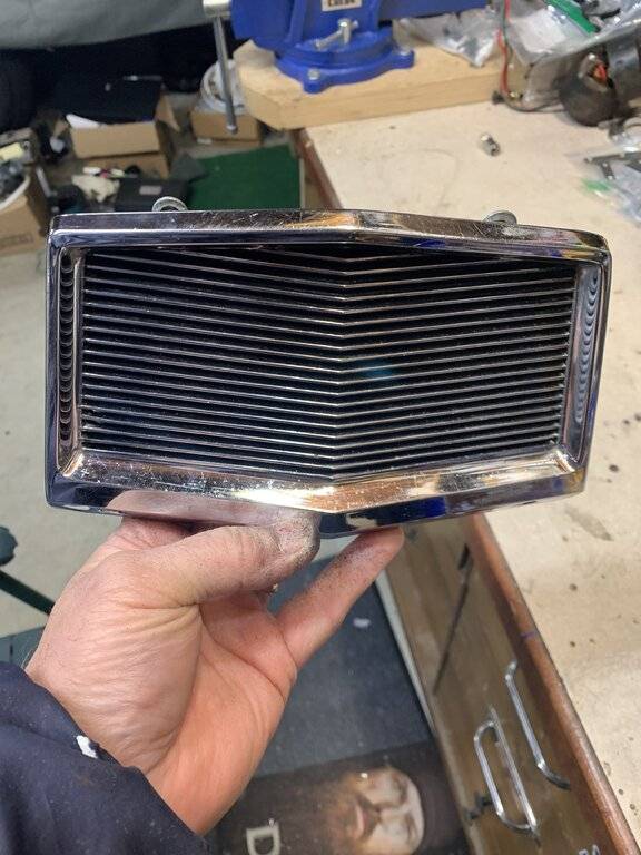

added the courtesy light option to my reproduction console end plate. Dremmel tool and some leftover metal stud material. last pic a little blurry. sorry

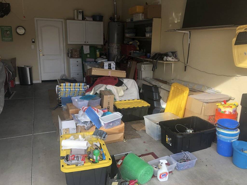

Sorted, repaired, painted, restored/repacked parts for restoration of 65 S.Fury which I pulled and took to second shop after a two year nightmare which was suppose to take two years. Resanding for repaint starts tomorrow!

I remember reading on several places you could jack the car up on the LCAs and as a result did not need to back out the bolt for the torsion bar adjustment. Granted, if you were actually changing the LCA (or at least the bushings) you probably could (or just have to remove the entire K-frame anyways), but for spindles I've heard that method works just fine.

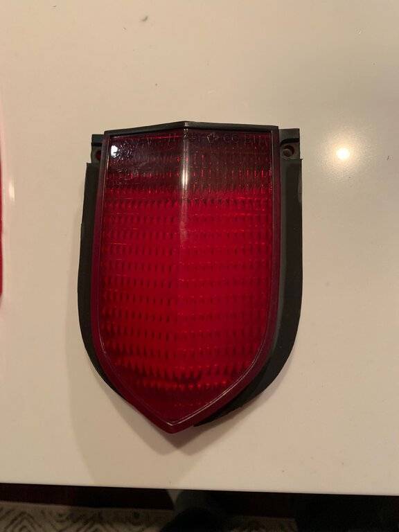

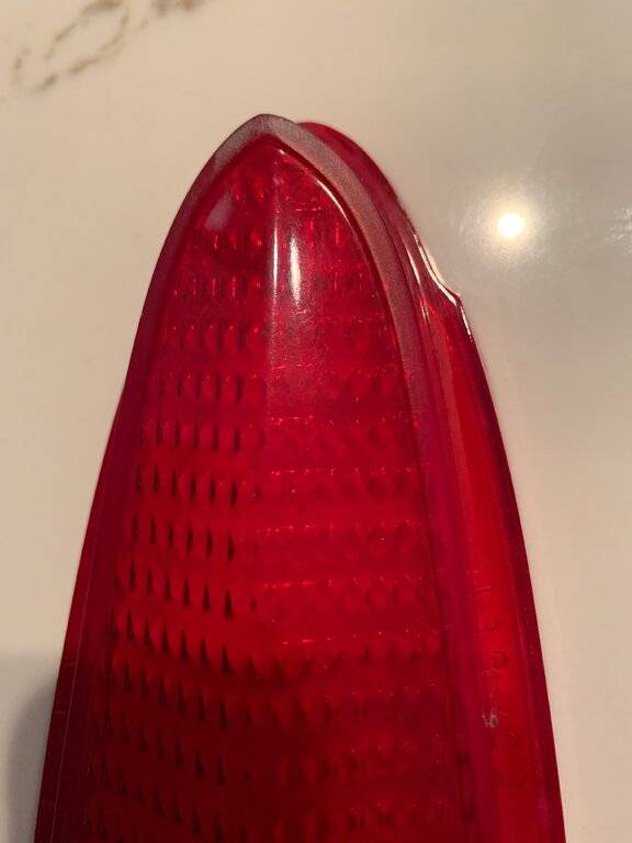

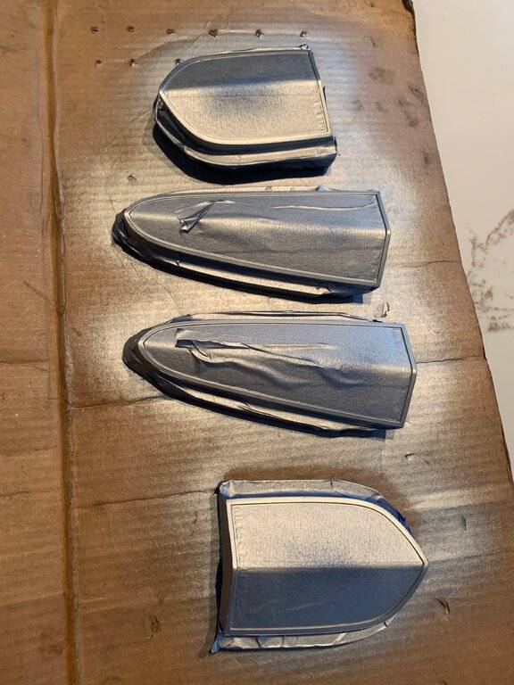

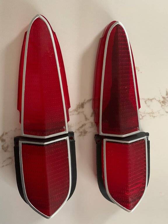

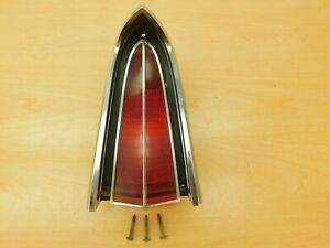

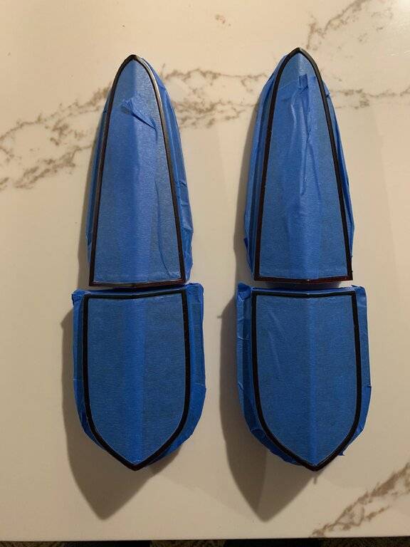

Since the NY weather has been so crappy, and I'd sent the taillight bezels out to be chromed, thought i'd mess around with the lenses on the 77. I saw pictures of some other New Yorkers (First pic) and noticed that the leading edges of the lenses were painted silver / argent. I like the look so I did to mine. Some, not all the pics I saw also had the center of the lenses painted, I didn't like the look, so I didn't. Turned out nice I Think. At closer look though, I think they were painted in a chrome not silver, Im happy with the silver though..
That's a nice accent.

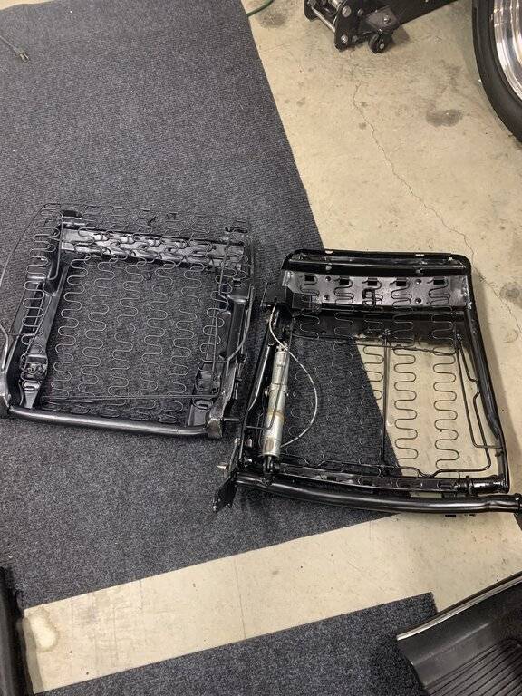

Finished de-mousing some seat frames prior to re-upholstery. Found 2 little skeletons.

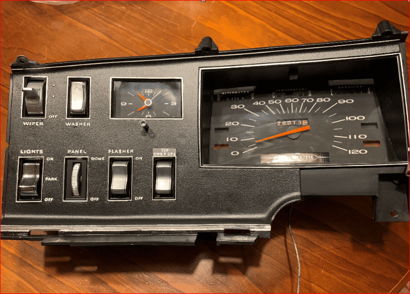

Finished my dash cluster with voltmeter instead of ammeter. I almost had the clock working but then not so much. Another day.
Looking good!
Regarding the clock, there are quartz conversion kits for them. I have done 3. The stock points / spring setup wears out, but can be reconditioned (filing the points, rewinding the coil, etc.).

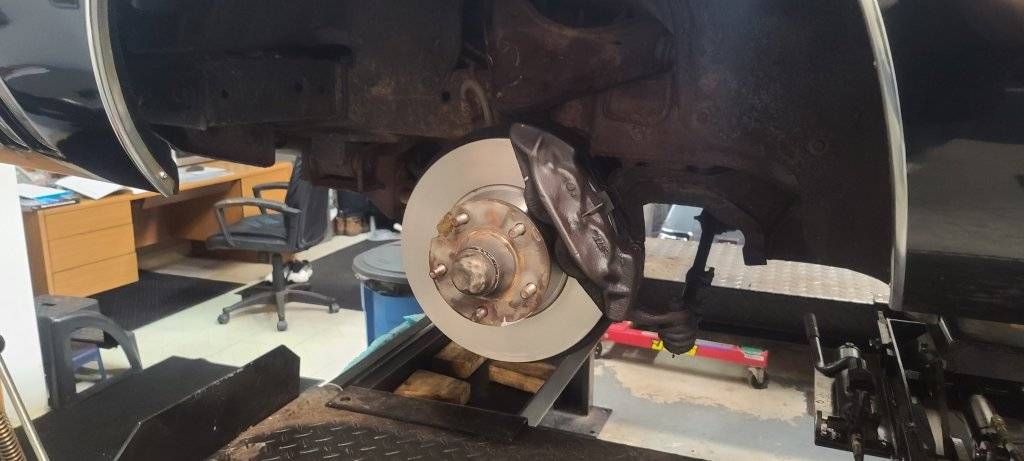

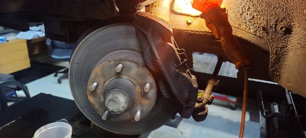

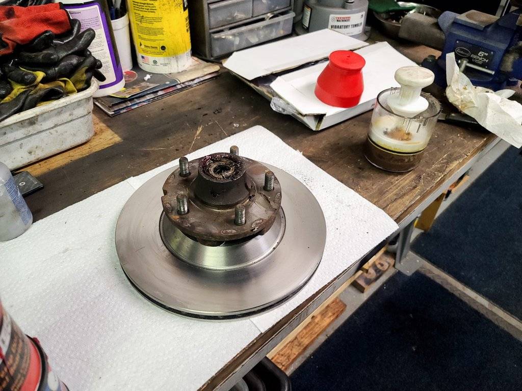

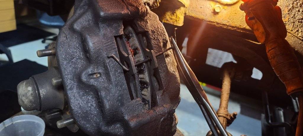

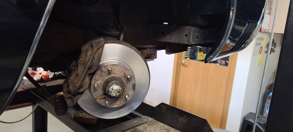

Last week the Budd brake spring clamps arrived from @detmatt for the 69 Imperial. Thanks again!

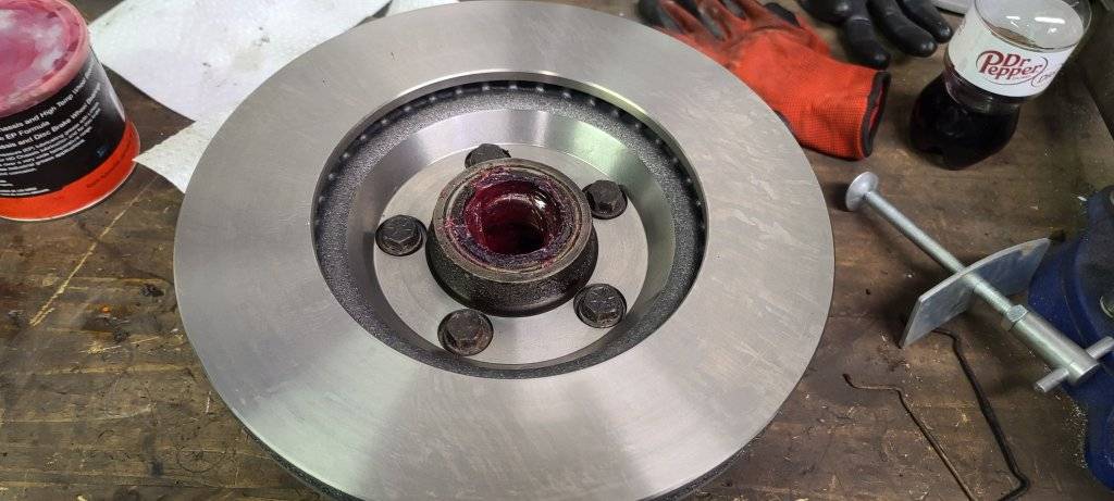

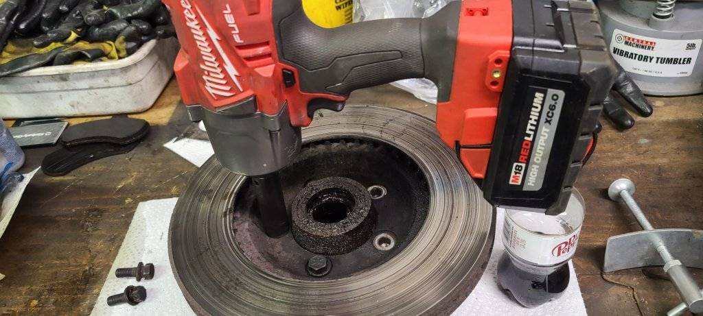

After learning the rotors were available through several sources when @Mr C replied to a post in the Carlisle 2021 thread, the front rotors were scored last year through a contact of @Xenon. With everything needed been gathered, it was time to go to work.
View attachment 517639View attachment 517640View attachment 517641View attachment 517642View attachment 517643View attachment 517644View attachment 517646View attachment 517647View attachment 517648View attachment 517649
No worries going down steep grades in PA anymore!

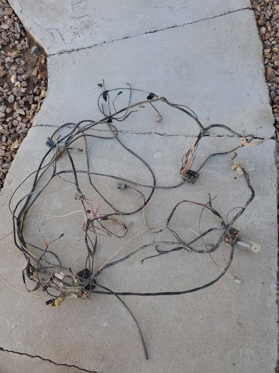

Printed labels for the new/ old harness connections. Starting the process of checking fitment and getting a new one made.
