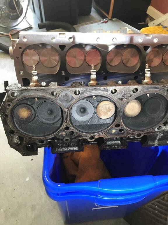

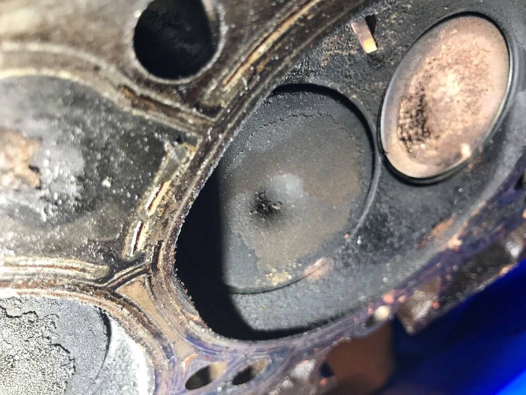

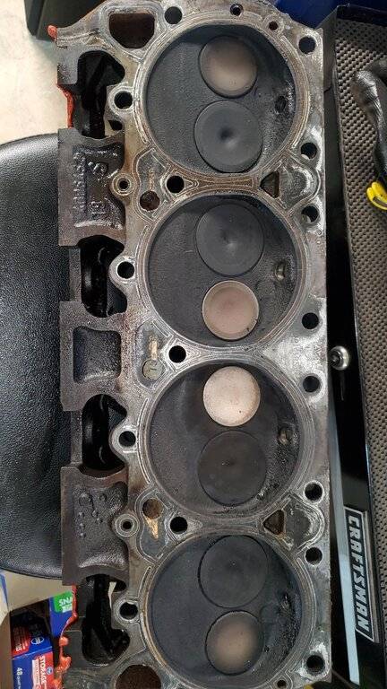

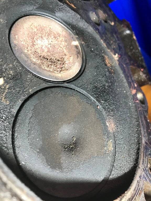

My question is simple enough I guess. My heads do need a valve job at the least. At what point should I look at getting new heads? These are 452 Iron Heads for a 400 Big Block btw.

A valve job with new valves and bronze guides installed will run in the neighborhood of $600-$800 depending on where you have it done and if new hard seats are needed. The 452 heads have induction hardened valve seats, sometimes these wear thru from use or valve grinding. If that is the case, you will be looking at about the $800 figure. The 400 is a low compression smog engine, so it is not going to be cost effective to add after market aluminum heads unless the engine is being rebuilt with higher compression pistons. If the car is a daily driver and not destined for a performance update, rebuild you existing heads and call it good.

If they were in good shape when taken off they should be able to be freshened for not too much $. Have a shop look at them. If they tell you they need everything without taking them apart, find another shop.
Edit: the seats on 452 castings are true induction harden seats, very deep into the iron not like the surface harding in previous heads. Beware the shop that tells you they will need changed.
I have a set on my Charger (68k miles on them) all I did was, measure the guides/stems, grind the lip off the stock valves and lap them in. The car never uses a quart of oil in the whole season of fair weather driving. ~10k in 4 years, I change it every spring.

Well, I called around a couple more machine shops. I found one that has a 1 week turn around on heads and runs around $400 per head to have them refreshed. So for $800 I can have these 452 refinsihed. I think I might just go that route. It will save a few hundred bucks and if I am not going to gain much by going to aftermarket heads, why not just refresh these right?
