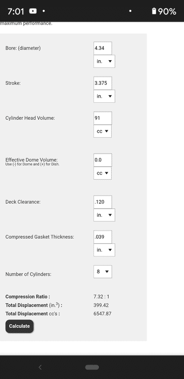

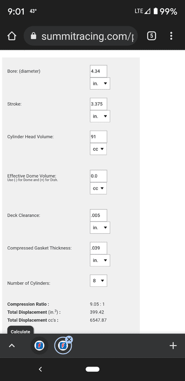

Here is a example of the difficultly in building some compression in these.
This is basically using a flat top piston with no valve reliefs at .005 down in the cylinder, a felpro style gasket and a informed average of the CC's that uncut 452 heads usually have. Just barely making 9:1.
@Davea Lux if I found a .090 in the hole 400 that would be a good one. Probably a 72-73 magnum/HP version.

Here is your engine give or take a few ten thousandths on the deck measurement.
Good news is no need to pay for premium gas, it will run on any swill you can get to lite.

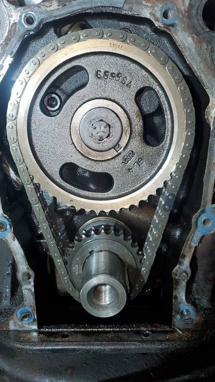

I am really curious about this. I would do this via the timing gear?
You can advance 4° using the keyways, one is advanced, one straight up and the other is 4°retarded.
Done correctly you need a degree wheel, cheap one at Summit works good you just need to fab something toake sure it does not slip, or mark it to indicate slippage.
For fine tuning you need a offset dowel pin kit. You drill the pin hole in top gear and use eccentrics to change relationship. There is also a expensive timing chain out there with 9 different keyways in it. Once you get the hole drilled in the top gear (drill press recommended) it is not a big deal to change the timing. There are a million videos on YouTube about degreeing a cam so you can sort that out. 2 degrees or less will have no effect. Advance only with low compression to build cylinder pressure by closing the intake valve earlier after BDC.
Btw is that a new chain or the one that came out. Very tight if used, it a good one.

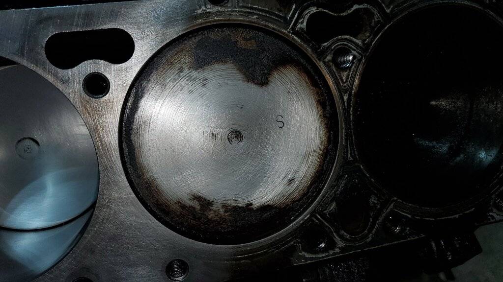

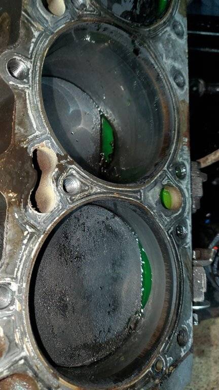

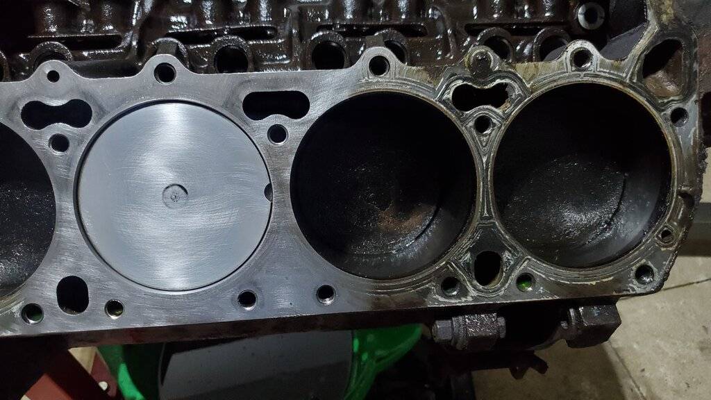

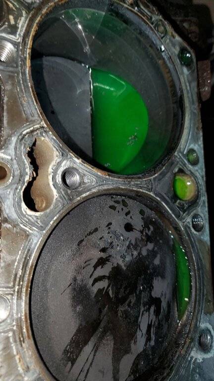

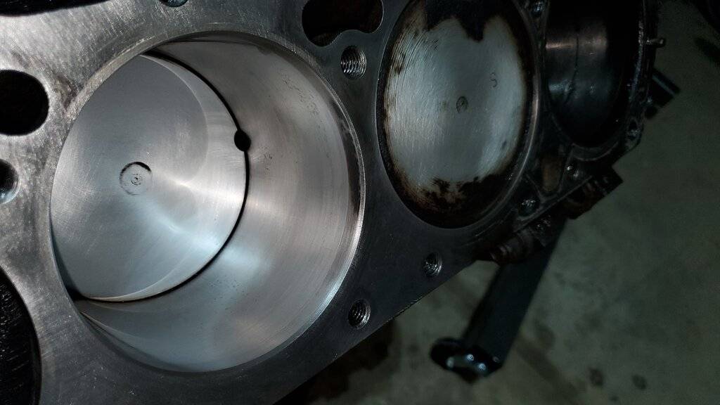

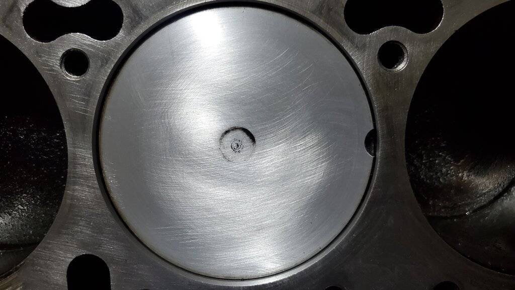

Since that are being worked on, I went ahead and got the block out today. I also cleaned up a piston and cylinder using a Scotch-Brite Scouring Pad and some WD40. Below are those pics. Anybody see anything that I should pay more attention to on here? How does it look to you?
