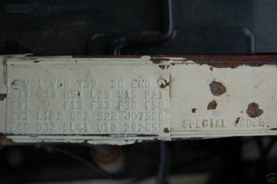

26 end .....looks like your car only has the one tag...its been my experience that the 26 end is basicly end of the line.....
yes l realize that..is why a good pic of broadcast sheet would help eliminate the assumptions...lve still got a lot to learn to...is why lm here :O}
OK... I was pointing out that one shouldn't expect a 2nd tag with option codes on it when the codes stop half way through the fifth line of the tag. You could expect a 2nd tag regardless with special Handling, Special mask, special paint or all three
similar to this car ....

Hard to read but it looks like the VIN on your broadcast sheet is PE29K1F? That would be Plymouth, Economy, Sport Top, 360, 71, Newark NJ. If the 7th digit is E, that would be LA. Don't know LA built Fury's in 71.
Your's seems more consistant with police cars, Plymouth, Medium, 4 Door Sdn., 440 HP, 71, Newark.
