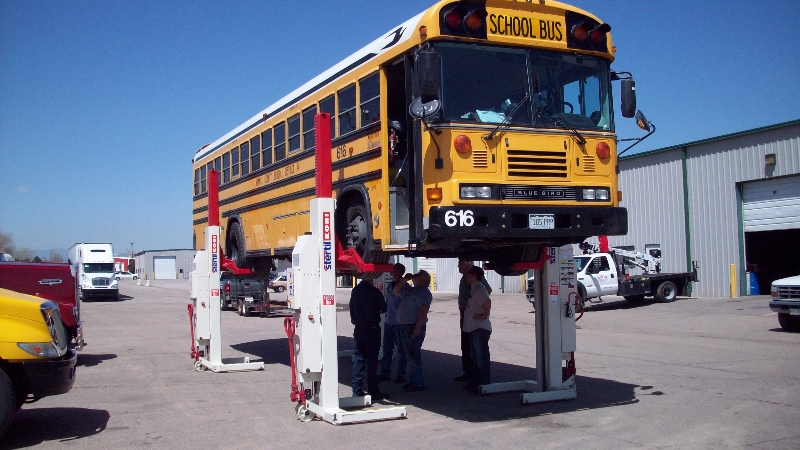

Has anybody used a truck/bus lift like this?![]()
Those intimidate me just a little, but my neighbor, who is a retired utility co tech, says he loved them. Some designs have interconnecting hoses to raise level, but if you had one lock fail... I could see this getting ugly quick. Thats like 6 NYB's in weight empty.
Four pallet hi-lift hand jacks? Are you kidding me?That bus lift looks scary to me....
