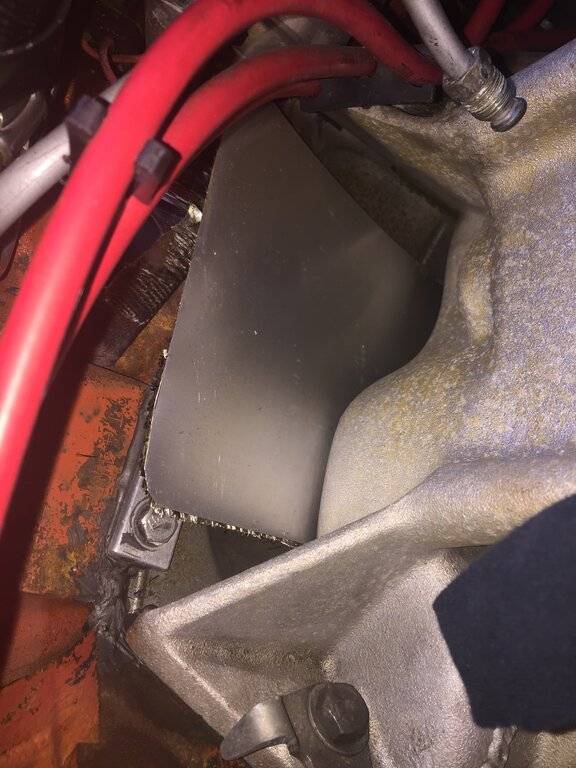

I realized today that I don’t like my wagon.
OK, and how did you measure it?
And what do you exactly mean by "insert plate"?
With infrared thermometer. This is the original
And this is my version. I pulled it out from the valley to get this pic. Underside has fiberglass.

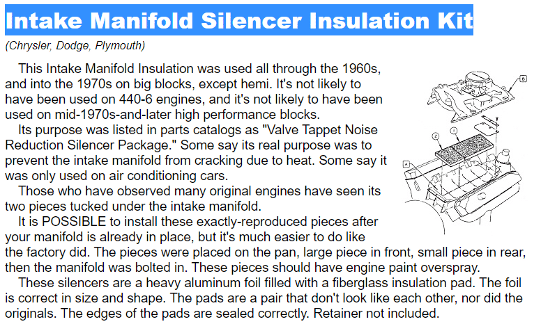

Very good.
Usually when I say "did you measure it?" followed by "how?", it turns out they never did anything and it's all seat of the pants, feel good, nonsensical BS.
So, kudos for actually taking a measurement... and kudos for saying "infrared thermometer" as a lot of guys think that the red laser pointer is what is doing the measurement.
Of course, I still go with the pad is there to quiet the engine down... and I have pulled them off engines from cars with no A/C, so there's that. :poke:
