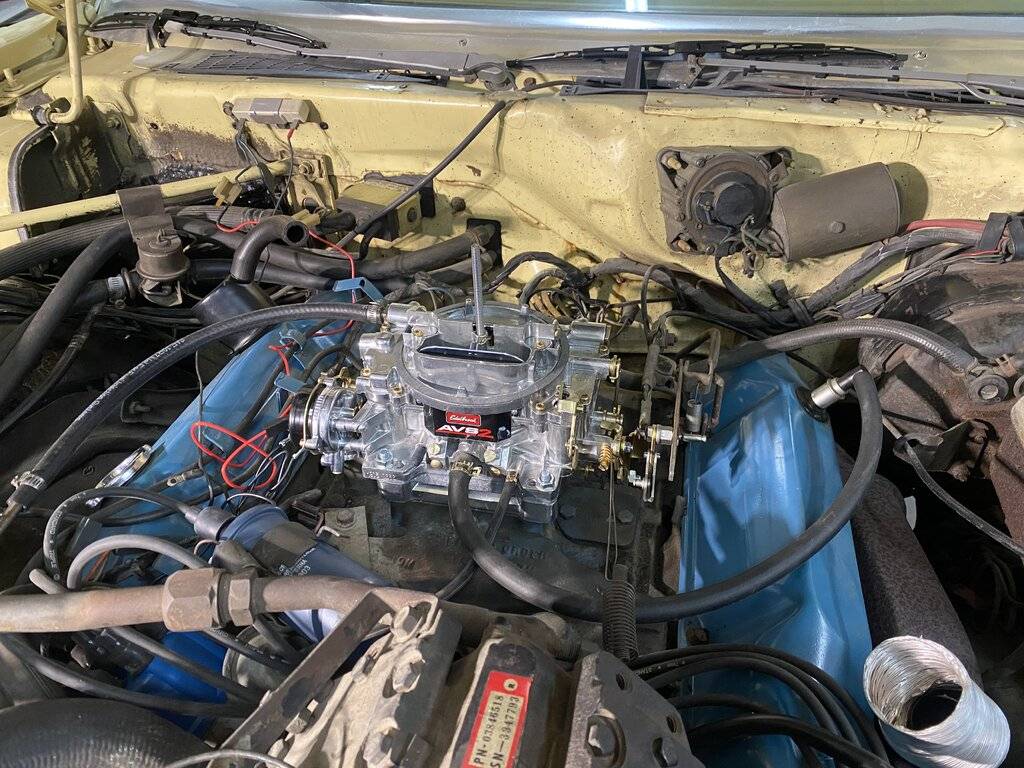

It’s in. It starts. Starts hot with just the turn of a key. Like fuel injection. This might be my new fave. Finally.
I counted 12 professions carb rebuilds I’ve done to cars now - all successful - and this is the first I had to toss. This is the first time I had to convert to a modem carb. Damn. I guess I’ll sell it somewhere. Basically a new TQ. Somebody should get something out of it.
accelerator cable and factory air cleaner all fit. Didn’t Like how the cruise control fit so I didn’t connect it yet. Doesn’t work anyway!

View attachment 424566 It’s in. It starts. Starts hot with just the turn of a key. Like fuel injection. This might be my new fave. Finally.
