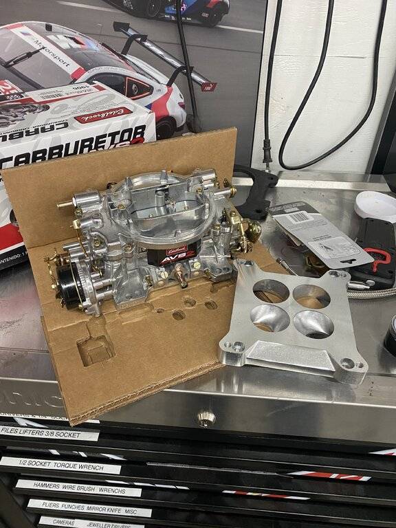

took the carb off today and the intake was coated in raw fuel. Ordering an Eddy tonight. I’m going to copy and paste what 78Brougham did with a 1406.

Called Edelbrock. They recommended the 1906 as the newer version of the 1406. I got all I need, I just need to be there to install!
I’ll get it installed before Xmas. Next weekend. It will be really weird if it starts starting when I turn the key! Won’t feel right without lots of pedaling and cranking.

My personal experience with Eddys is that the later ones weren't as responsive as the earlier ones from maybe 10 years ago, possibly from leaning them out over time to help pass smog check emission tests when using them. The usual way in the past to make sure off-idle and low speed accelerations felt strong was to richen up the fuel flow curves beyond what should be theoretically needed and just let the fuel dump into the intake manifold hot spot (due to hot exhaust crossover flow) and let the fuel vaporize well that way and give good throttle response. But some guys also like to block off the crossover without thinking of the other consequences. One way around this is to more finely atomize the fuel when coming out of the venturis of the carburetor so reliance on a hot spot or good fuel delivery from supplying more fuel than the engine really uses well is needed - and that is what better atomization of the fuel in the carburetor venturis achieves. I would definitely welcome the new AVS2 carburetors.
I don't see a bowl vent on the carb you bought, which would have definitely helped any hot fuel from going into the engine but maybe they don't offer one. But hot start fuel vapors from a properly performing carburetor probably shouldn't be an issue unless you lived in a state that has really high summer temperatures like California or Arizona/Nevada - you don't since you live in New York.
Does the AVS2 carb require use of that spacer plate? It seems pretty thick which makes me wonder about fitment issues/hood clearance and carburetor to manifold gasket issues and or throttle geometry issues - but that must have been thought through by Edelbrock I would expect?
Also, that carburetor doesn't utilize the original choke set up of the Chrysler system, so how does it sense heat to control choke control as the engine heats up? My Forwardlook cars utilize that kind of choke set up but they also have a heat pipe from the exhaust manifold transmitting heat to those circular type control units.
One last thought, did you also purchase the adaptor that is needed for an Edelbrock carburetor throttle lever to adapt to a Chrysler throttle cable ? That might be what one of the packages I see in your photo contains - just checking of things to think of before you start the install so you don't get frustrated. :thumbsup:

The carb has an electric choke.

The spacer is a beast. I has the rear flared out to match the opening from the TQ. I am expecting it will fit under there with the stock air cleaner, otherwise, we will be going with a low rise aftermarket air cleaner. Electric choke looks simple enough. I have put them on other cars.
