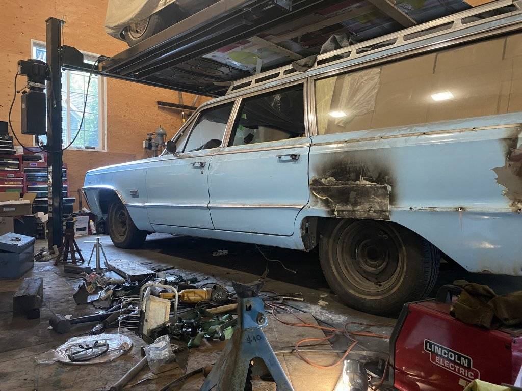

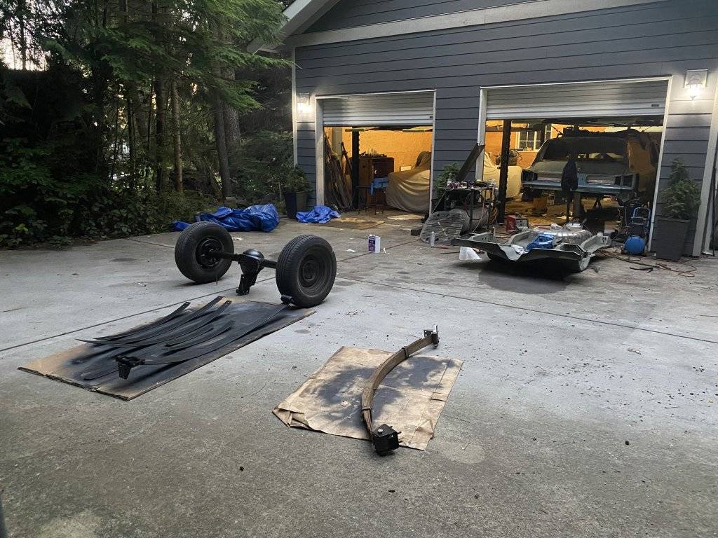

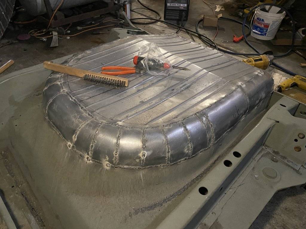

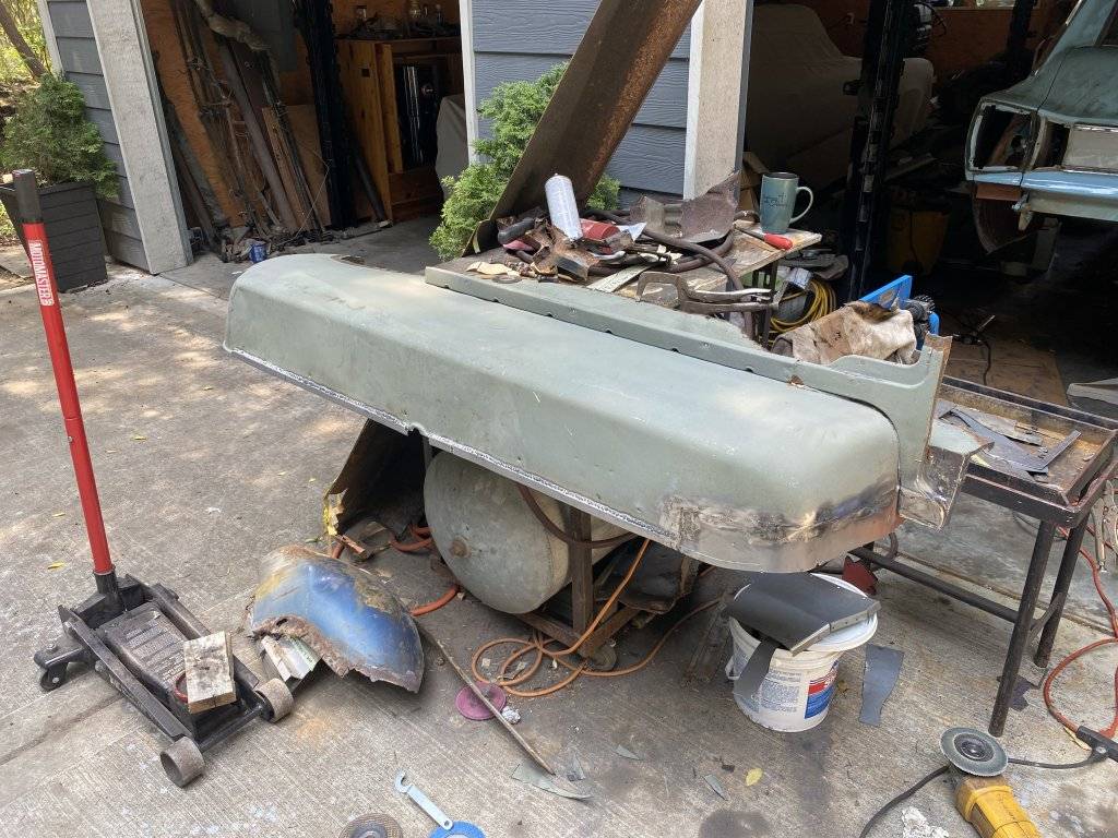

Parts painted, missing tub fabricated, tub welded in.
Tub took a lot of tucking, trimming, tweaking and swearing. Not perfect, but better than what was there when i started.

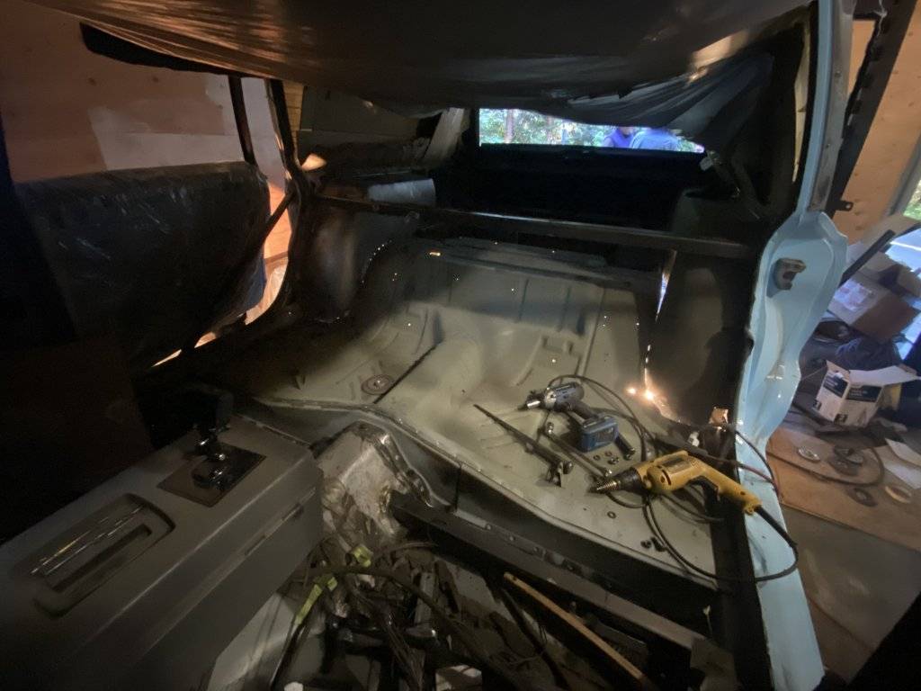

Getting there. It's almost 300 inches of welding on that footwell. **** me.

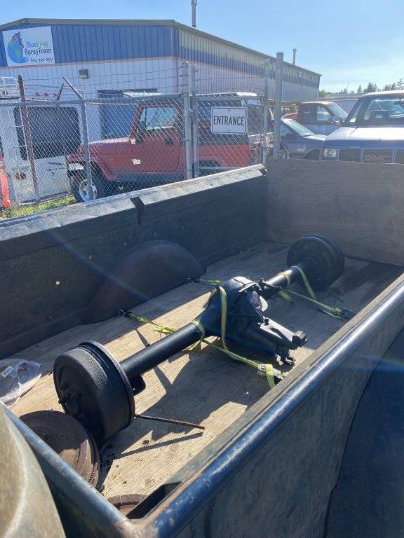

Also getting my diff back was a huge ordeal. Bodyshop guy is my friend but man is he unreliable. I was to pick it up friday but got delayed, and it turns out this week he went on an unnaounced vacation to the moon without telling anyone. Even though he told me last week that his vacation was in september. Had to track down the landlord of the building to get into the yard to pick up my stuff.

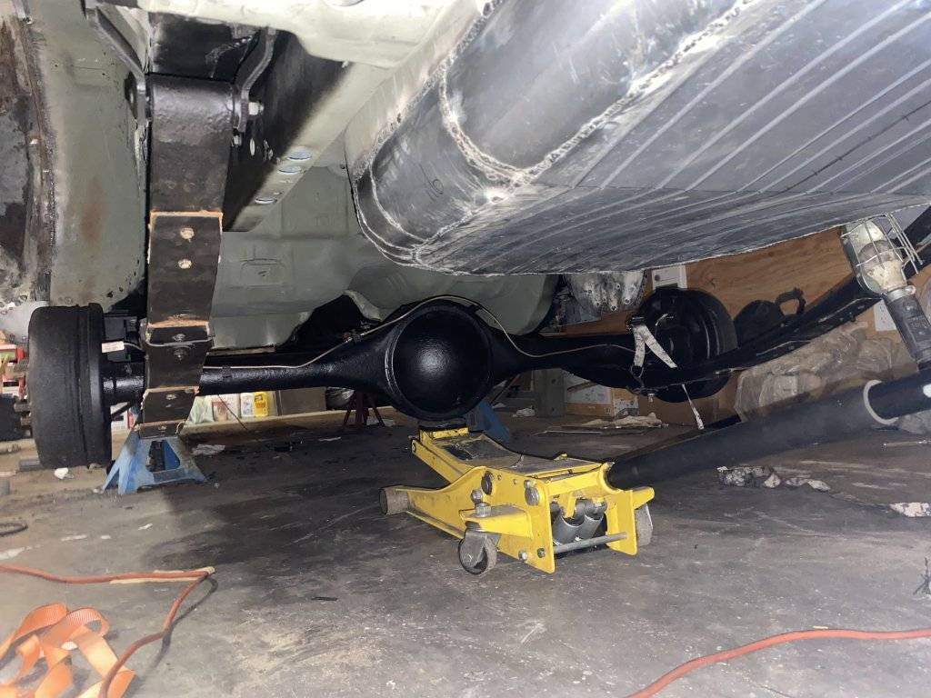

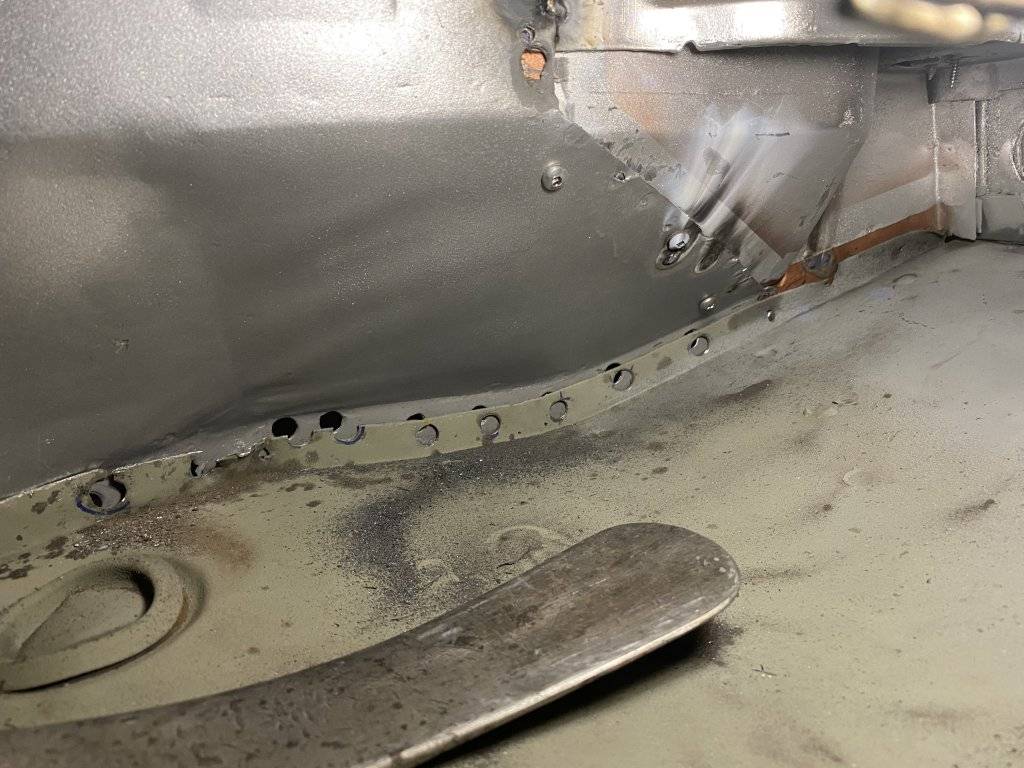

Floor's done. Braced the rockers totally, started cutting out the very last of the floor.
I intended to finish this smooth, but frankly at this point i want the world to see the 12 hours of welding i put into this thing. 23-1/2 feet of it.
Also the posi in the rear end is incredibly good. Even with my full bodyweight against one wheel I still can't get the posi to slip at all. Must have been rebuilt at some point, no way it's 60 years old.

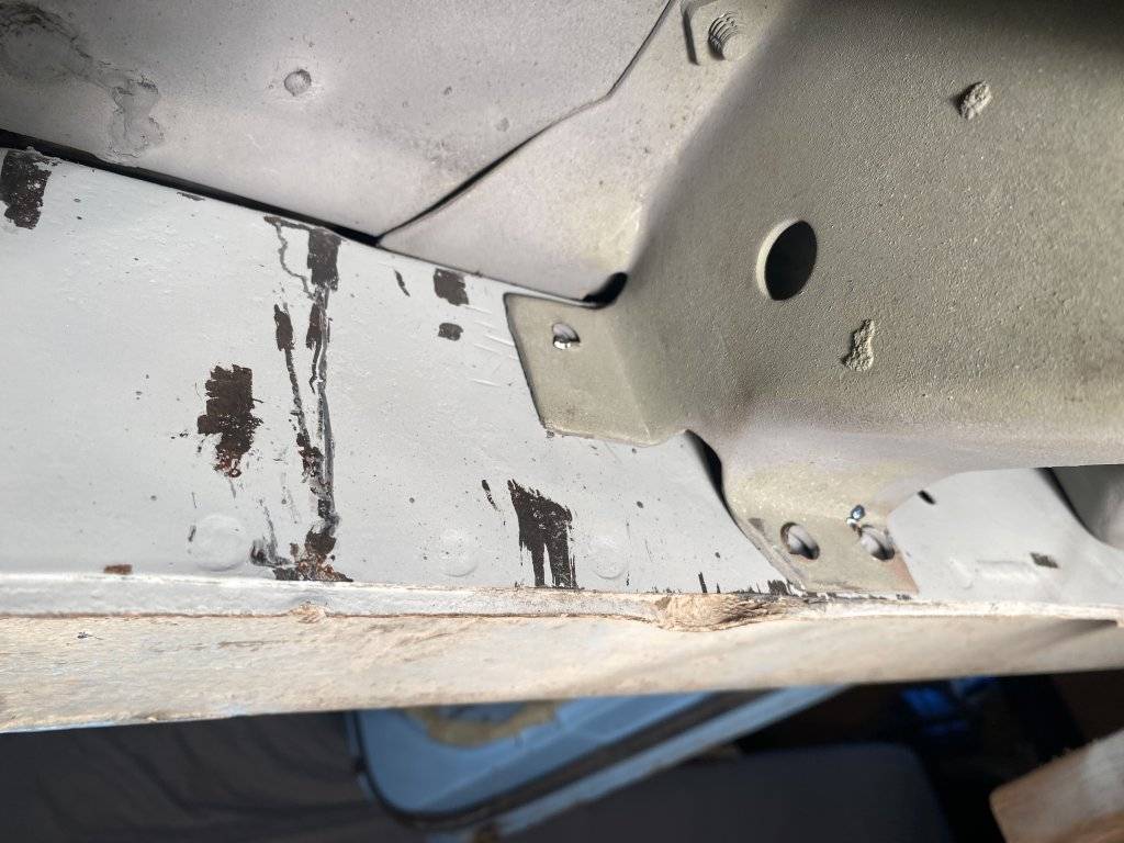

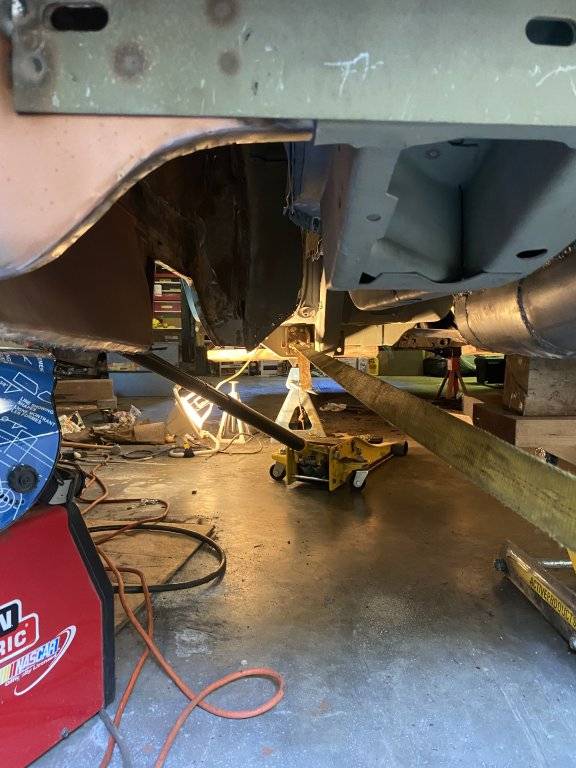

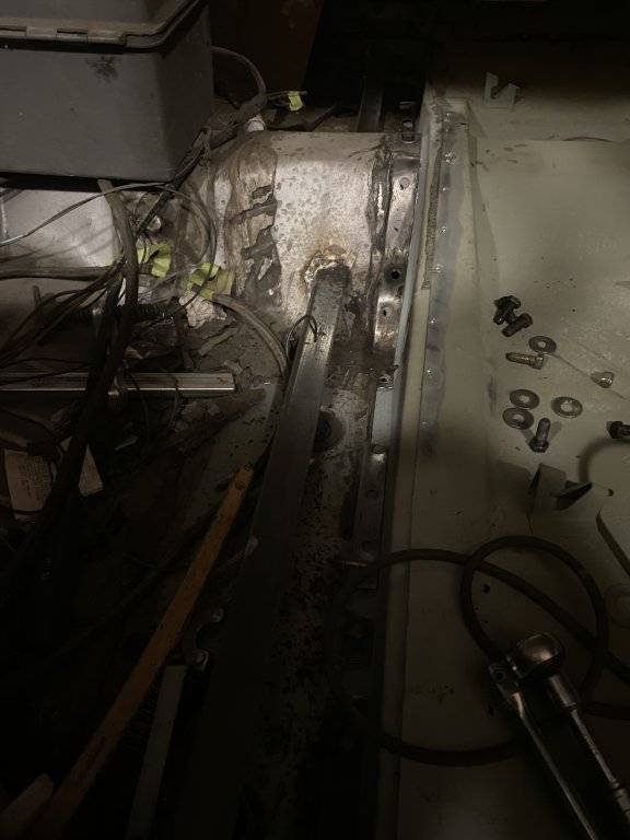

The driver's side bracket that sits in the rocker is about 3/8" forward. However, the other side, and every other important mating surface is exactly correct.
You can see how close the original weld locations are to each other. Both tubs, front and rear locating surfaces. Plus the rear tailgate sill panel is completely maxed out, pressing up against the back uniformly all the way across. All Agree exactly, except for that one bracket.
I ran the alignment test. E and F disagree by half an inch. 70" to 70.5". Shop manual says 1/4" is the tolerance.
I tried everything to try and pry it back but there just isn't much to bite on, plus it's maxxed out in the back, no room to budge. I have absolutely no idea where this discrepancy is coming from, it seems entirely localized to that one single bracket.
The only thing I can think to try is parking the rover behind the car and using a ratchet strap to pull the leaf spring pad forward. Either it works, I pull the car off the rack, or it does nothing. Assuming nobody dies, if it doesn't work I think i'll just weld it in tomorrow regardless, and adjust the leaf spring pad with a shim once I can measure the wheelbase.
Iunno.
Also got hit with the third noise complaint in the last two weeks for working on the car too much. Philistines.
Good idea? Hell no. Best idea? Yup.
Got the alignment test to exactly 70-1/2" on both sides on E/F, within 1/16". I can weld it in guiltlessly now. Whole car moved forward 1/2" on the jackstands. Probably the sketchiest thing i've ever done.
Now to roll around underneath it welding **** and hopefully it doesn't all come crashing down. 6 Days remain....

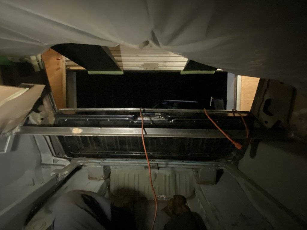

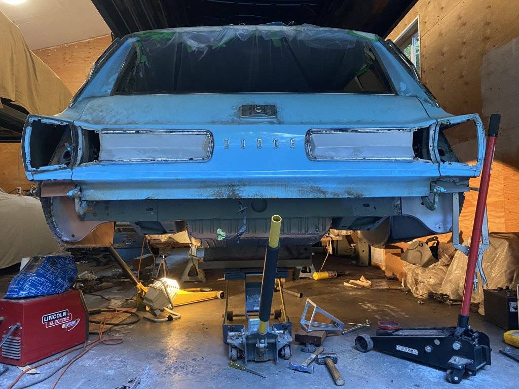

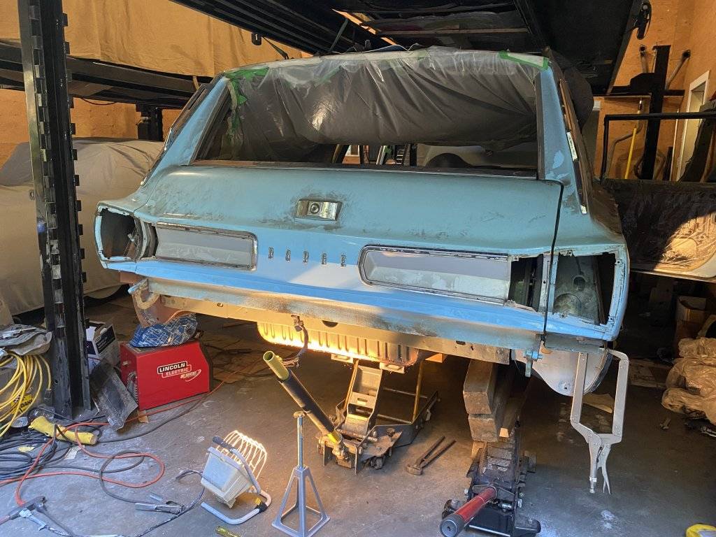

Also turns out it was that bodyshop to blame once again. Now the floor's in position the rear flange is bent up against that angle iron still floor the body shop made. Gonna trim the flange down and call it good.

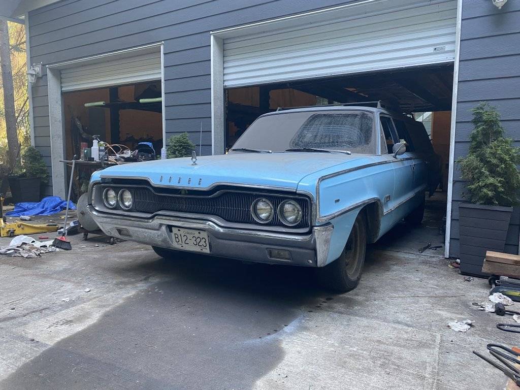

She ain't winnin' pebble beach, that's for sure. But she'll be waaaaaaay better than she ever was.
So I trimmed the tang off the back and it fit better, but it was still low...
Turns out that angle iron isn't even remotely square, and bends down at about a 3 degree angle on the driver's side.
The ride never ******* ends.
I have to take it out from the top, which is what i was going to do anyway. Can't do anything until the car is on the ground and I can get the tailgate open again, as that angle iron is also the tailgate sill now. My solution is to tack it in place in a few easy to reach spots. The actual sill is bearing the weight of the car as it should, just not fully welded in. It's tied in enough to take lateral load as well.
Is it good? God no.
Is it good enough to just putter around for the rest of the summer? Not really Yes!
I'll tear into it this winter, pull out the entire sill face and make it from scratch, and make it properly with the donor's drip tray in there too. But until then it's good enough. I just want to drive the stupid car man.

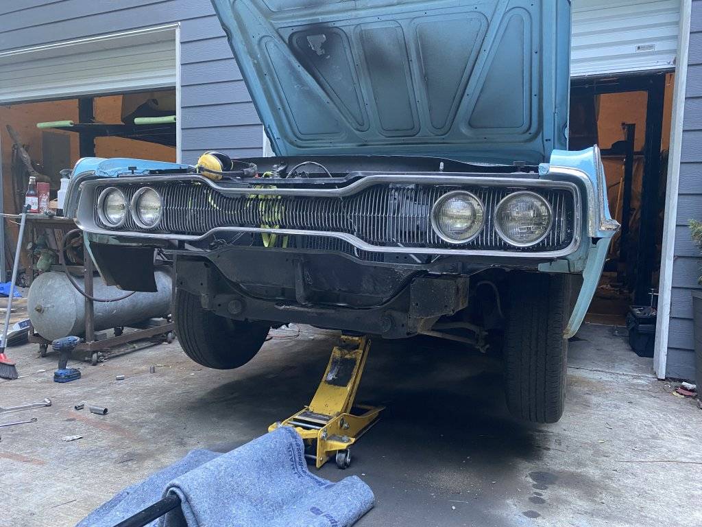

Tomorrow she'll be back on the ground, turn it, and start pulling the front end off. I can pull the front end and motor off my truck and have it back on in a day, I think I can do it here in five.
