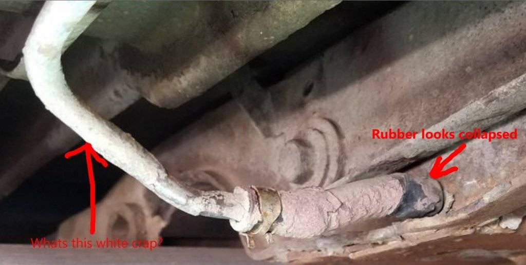

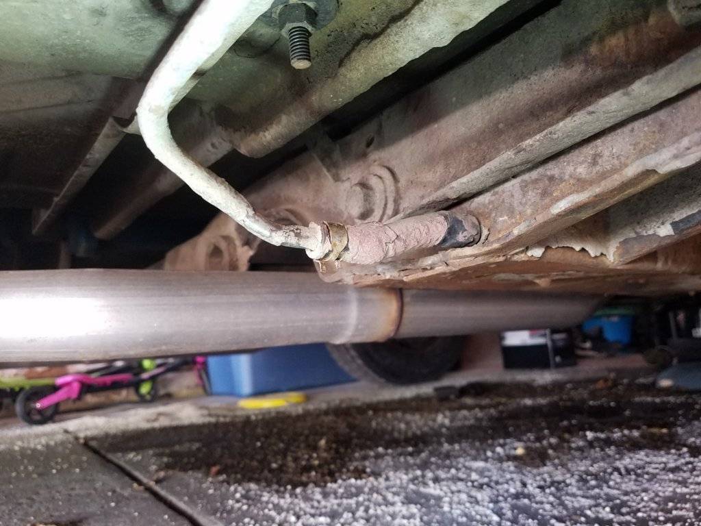

And here's how they ran the rubber fuel line. It was so bad that it easily could have been getting air in the line

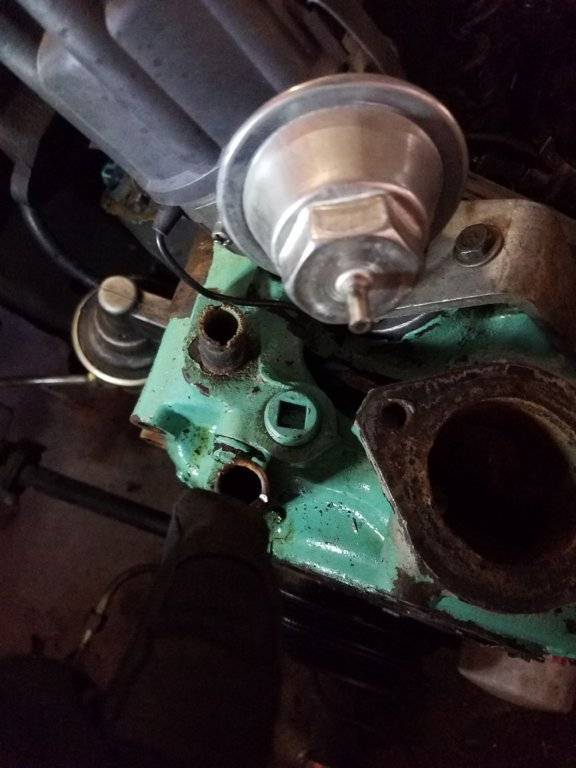

Is there a tool to take this off? It's where the heater hoses connects bc I want to remove the water housing also. Figure everything is getting new gaskets if the block isn't warped.
68 I haven't a clue to what the white stuff is, all I know is I'm repairing the fuel line
I'd put a new rubber line through your sub frame, old stale gas can turn rubber into jello.
Tool for Distributor? If your talking about the large hex on the vacuum advance, means nothing the whole unit comes off the distributor via 2 small screws into side of distributor.
Oh wait is that your gloved finger pointing to the heater hose nipple?
If it is, no real need to remove them unless they are corroded through. Then I would get a Oxy/Acel torch with a proper heating tip on the cast iron to free them up. GOOD LUCK kind of thing.
68, yes I mean the heater hoses part, is the only way to get it off is with a torch ? I need it off to remove the nut behind it to remove the water pump housing
Well their very rarely get removed and it is in the coolant section sooooo...
I appears that with the 2 screwdriver like notches that it would un-screw like a scew, good luck.
Now if you had a special notched like socket that fit tightly over the nipple maybe, but I've never seen one.
Heat up the cast iron red hot and use vice grips, if it's old fragile/corroded, better have a new one to put in, and also chase out the threads (pipe). Use tape or pipe goo on reinstall.

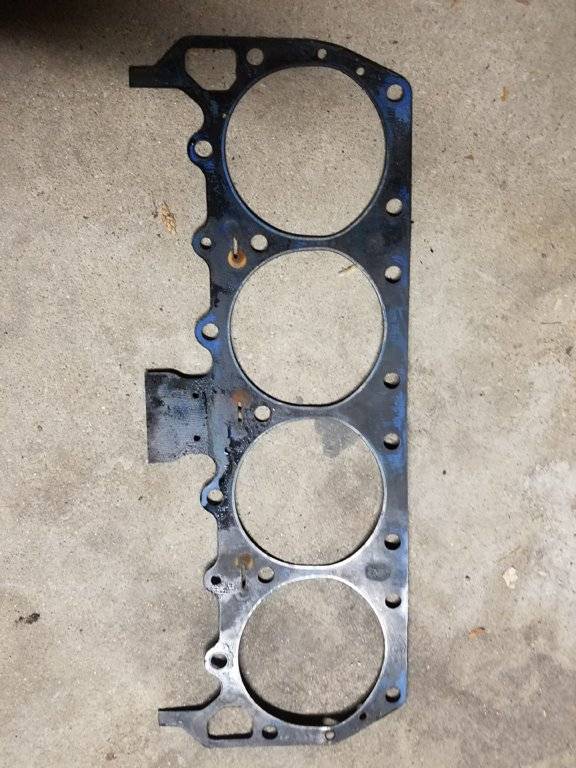

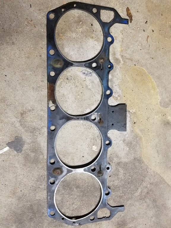

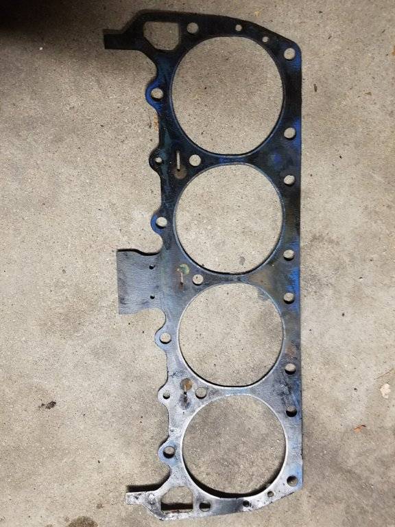

Stubs it doesn't look like blown apart but does have some heated brown bubbles tho. Also when I removed the gasket I saw some brown sludge in perfect diameter on the head gasket area that looked just like the antifreeze
For the nipple go easy on the torch. A little heat would help on the casting, but a small pipe wrench (think plumber) may break it loose. If that doesn’t then add a little heat but not red hot.
Put something across the slots on the top of the nipple. Usually.a really large washer works as.long as it goes down in the slots then turn with large channel locks or vise grips, heat helps a lot. If the nipple is in good shape you can just leave it and turn bolt out behind it and it will push housing away from block, and it goes in first as you put it back on.
Cylinder #2 gasket is failed at bolt hole between two center cylinders, toward the fire ring. Those are not original head gaskets.
