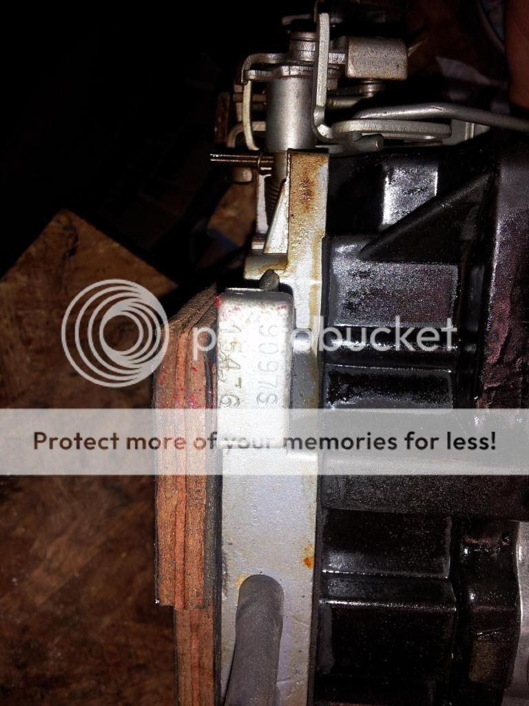

Got to talk to Mike (Newp) over the phone tonight. Thank you again Mike for the great adive! Really appreciate it! We talked a bit about the thermoquad. Deff gonna keep it, just need to decide if I'm going to stick with the one that came with the engine, or get another one. Here is the numbers that are on it Mike.
9097s. After looking up the numbers, seems to have come from a '76 318/400/440. Not sure yet on rebuilding this one. May try to get an earlier one.. What do you guys think?
It's one of the best ones. Go with it.

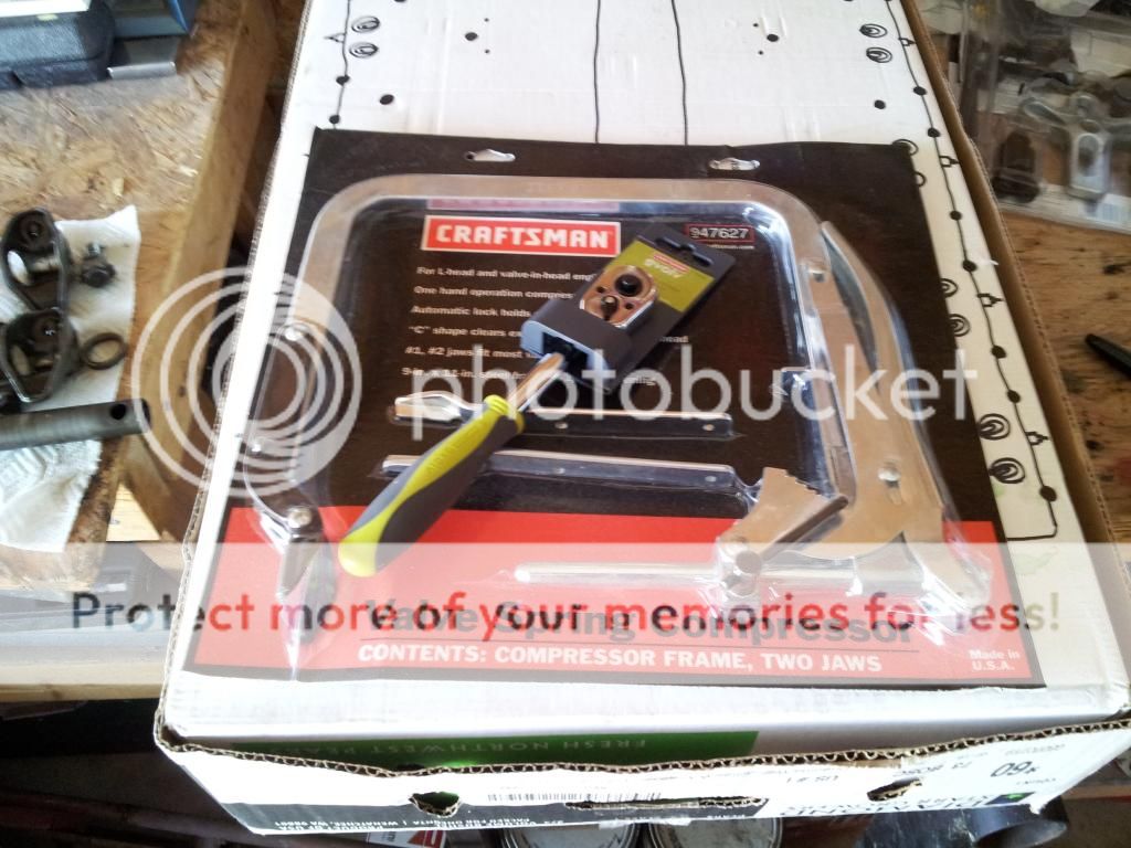

Picked up a valve spring compressor today.

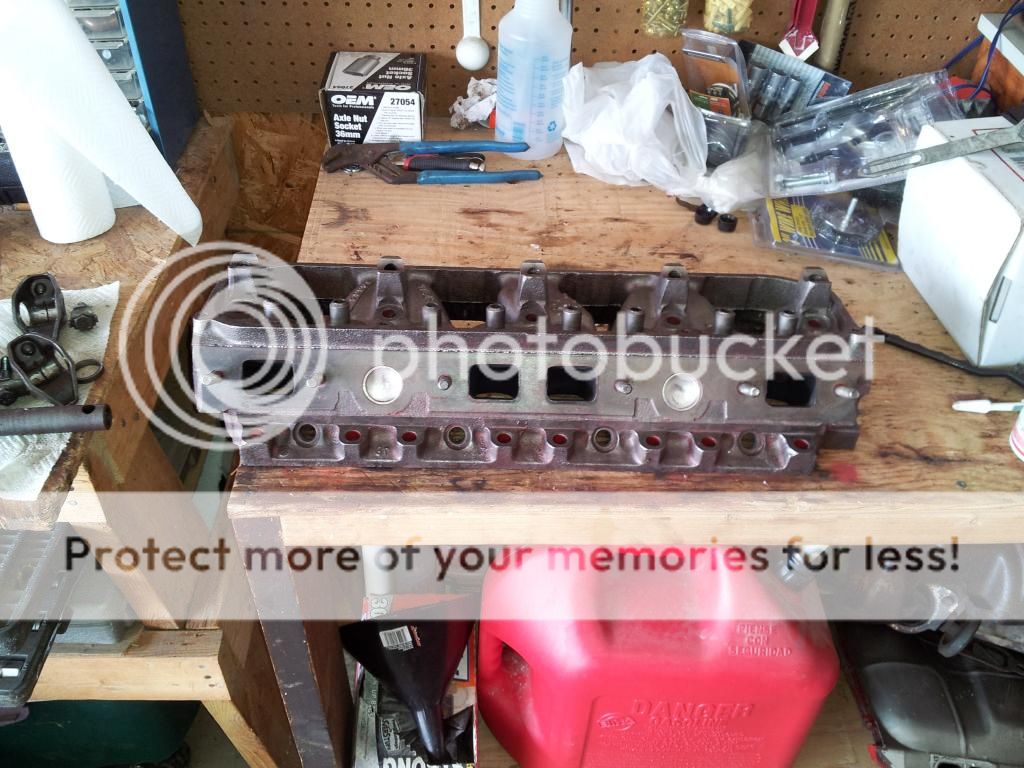

Had a little free time this afternoon, so took the right side head off. Got an empty box, and made out a template to store the parts in. Granted most of this stuff is getting replaced, still wanna keep it in order for the time being. Bolts will probably be reused.

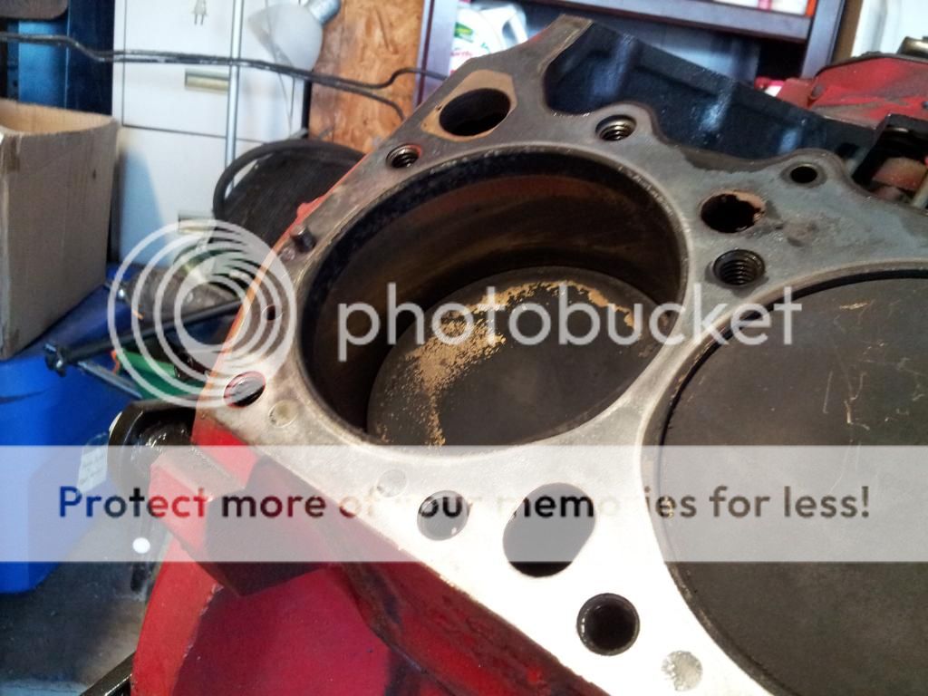

The inside-

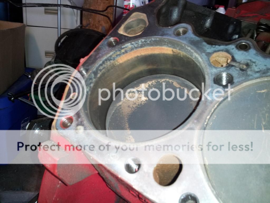

The outer 2 cylinders have a little surface rust towards the top

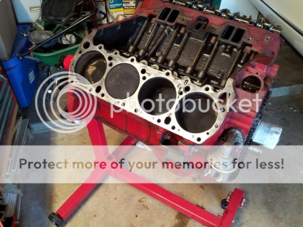

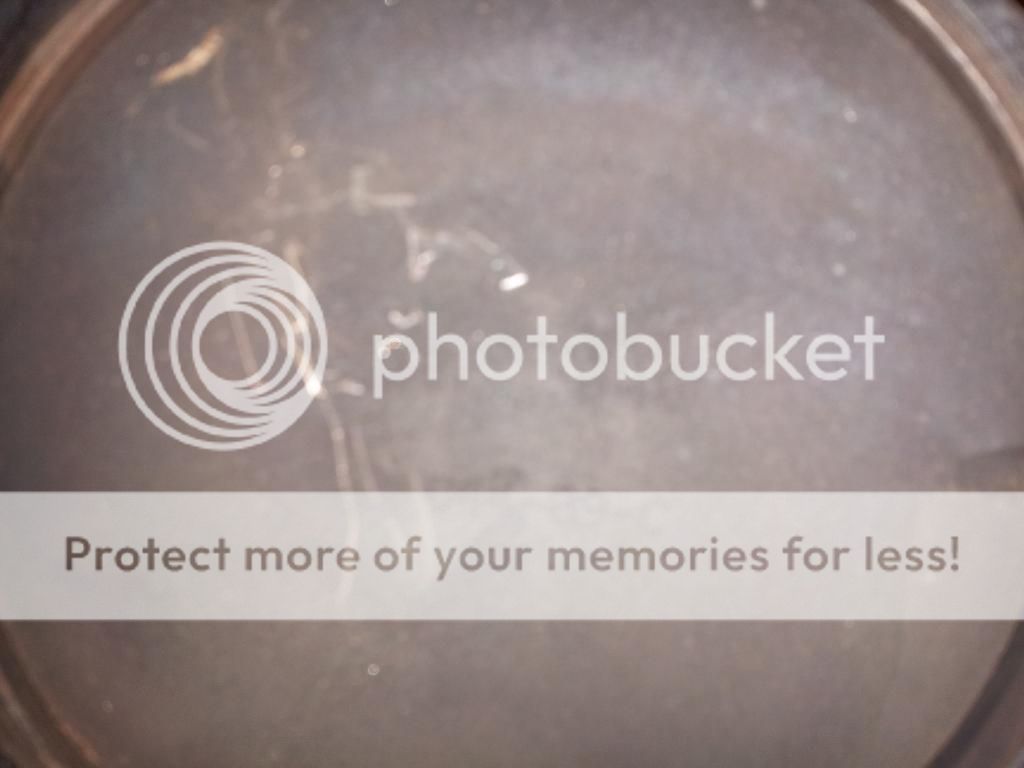

The numbers on the top of the pistons read-
350P-.040
03-044-89-C
the part number I have on the receipt that Ross emailed me is-MR-SPP350P40
Are these .040 over pistons? Wondering if it was a .040 over bore instead of a .030... Also I assume it has an 89cc chamber.
Also did a little more looking into the thermoquad. The primary butterflies are stamped with 2-314 making it an 850cfm carb. Looking good. Thanks stan, I do believe I will stick with this one. I'll get to rebuilding it once the engine is back together.
Yeah those would be .040 over bore.
Thanks Matt, thats what I figured. Just like to get a 2nd opinion. Im wondering how far i sjould tear this motor apart... You think these cylinders are alright to go, or should I hone em out?

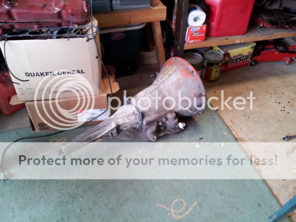

Got a call from a buddy. the trans was finished. Went and bailed it out. All rebuilt, new gaskets, as well as a shift improver kit.

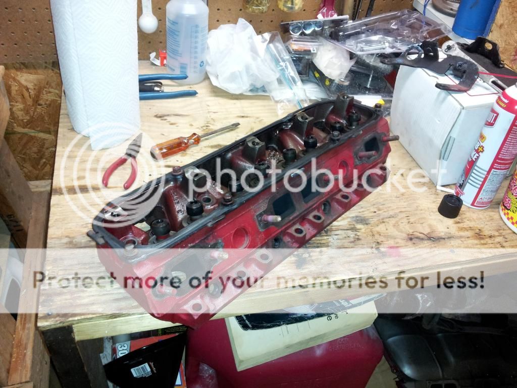

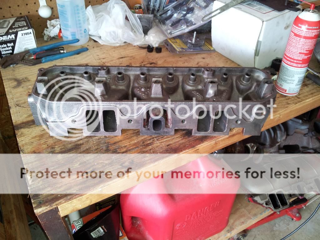

I did have one WTF moment with it, just like the other books I have.. When cleaning/going through the heads, it says to take a wire brush mounted to a drill to the combustion chamber, to clean them out. I was a little affraid of scratching/gouging something wrong... But I think I've got it good.
After a can of carb cleaner, and a couple wire brushes, the right side head is all cleaned up. Also everything seems to check out to be good to re-use, after going over what is mentioned in the book. So Hopefully she will be back on the block soon.
What I started with
Afterwards
Still a couple small spots to go over, but looking good. All the ports, and water passages look pretty clean, so I don't think they are gonna need a run to the hot tank. But we'll see what happens with the left head..
