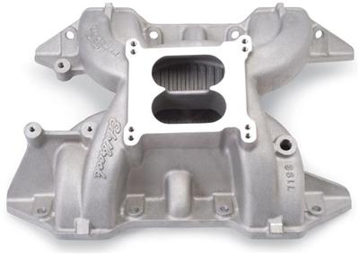

Seems like I'm stuck with the factory intake. Not that I'm complaining. I do have the original one to use which=no $$ to spend! Do you know of any low profile intakes that I would notice any gains from?
Eddie lo-riser dual plane Performer and that's about it.
Don't say "stuck". Sandblast and paint it with "Cast Aluminum (not reg, "Aluminum") Hi-temp paint. It will look like a cool aftermarket.

Thanks stan. It will probably get cleaned and repainted. Regardless of its the stock one, or an aftermarket, it will be getting painted engine color though! lol. I like the aluminim look and all, but prefer the blue. I was just looking for any performance gains.
Chrysler 413-440 V8
PERFORMER RPM 440 (1500-6500 rpm)
Designed for 413-426-440 c.i.d. Chrysler V8s. Dual-plane design results in excellent low-rpm torque and outstanding high-rpm hp. For high-performance street/strip applications. Will not fit 1962-64 Max Wedge heads.
http://www.summitracing.com/parts/edl-7193?seid=srese1&gclid=COCHm5iQ9bYCFchM4AodKwMA_Q

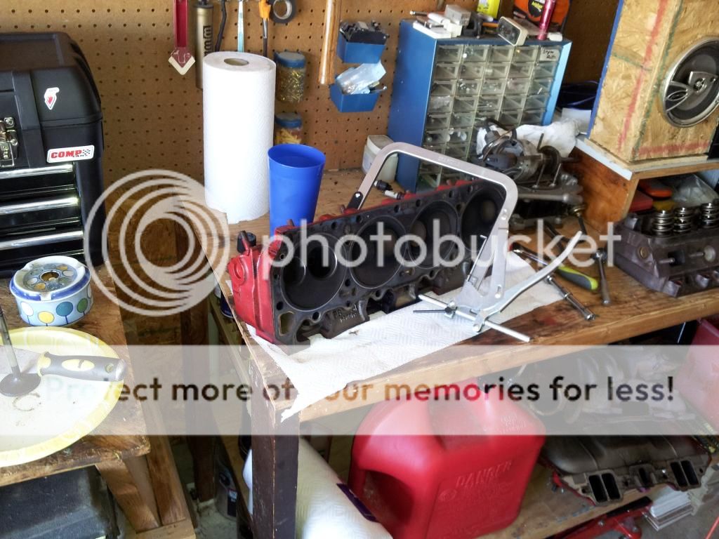

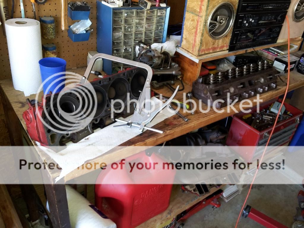

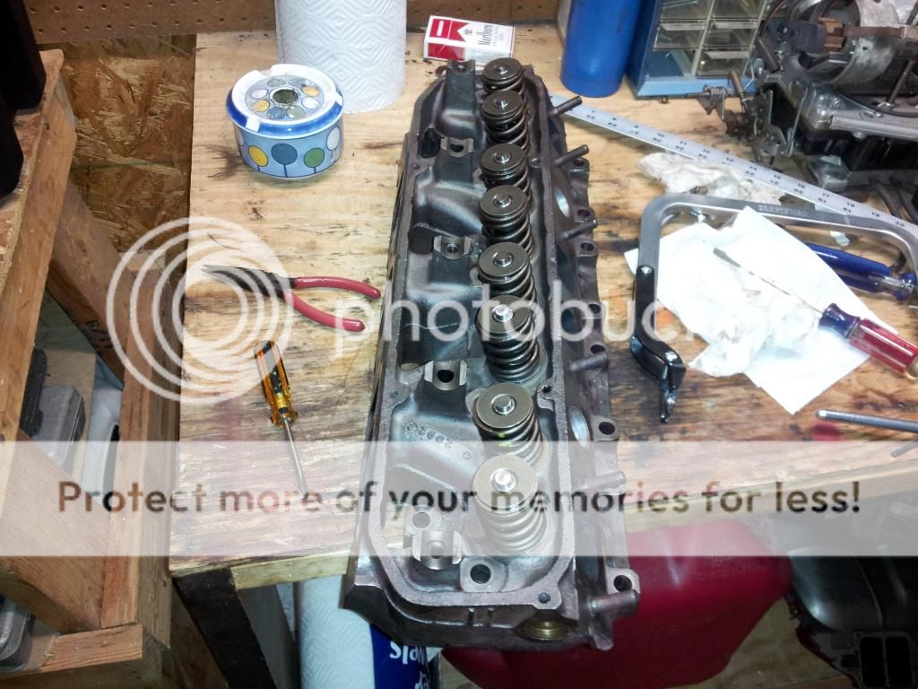

Everything looks good on the passenger head, and since I dont have as much $$ to play with as I was hoping, gonna stay with the current heads. Installed new valve stem seals, along with the new springs. Driver side soon to come...

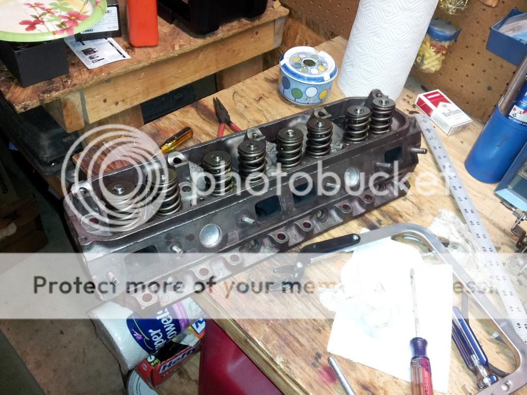

Ran into a road block with the driver side head...
Pulled it off, and was going through it, but the valves wernt looking to hot. Sooo Reassembled it, then took the new stuff off the passenger head, reinstalled the old stuff, and dropped them, and the new parts off at a local machine shop. They will be disassembled, hot tanked, magnufluxed, and get a valve job. Should have them back in a few days hopefully.

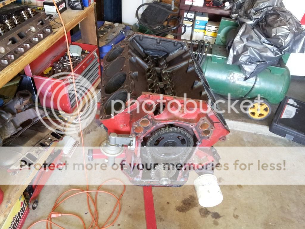

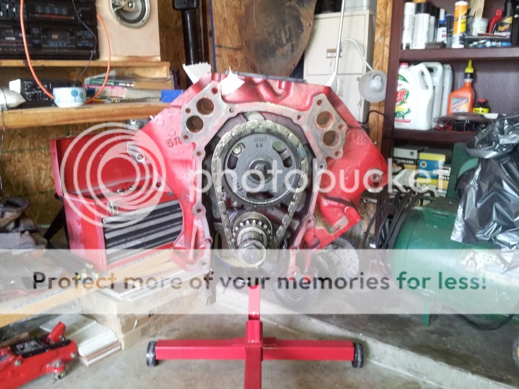

Other then that been tearing more stuff of the engine. Everything else is looking good. Just need to get the block cleaned up, and ready for paint, and start installing the new parts.

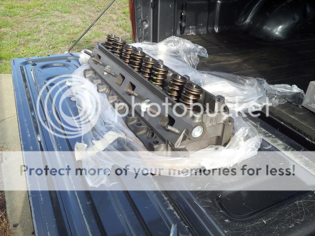

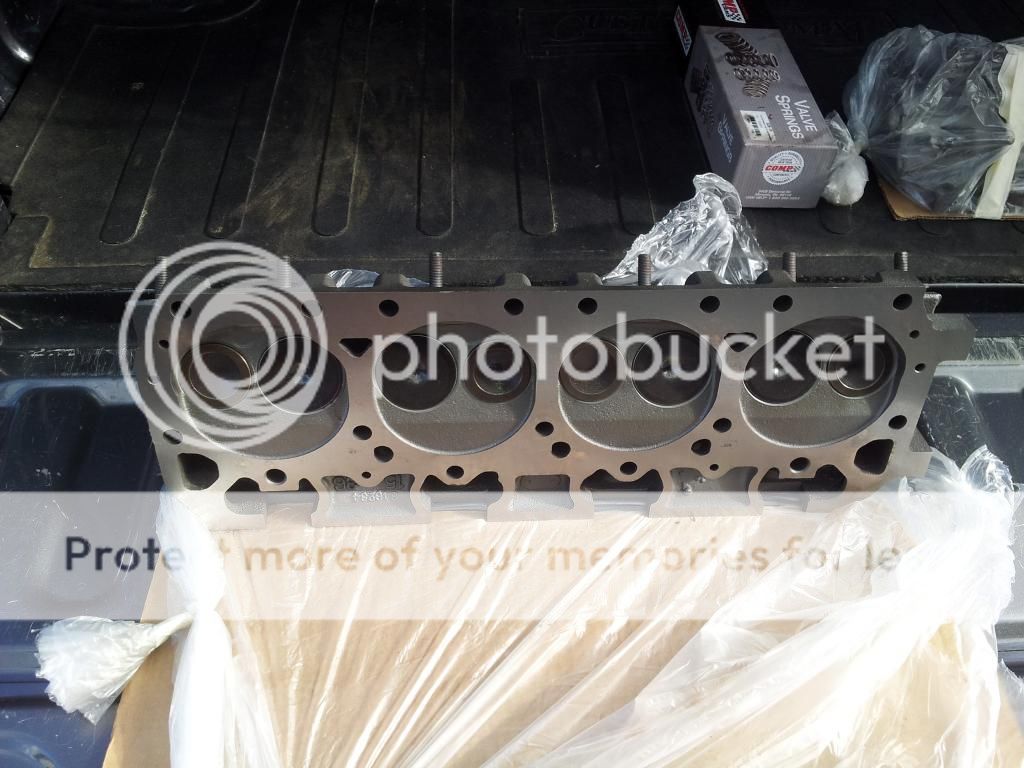

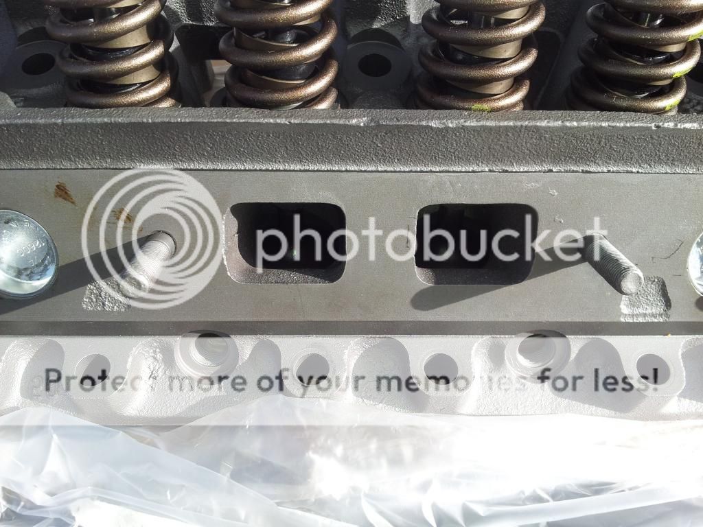

The heads came home today. Not for $125 though lol. You guys had it right. Spent $377 total on em. The guy said they were in really good shape, but did need a little work. They got all new exhaust valve guides, a resurface, and new freeze plugs, along with the other work mentioned above. He also mentioned, they have only been surfaced a total of just under .020 since new.
Had to unwrap one to check em out.. They do look good!

With every 0.010" shave from deck side of the head you should shave 0.0123" from intake manifold side of the same head.
That's why I hate shaving heads. Pile on the head gaskets till you make up for the .020 shave.

In MY book, one or the other must be done.
Also, in my book... just get a thicker head gasket....
That .020 head shave will give you less than a 0.4 raise in compression. It's so little, I wouldn't be concerned about the loss or gain in C.R.
