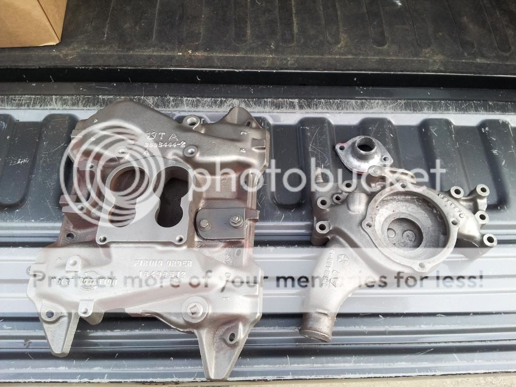

Nothing going on here. Dropped the intake, water pump housing, and t-stat housing off for cleaning. Still need a little more before paint..

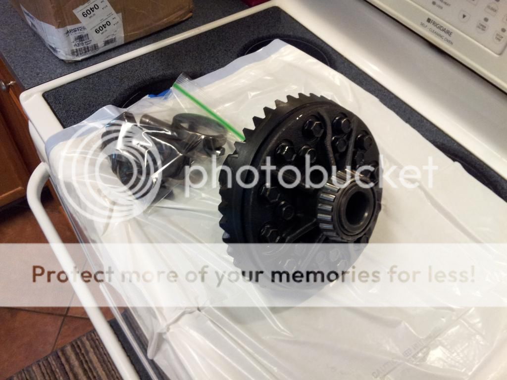

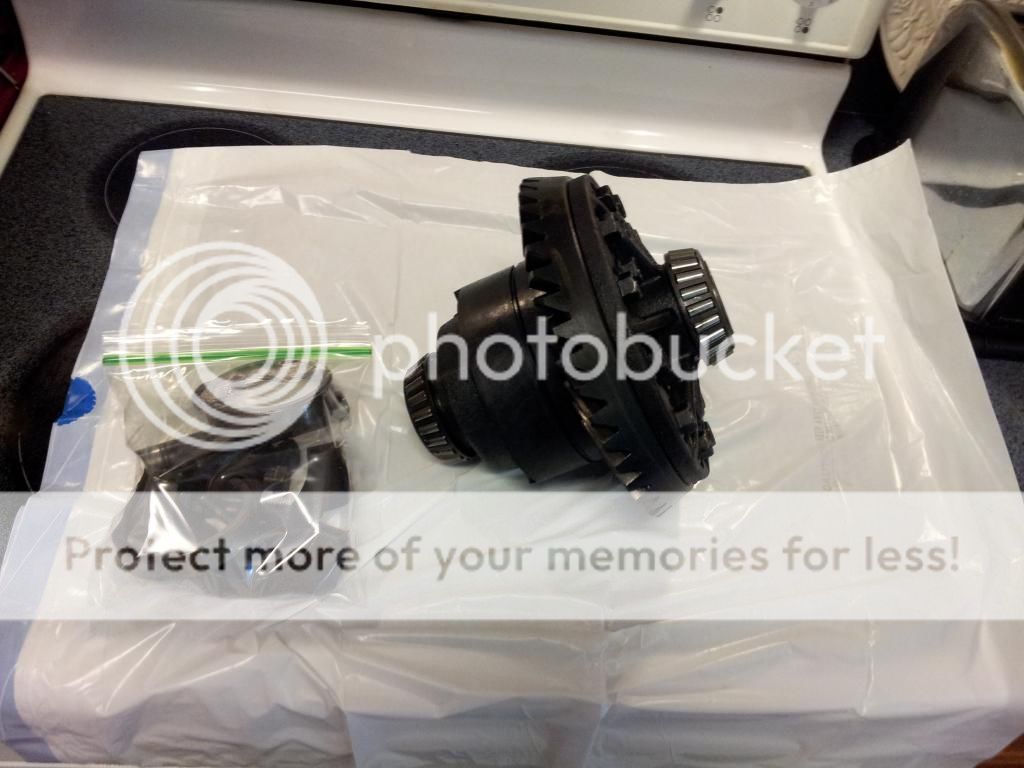

Did some horse trading with a friend on the blumo board. Now have a suregrip unit on its way for the 9.25. Also might have some fury parts sold to a gentleman in canada, along with my spare fender to a local buddy. Should have a few bucks to play with once their gone.
The suregrip showed up a few days ago. Need to pull it apart, and go through it.

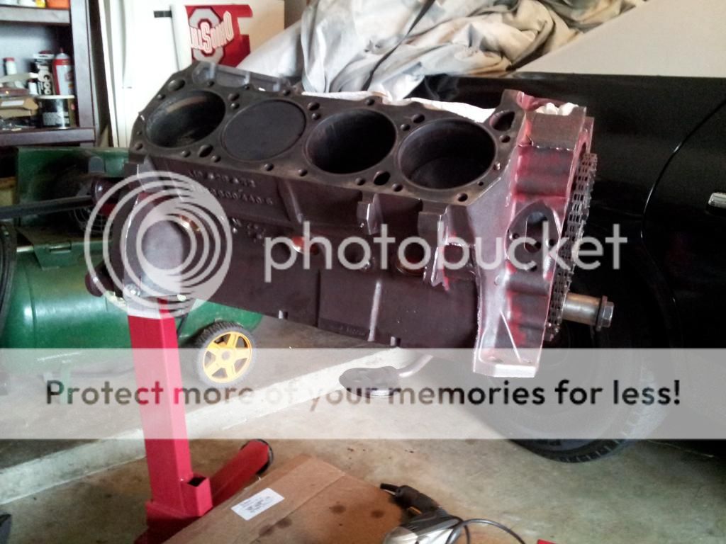

Started cleaning the block. Everythings looking pretty good.

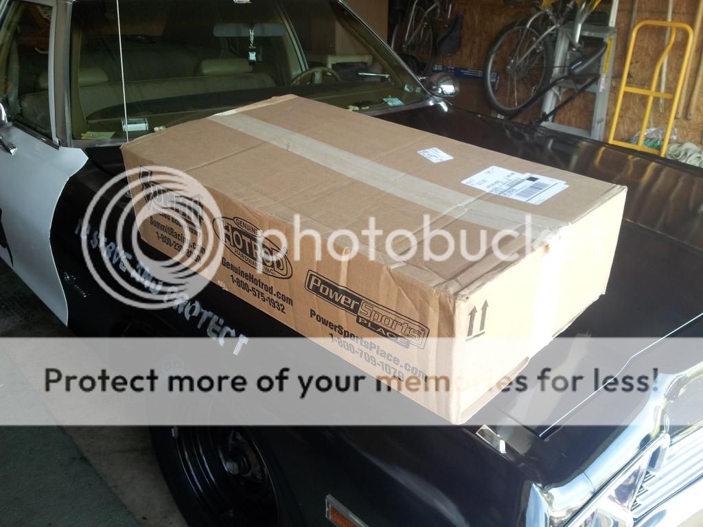

The brown truck also dropped off a few parts. I love it when these show up!! X-mas all over again!

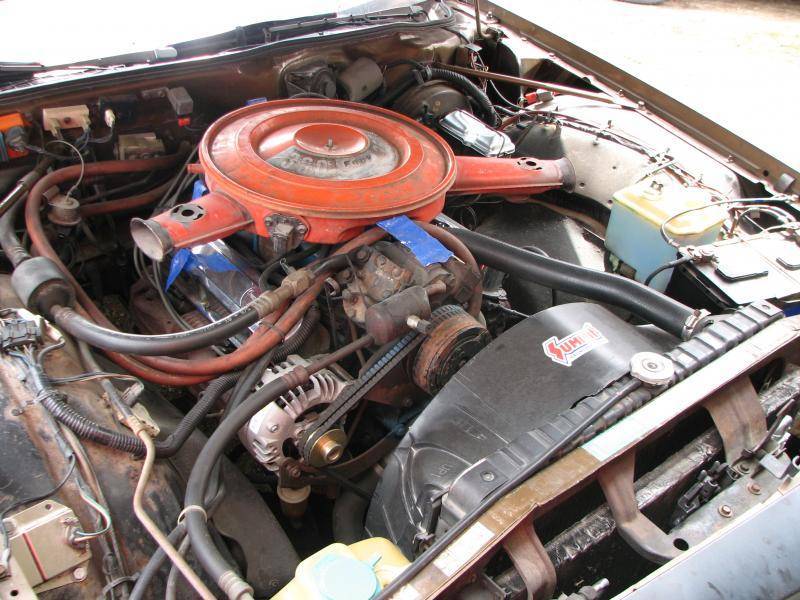

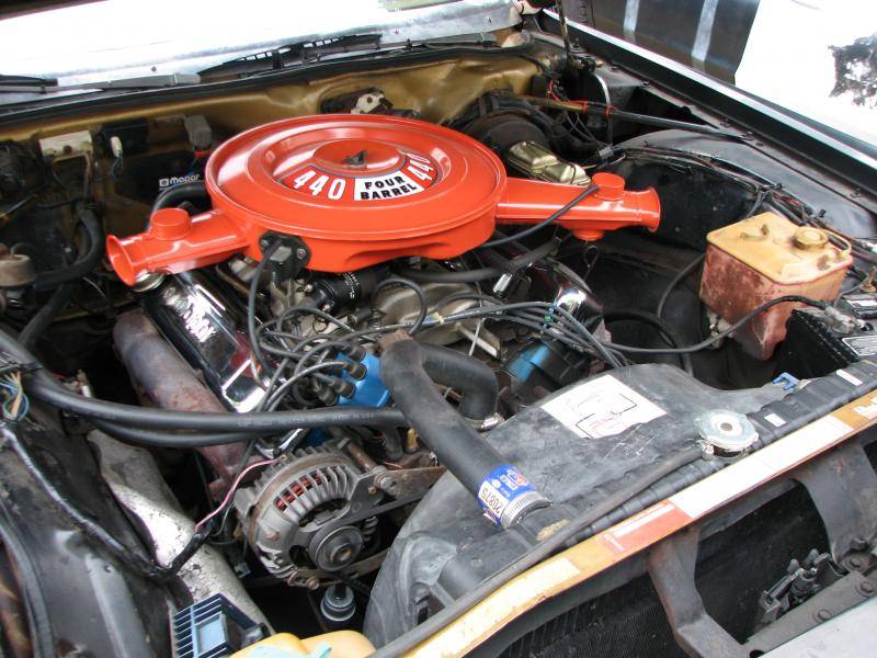

Yea, I'm not %100 sure either Mr C. But, it looks like they are different. Heres is a very old pic of my 360, and a pic of a friends 440 car. The shroud looks wider then mine. Also looks shorter, or doesnt mount as high..
They may have different P/N's but that doesn't mean crap on these cars many times.
They probably interchange perfectly. Chrysler was too broke at this point to mold up for yet another fan shroud let alone the money they had to steal just to print up new decals and enter it into "the system"...
