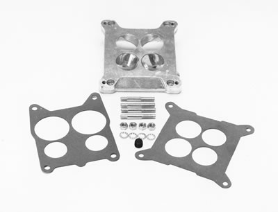

First, you must have an Edelbrock PN# 1481 adapter bracket. $10 from Summit or Jeg's.
Yes, it's an eddie performer intake. Everything lined up with a few accessory parts.

I personally called the eddie tech's and found out what the real deal is with mounting carbs to manifolds and what adapter is required for proper installation and performance.
If you're using an eddie performer carb and manifold you'll need an eddie 1/16" carb mount adapter PN# 2732. It came in box with my intake.
If you mount an eddie carb to a stock Mopar cast iron manifold you need eddie adapter PN# 2696 to mount the eddie square bore carb to the Mopar spreadbore manifold. About $27 from Summit or Jeg's.
And to hook up the cruise control cable you'll need eddie PN#8009. It's a universal Chevy part but Eddie sent it to me for free. It's $10 from Summit or Jeg's.
I put a Eddie PN# 4224 air cleaner 14"x3" on her. It was $78 and fit with plenty of hood clearance.

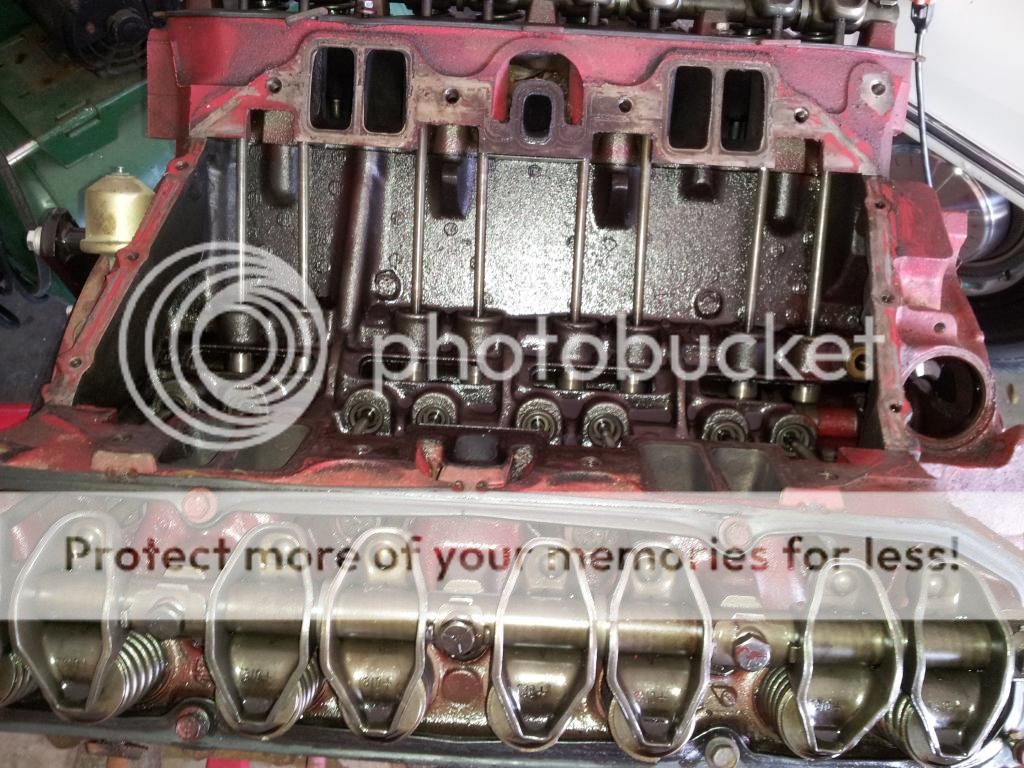

Been kind of a productive day.. Dissasembled more of the top end.
Also got some good, and bad news today. I have the receipt of the engine rebuild that Ross emailed to me. I called them today, and got to talk with the man who rebuilt the engine. He knew right away what engine when I mentioned the car. He got a laugh out of how the car went up north to OH, and I had to go up, grab the engine, and bring it back down to FL lol. (the car was from/worked on here in FL)

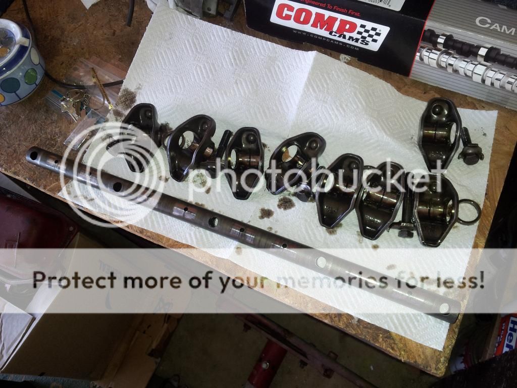

Anywhase he explained how the engine was rebuilt back to stock specs, and what not. Also that it is a very good engine... However the valvetrain is going to need to be gone threw. The man who owned it before Ross had the engine rebuilt, everything except the valvetrain mostly. He said the rocker shafts, rocker arms, and pushrods are going to need to be replaced. They were showing wear when he had the engine, but the guy was running out of $$ and said to do it another day. Well that was 8 years ago, so who knows. I'm gonna go back out to the garage, and start tearing them apart.
You guys have any preference on these parts? On the cheap side?? lol Going to keep everything stock, so no adjustable stuff.. (hopefully)
Pulled the right side rockers. Deff shows some wear as norb (engine builder) mentioned. Can feel the grooves gliding my fingers over them.
Since I'm gonna have to spend some money on these heads, do you guys think I should keep them? They are the "346" heads. Accourding to the receipts I have, they have been resurfaced, valve job, new guides, and new springs. I'll probably stick with em for the budget, but...... lol. What would you guys do?
