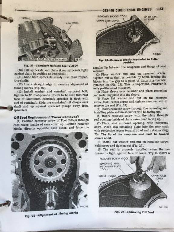

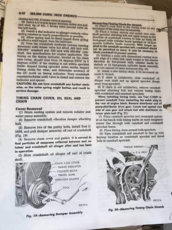

Remember your FSM (factory service manual)has a very detailed description on how to install the timing set. I have found that to be one of the best how to tutorials. Some of the tools that are mentioned may need to be improvised.

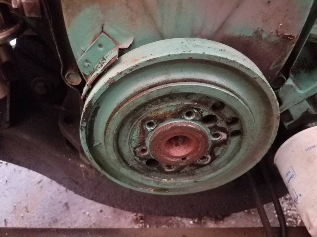

Tip: use the puller that pulls via the bolt holes like in FSM.
Don't use the jaw type puller that pulls on the outside.
I was doing some research and I see you want to line "0" on the top gear aligned with 0 on the bottom(gear) then the key slide area should be 0 also. Then apply chain lube rotate the motor till your back at TDC but make sure your aligned again at the bottom 0,0,0 then tighten down the gear? Sound pretty close ?
The keyway will not be at 0 or lined up. A multiple keyway crank sprocket use the o or do, the A,R, triangle or square is to advance or retard cam timing. You do not need to worry about.

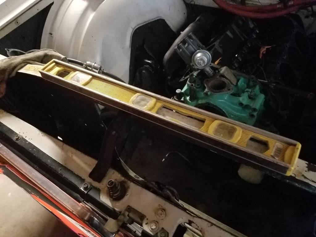

Ok so went to check the block and I was able to freely pass a .003 feeler gage under my straight edge. As you can see the cylinder was clean. So I went a little further and in some areas was able to even go as high as 0.008 be easily 0.007. I do remember the owner before me said it really would over heat in the summer.
Ummm, most likely, yes. Just for kix, if that's what you used, flip it over and measure again against the other side......
I was at man when I put the straight edge over and tried I couldn't pass of .003 so thanks a lot
