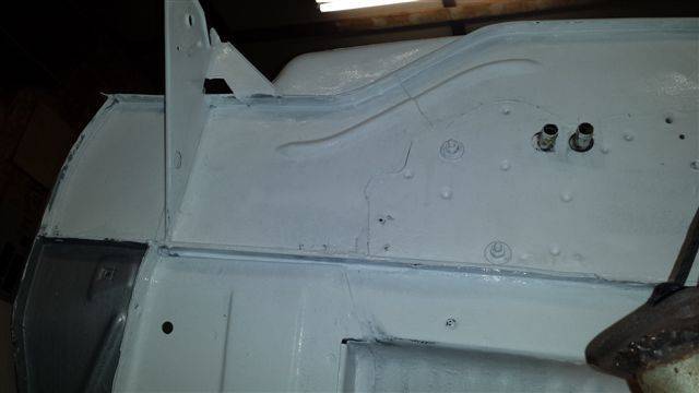

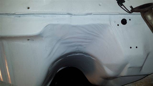

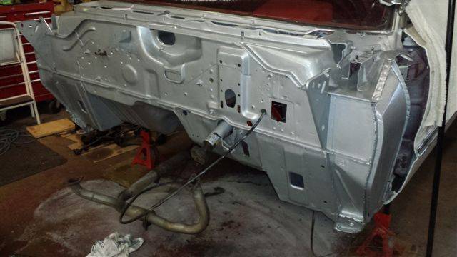

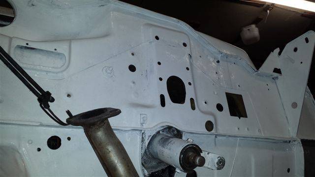

So here is an update on the firewall. the white didn't lay down very well as I had hoped with a lot of bleed through.
I have sanded a lot to smooth it out.
Not sure what to do next, leave it in a scuffed up state or to try again with a different paint or sanded some more and leave it in the base silver.
The scuffed up state gives it a certain patina look which would suit the car.
The silver base give it an aluminum clean look.
The white was a bit too shiny for my taste given I am not restoring the entire car and the white is a bit of an off gloss white.
The white paint turned out to be an RV white.
Have a look and comment if you wish.
here is the base silver which hides a number of sins in the firewall as well.
the white seems to draw attention to the flaws..
I would shoot it with another coat or two of the white(if that's going to be your body color).White is hard to cover a darker base unless you've used a sealer or a light colored primer.
Definitely shoot another coat of white until it's properly sealed. Don't worry about some orange peel...the factory never did. As for the paint appearing too shiny, don't worry- it's under the hood it will be dusty/grimy soon enough.
Once you have all the accessories and motor back in place etc, most of the flaws will be covered up and having the firewall white is going to look much better and original on a white car.
I agree. I sanded a bit more then left it for the night.

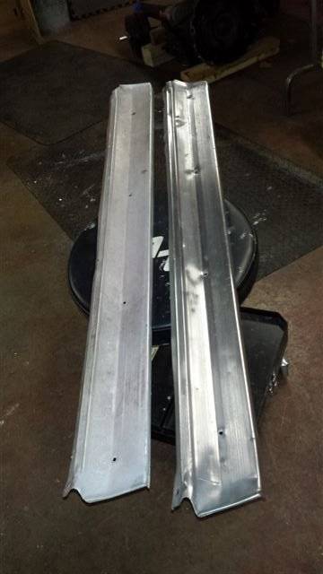

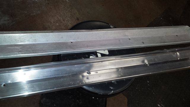

I decided to polish one of the door sill trims instead.
The had a nice blue hue to them from a previous paint job. - I hate when people don't take the time to REMOVE TRIM!!!!:soapbox::soapbox::soapbox:
They are a bit rough but certainly look much better polished..
I did one and had the other to do yet.
Looks good. I polished up mine and shot it with clear and a hardener. Time will tell if that was the right move. I figure it can be reversed if needed in the future.

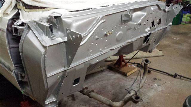

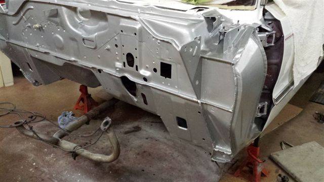

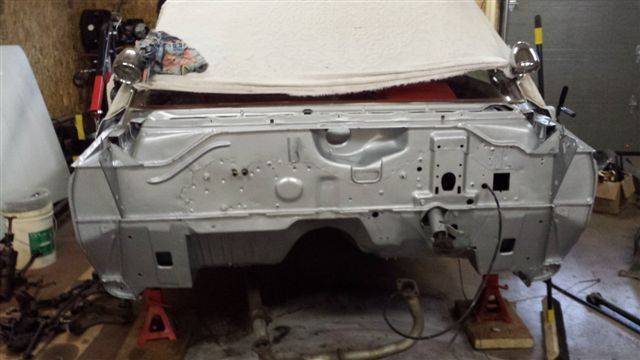

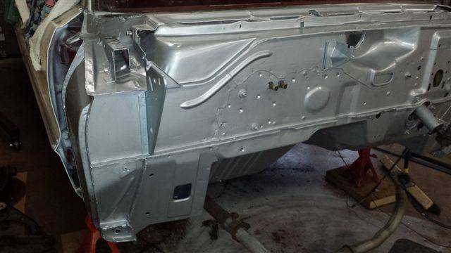

I decided after thinking about trying to match the paint closer to the outer colour with reservations to sand the firewall and repaint it in the metallic silver. see repeated photos and decide for yourself
No supplier of paint would give me straight answers as to how close they could get it.
I think the silver is going to give the under the hood a fresh look as well
If I decide to paint the car silver then I'm all set!:yaayy: I doubt that though.. I like the white and red combo too much.

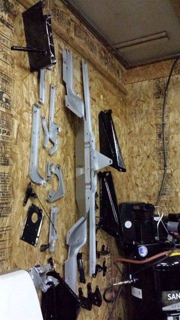

I also have hung all the painted ready to go parts on an empty wall in the garage to free up space on the work benches.
Lots of parts on the way from Rock Auto, DelCity & Auto Zone as well as a few other sources.
Got to stay organized so it doesn't overwhelm me with parts all over the place when they arrive!
It looks outstanding (!!!) but you're doing such a fantastic job that I'd think it would be a detriment to pop the hood and find a different color under there.

Thanks Commando1(It's Stan right?) but I have to draw the line on the how much I spend on this driver.
Trust me it will look great when it is done!

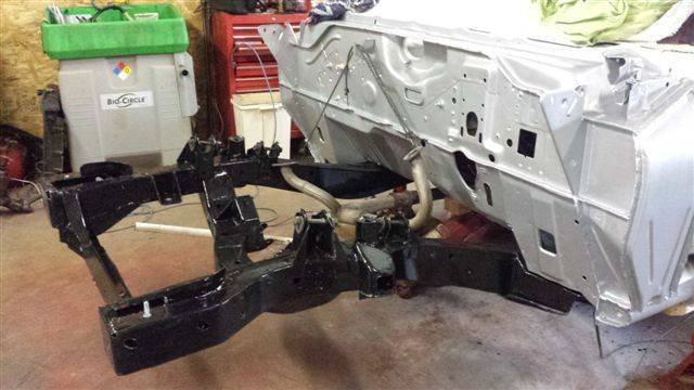

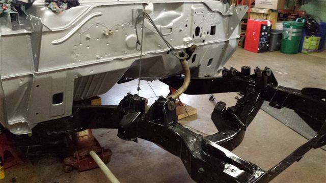

finally fitted the Stub frame yesterday. I have to still get a few bolts into place and line it up but it now looks like it should.
Freed up a good bit of space in the garage as well!
I'm no purest by any stretch but I'd side with Stan on this one, body color would look better. Or black. But, nice work none the less.
