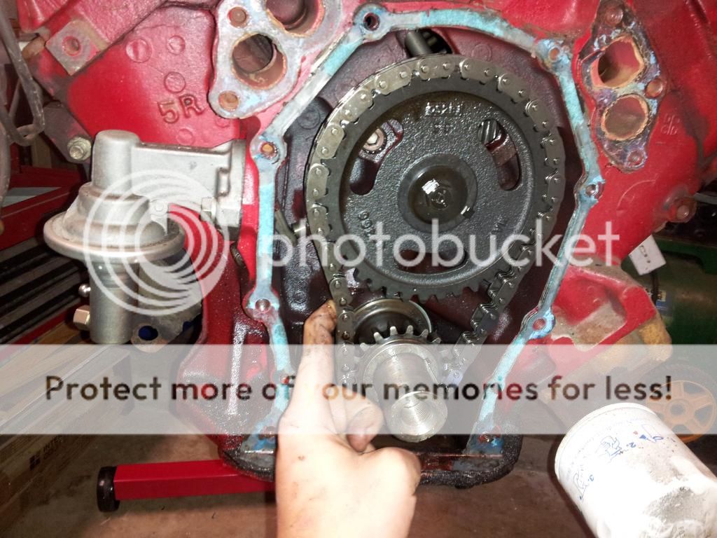

Got the engine to TDC on cyl #6. Pulled the valve covers, crank pulley, harmonic balencer, and timing cover. Looks nice and clean inside.
Timing chain has some play on the passenger side
Is that to much play? Looks normal from the sounds of it reading on other forums.. Think it would work good with the new cam? Or should I not be such a cheap *** and get a new one to be safe. Engine was rebuilt in '05 with not many miles since.
Yeah, exactly. Your in there.....not too hard to go the rest of the way so might as well avoid any worries now while its easy.
